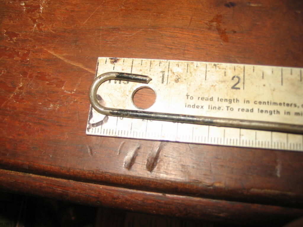

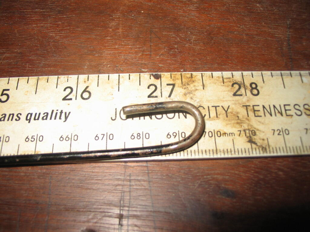

ebinmaine 80,929 #6 Posted February 24, 2023 16 minutes ago, CWyatt said: No, it’s a solid rod bent on each end Can you please post pics of what you have? With measurements? Share this post Link to post Share on other sites
daveoman1966 3,884 #7 Posted February 24, 2023 This is the upper index rod 104341. Buy a 30-36" length of 1/8" dia STEEL ROD from a local hardware or Home depot..Lowes...ValuHome. I've tried using a coat hanger but it is just not rigid enough. The rod might cost you $4. Bend it like this... 4 1 Share this post Link to post Share on other sites
