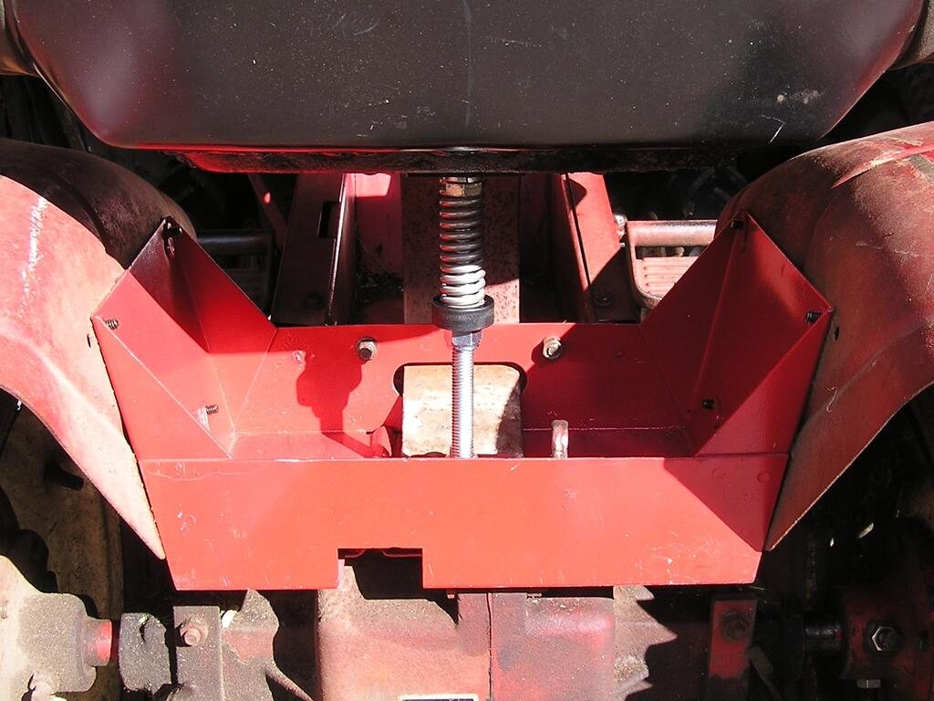

ri702bill 13,271 #5 Posted February 22, 2023 (edited) 10 hours ago, Pullstart said: The difference is the brake set mainly, but a 6 speed would fit better than an 8. I’ve stuck an 8 in my 502, and it is just perfect shy of a parking brake still. Yup, I agree with Kevin - there is less work required to install the 6 speed, and you will probably need to ditch the parking brake (but 1st gear in Lo range is almost as good !) I did an 8 speed swap on my 854, using a low hour trans from a C81. The 4 bolt pattern to attach the trans to the "F" plate is the same. The input shaft diameter is not - 4 speed is 3/4" (the 6 speed is also) the 8 speed is 5/8". Had to buy a brake rod from a Raider (!!) to get the proper pull on the brake band. (may not need this on a 6 speed) No parking brake mechanism. Had to change the input shaft pulley - the C81 style is way too large in diameter to fit under the 854 belt guard. Bought one close to the 4 speed diameter. That being said, the original 70" long belt was now too long - went with a 69" belt instead. You need to holesaw 2 holes in your sheetmetal - one in the hoodstand for the Hi-Lo lever (used as-is), and one hole on the bottom of the toolbox under the seat for the dipstick tube. Regular shift lever - I went with the 4 speed shifter (but later cut the top back about 1" for better knee clearance) The C series shifter is longer and has an extra bend in it. Dipstick tube - I needed to remove about 3-1/2" from both - the C81 had a flip-up seat, the 854 is fixed. (easiest way I found to get the "Full" mark right was to fill the installed trans with the original parts - verify it is full, cut the parts and reinstall. Remove the dipstick - the top of the oil is now you new full mark. Scribe or lightly file a line there.) Worth the effort - absolutely. Edited February 22, 2023 by ri702bill 2 Share this post Link to post Share on other sites

ri702bill 13,271 #8 Posted February 22, 2023 (edited) I like the idea of the hose clamp. I do something slightly different. I cut a circle of rubber from an old inner tube with a 1/2" hole in the middle, remove the knob, slide the rubber halfway down, reinstall the knob. Time for the Lucas grease - a heavy layer of grease placed on the shifter ball in the trans, push the rubber down onto the grease, install the boot. An added layer of protection to keep water out.... Edited February 22, 2023 by ri702bill 1 2 Share this post Link to post Share on other sites

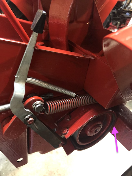

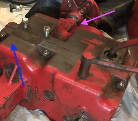

Handy Don 17,634 #18 Posted February 23, 2023 (edited) On 2/22/2023 at 5:57 PM, Matt Foss said: So the transmission I am looking at is from a Raider 10. It has 1, 2, 3, R w/ Hi and Lo. Would this be considered an 8-speed or 6? differentiators for transaxles having high/low shifter - no dipstick hole on the top of the transaxle (blue arrow) ==> 6-speed (one late model 6-speed did have a dipstick hole) - brake drum very close to rear axle (pink arrow) ==> 6-speed - oil fill extension at lower left rear of transaxle Personally, i like having the parking brake and it isn’t hard to have it once the brake linkage is in place using the 6-speed box. It is tricky if putting in the 8-speed. This image shows the parking brake and the close clearance of the brake drum & rear axle housing for the 6-speed box mounted in my 854. The silver parking brake release spring is my own addition since the tractor came to me without one--I’m not sure where it was originally (and yes, one end of the spring is hooked into the brake/clutch spring). Oil fill extension (parts 71 & 72) Edited March 7, 2023 by Handy Don Share this post Link to post Share on other sites
