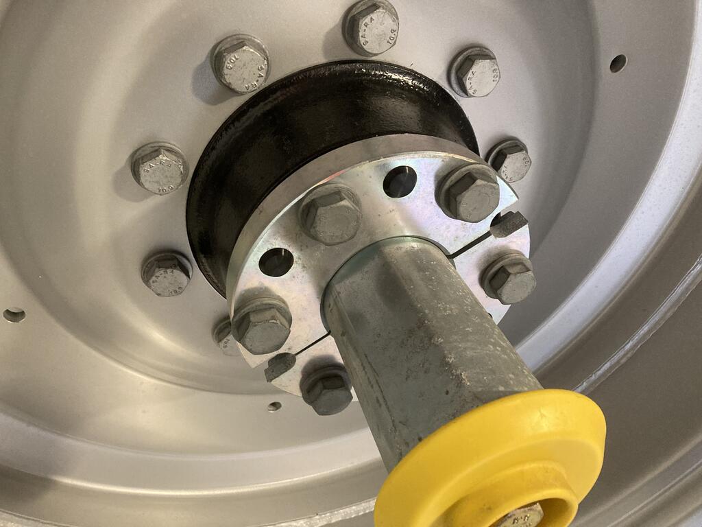

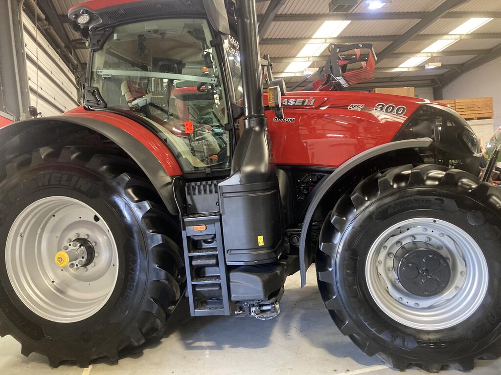

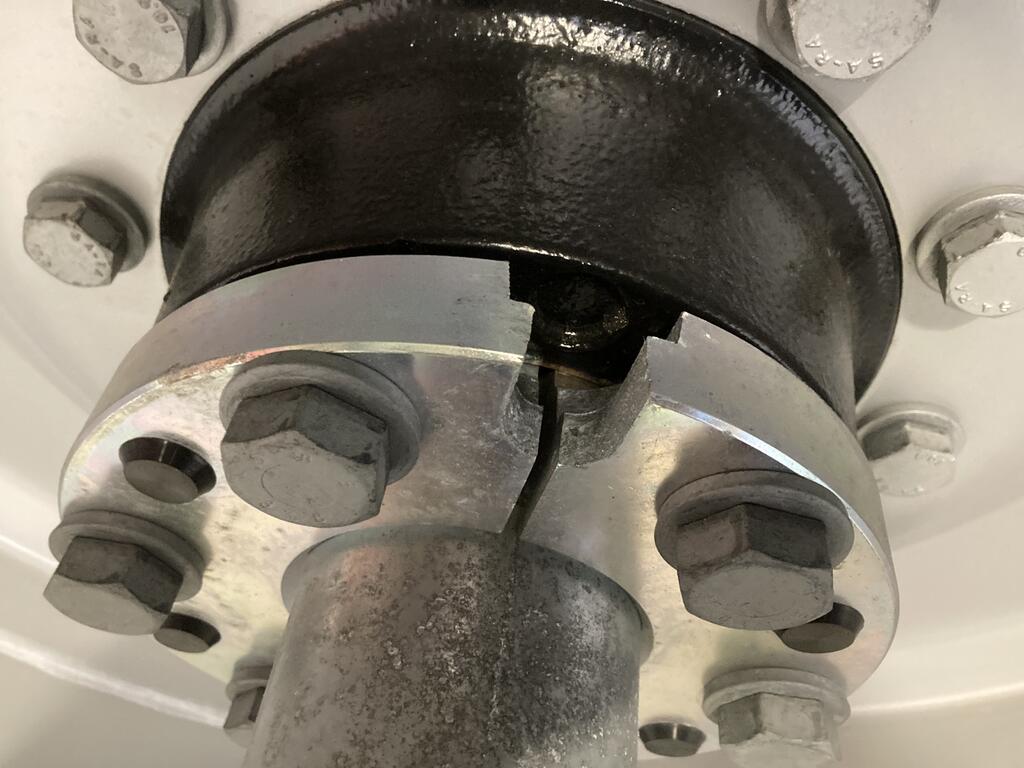

ranger 1,840 #11 Posted February 22, 2023 16 hours ago, ebinmaine said: I'll trade you some carb rebuilding skills for some hub groove cutting skills. Who needs grooves in the hubs if you had hubs like these. Saw this at the local agricultural dealer’s open day, last week, free entry,🍺 and hog roast as well!🐷👍. The tractor’s even the right colour! 1 Share this post Link to post Share on other sites
ebinmaine 77,335 #12 Posted February 22, 2023 8 minutes ago, ranger said: if you had hubs like these Niiiiice. We can get something similar from Lincoln at A to Z Tractor. Share this post Link to post Share on other sites
ranger 1,840 #13 Posted February 22, 2023 The threaded holes under the black plastic plugs accept bolts, which when tightened, break the taper allowing the hub to be adjusted in or out. 1 Share this post Link to post Share on other sites
