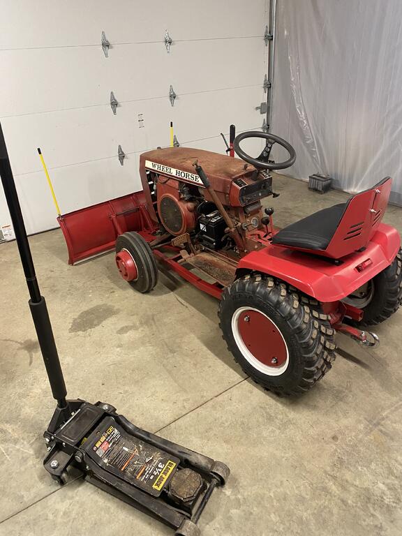

tallen4392 71 #1 Posted February 21, 2023 does anyone use ag tires on there machine all year around to cut the grass and push the snow without damaging the lawn ?? i have them on my charger for snow removal work good for that 3 Share this post Link to post Share on other sites

tallen4392 71 #12 Posted February 22, 2023 Thanks for the tips i have a charger 12 for snow plowing with ag tires and lots of weight work great never a issue and my driveway is on a good hill i picked this machine up for my sons new house wanted a tire for year round to mow and move snow .. Share this post Link to post Share on other sites

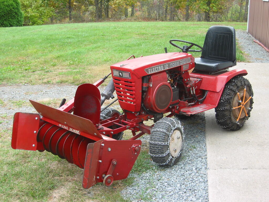

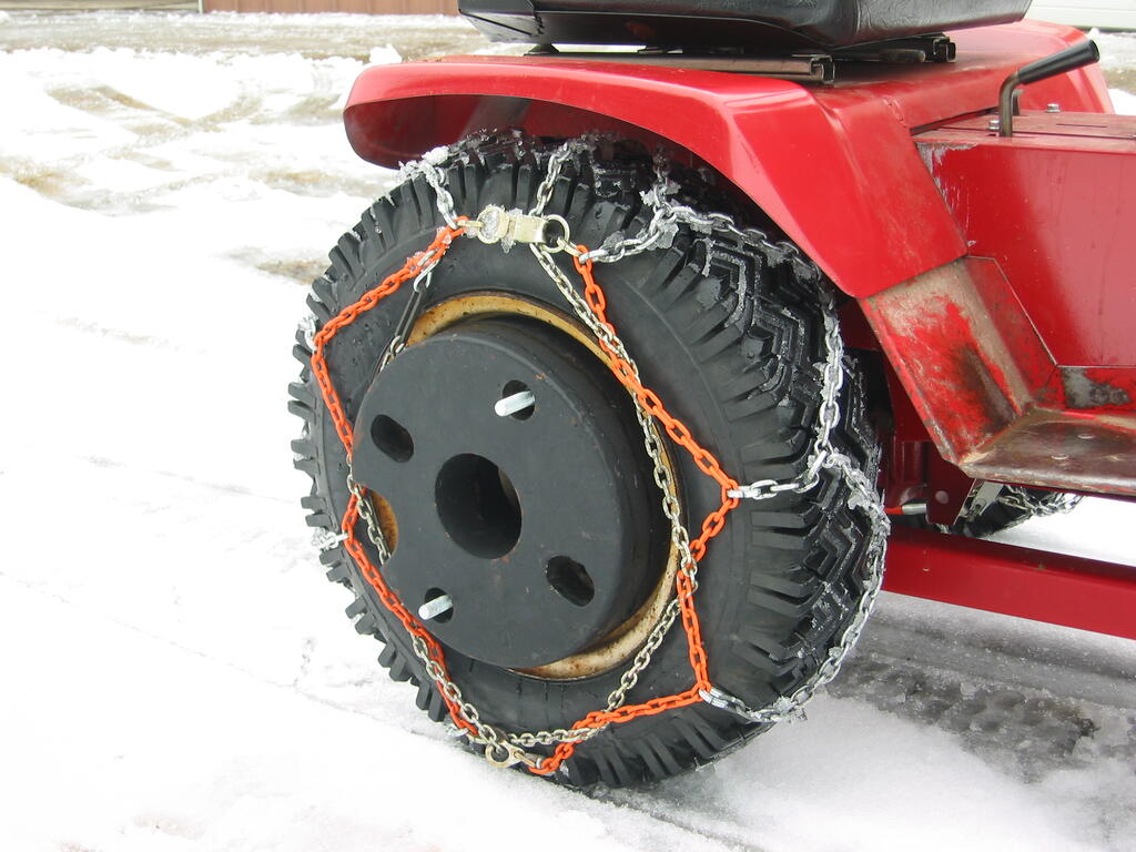

ri702bill 13,189 #13 Posted February 22, 2023 8 hours ago, Handy Don said: How many links are in the cross-links for well-fitting 2- and 4-link chains on the different tire sizes Don - I replaced all the cross links on the rear tires for the C81 - they were 4 link and I wanted more crosslinks. The old ones were vee bar, great grip on ice, but left gouges in the top surface of the driveway. Bought a 75 foot roll of 1/0 (as I recall) twisted link chain on the 'Bay. Also bought 100 new crosslink connectors. Both were slightly different than what I already had. The twisted links were slightly longer, maybe by an 1/8th of an inch each. The connectors at the end were also longer, by about 3/8ths - actlally ended up with one less crosslink. You can see the differences from both sets in my photo above. Bill Share this post Link to post Share on other sites
