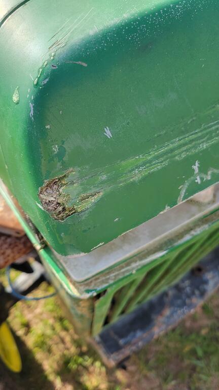

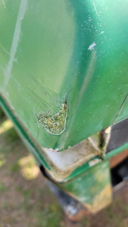

RED-Z06 2,718 #1 Posted February 21, 2023 This one is rough...got it cheap, engine is an 18hp Linamar so its much newer than the 1985 machine 5 Share this post Link to post Share on other sites

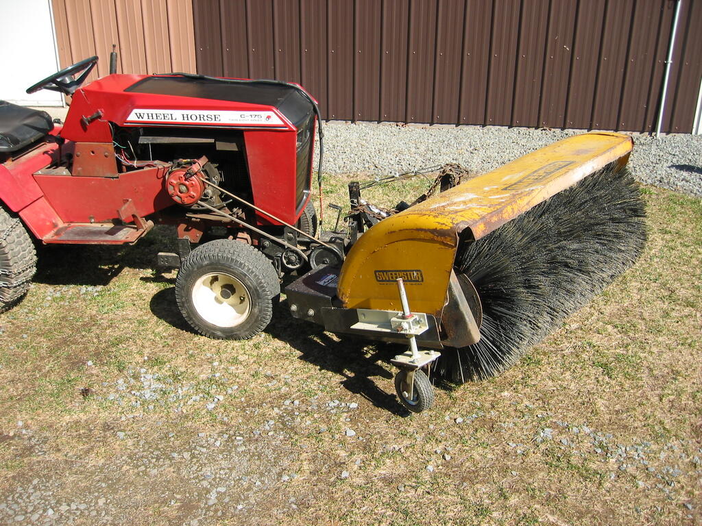

pfrederi 21,003 #8 Posted February 21, 2023 My brother bought a well used JD317 (KT17 series 1) many years ago (1984/5?). He used it for 10 years or so but the engine developed a bad leak on the crank seals (well over 2000 hours but hour meter had died...). He bought a replacement KT17 from Northern tool and it is still running today..hydro is noisy but works fine. The original engine sat in the attic of his barn for another 10 years or so until I retrieved it to repower a C-175 I got that had a ventilated block. Replaced the crank seals swapped out some external parts and it is still running. Does smoke for a few minutes on start up. Runs the sweepster... 4 1 Share this post Link to post Share on other sites

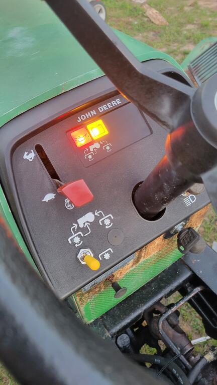

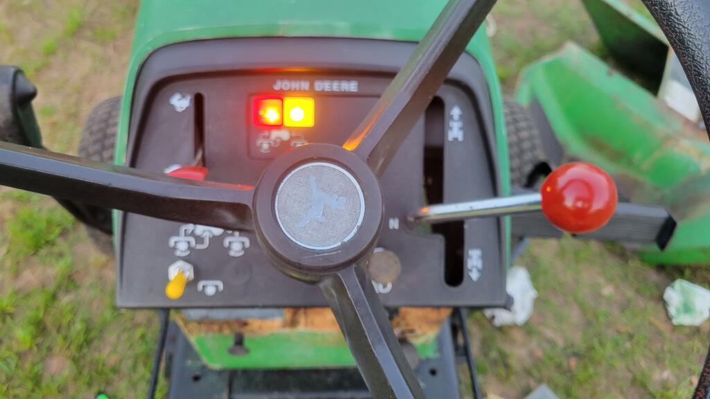

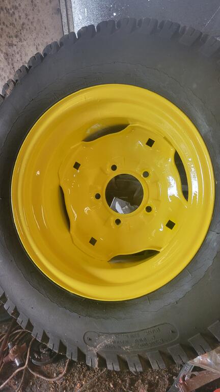

RED-Z06 2,718 #11 Posted February 27, 2023 Well, i dug into it...unmounted the front tires, cleaned the beads and put in some flat-out, they hold. It had no hydraulic oil showing so i put about a gallon in. Put in a battery...nothing, no lights no clicks...zip. Started by removing the battery and battery tray to get harness access and what i found was...ugh. both fuses were cut out and wired directly, the ignition switch was rotted off in back, lots of "repairs" in the harness. I printed out the full electric schematic and the demystification chart. These have a time delay module that, if you bounce on the seat..starts a timer and kills spark after 1 second...to prevent backfires. Everything switched, goes through that magic box. So new ignition switch, new fuse holders, new 5 pin plug at the switch, key on...no dash lights, no pto..but it did crank over. No spark. I know i needed 12v to the + side of the breakerless coil, didnt have it. Also the tdcm didnt click. Ordered a 2nd switch...no change. I fixed the rear harness ground and got the tail lights working, jumping 12v to one switch wire made the pto work. I ended up flipping the position of 2 wires on the switch away from how the diagram had them..immediately had a charge light on the dash..and 12v to the coil. I added gas to the tank, hand choked it...cranked on it maybe 3 seconds and off it went. Ran great. But..I never get a oil switch test light on key on, so i traced that back and found that spot on the 5 pin plug on the engine was empty. Come to find out this warranty replacement engine has a pipe plug where the sender goes...so, im waiting on a 5/16 square pipe plug socket to reach in to remove it...then ill put on my spare sender and harness. Power steering works great, hydro works great. Only bigger fix i have left is pull the driveshaft to install a new hydro input seal, its puking fluid. 2 Share this post Link to post Share on other sites

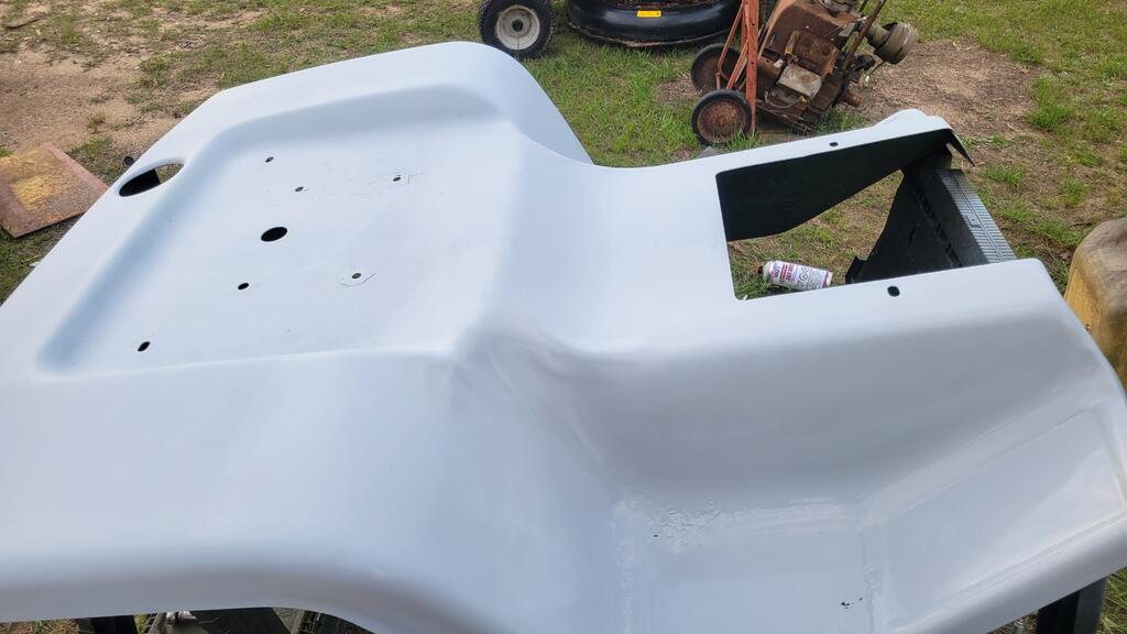

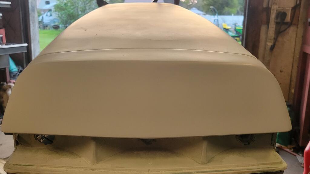

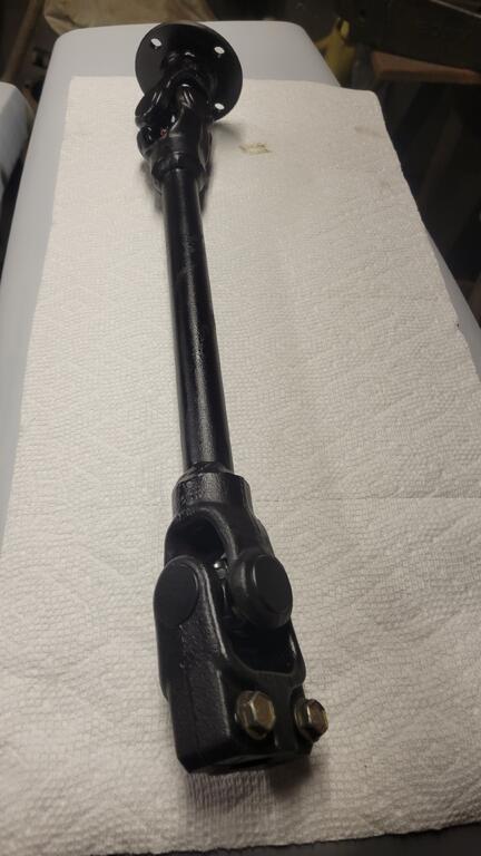

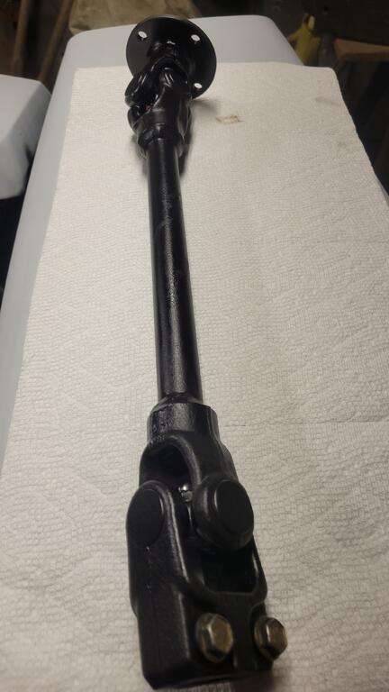

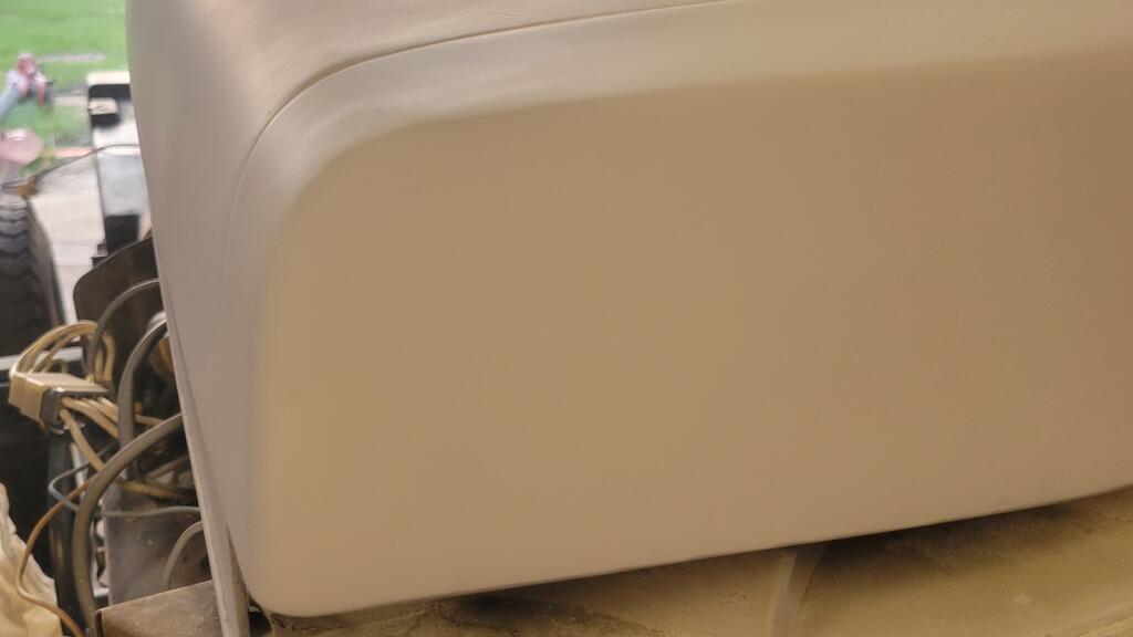

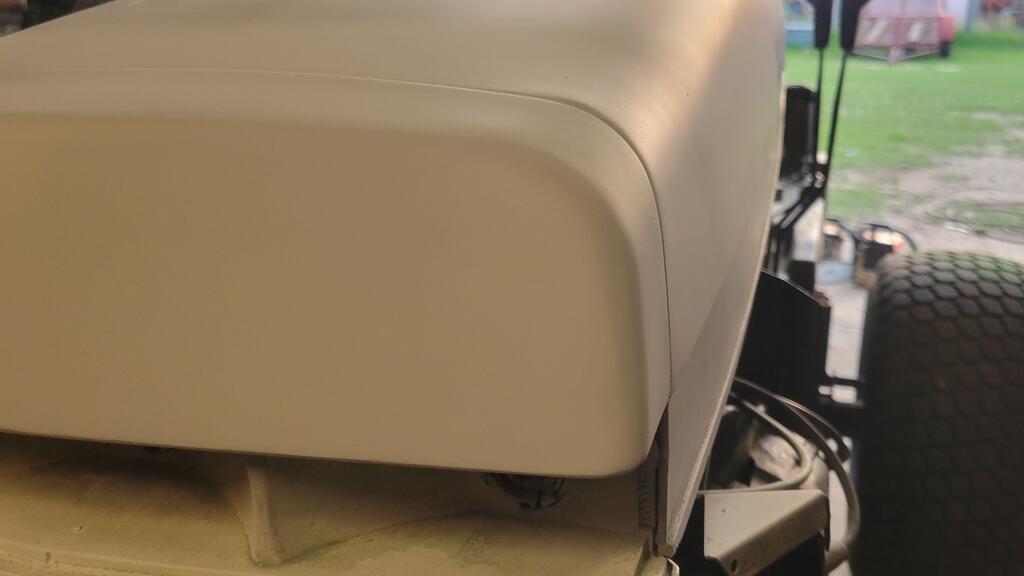

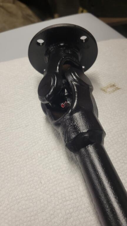

RED-Z06 2,718 #12 Posted March 15, 2023 Progress. Driveshaft was failing, rebuilt it with new joints and a new rear yoke. Repaired the hood, dash is restored, all the tin is stripped, primed and painted..clearcoat tomorrow 2 Share this post Link to post Share on other sites
Handy Don 17,209 #13 Posted March 15, 2023 (edited) 10 hours ago, RED-Z06 said: On the lower left of the dash it looks like PTO switch for an electric clutch. Was there an option for a rear PTO with a separate clutch as well? Nice having weather for working outside! Edited March 15, 2023 by Handy Don Share this post Link to post Share on other sites
RED-Z06 2,718 #14 Posted March 15, 2023 9 minutes ago, Handy Don said: On the lower left of the dash it looks like PTO switch for an electric clutch. Was there an option for a rear PTO with a separate clutch as well? Nice having weather for working outside! Yes. The shaft driven pump has a solid shaft through it, the rear pto kit essentially slipped a shaft over the output which drove a 2nd electric clutch into a gearbox. 1 Share this post Link to post Share on other sites

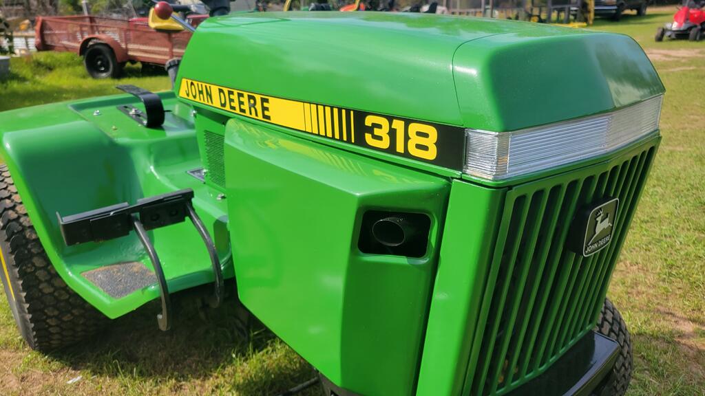

RED-Z06 2,718 #15 Posted March 16, 2023 Getting close. Decals, grille medallion, steering cap decal, wheel center caps, headlight lens, all on their way. Seat is a bit spendy...mother deere is proud of them and its the only seat that works right...probably next week for that. 2 2 Share this post Link to post Share on other sites
