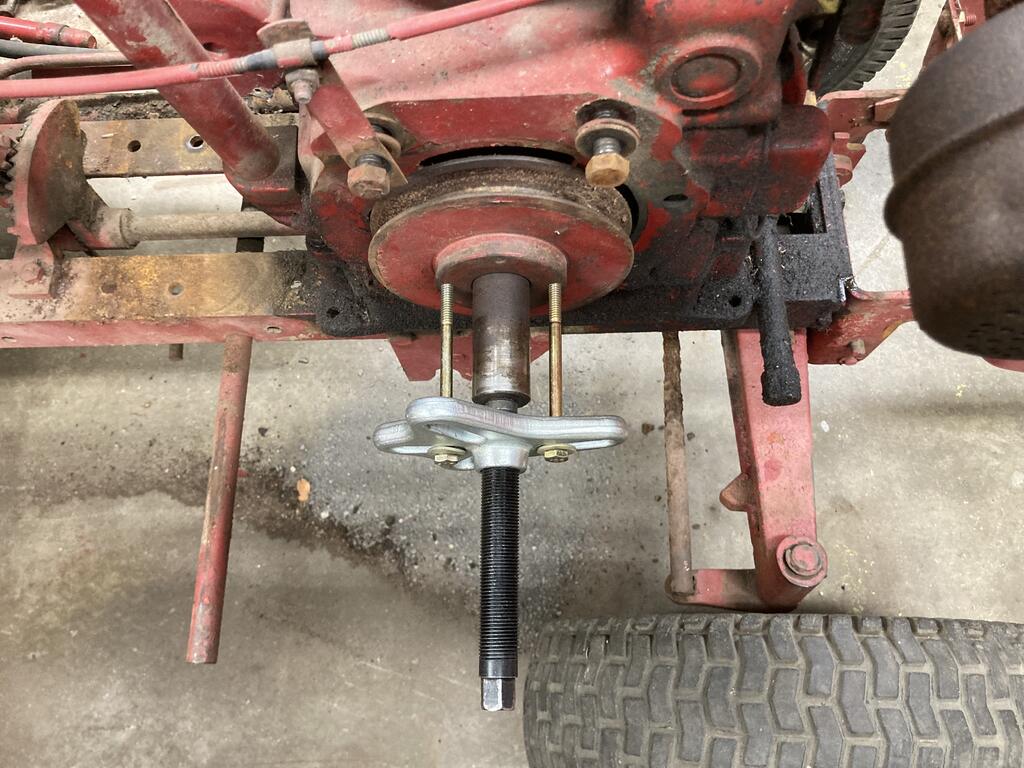

Blasterdad 3,163 #2 Posted February 19, 2023 Remove the set screws in the side of the pulley, sometimes 2 screws, one on top of the other. Sometimes 2 set screw holes, i.e. 12 o' clock & 3 o'clock.... Spray down with penetrating oil in the screw holes & crank. Hook up a puller & remove. 1 4 Share this post Link to post Share on other sites

Blasterdad 3,163 #5 Posted February 20, 2023 51 minutes ago, WHX?? said: Take some emery cloth & lube to the crank stub so it doesn't fight you all the way. I just took that pic to show @bitten the set up. The bolts were barely in the pulley finger tight, I didn't actually pull it, just an "instructional" photo. Lol 1 Share this post Link to post Share on other sites
