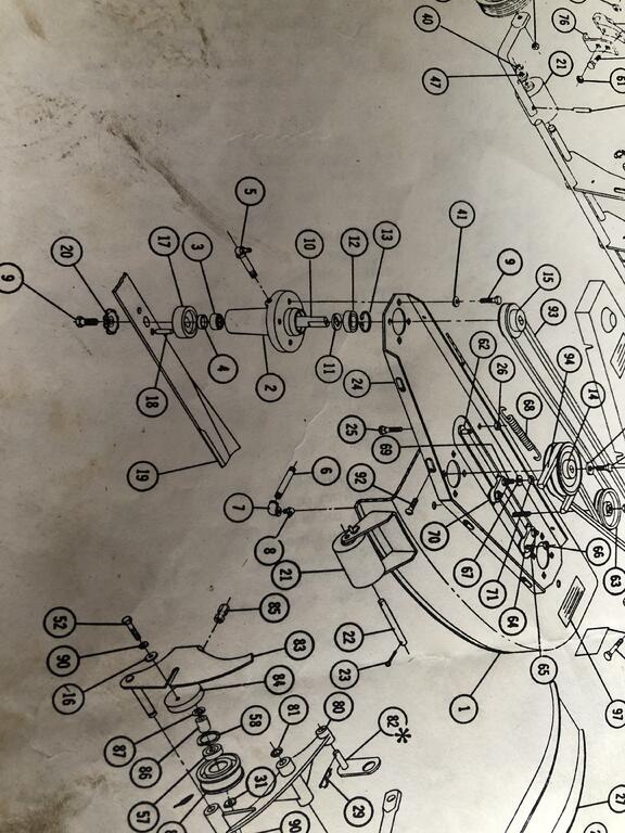

Red Dart 4 #1 Posted February 17, 2023 On my mower deck 48" 5-1483 the center spindle shaft # 5875 along with lower needle bearing are ruined. Does anyone have parts #10, 3, 4 or the whole spindle as shown on attached drawing? 1 Share this post Link to post Share on other sites

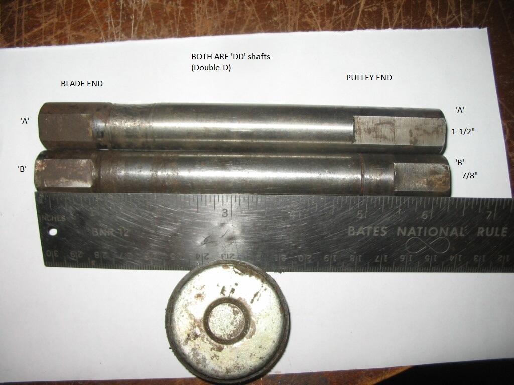

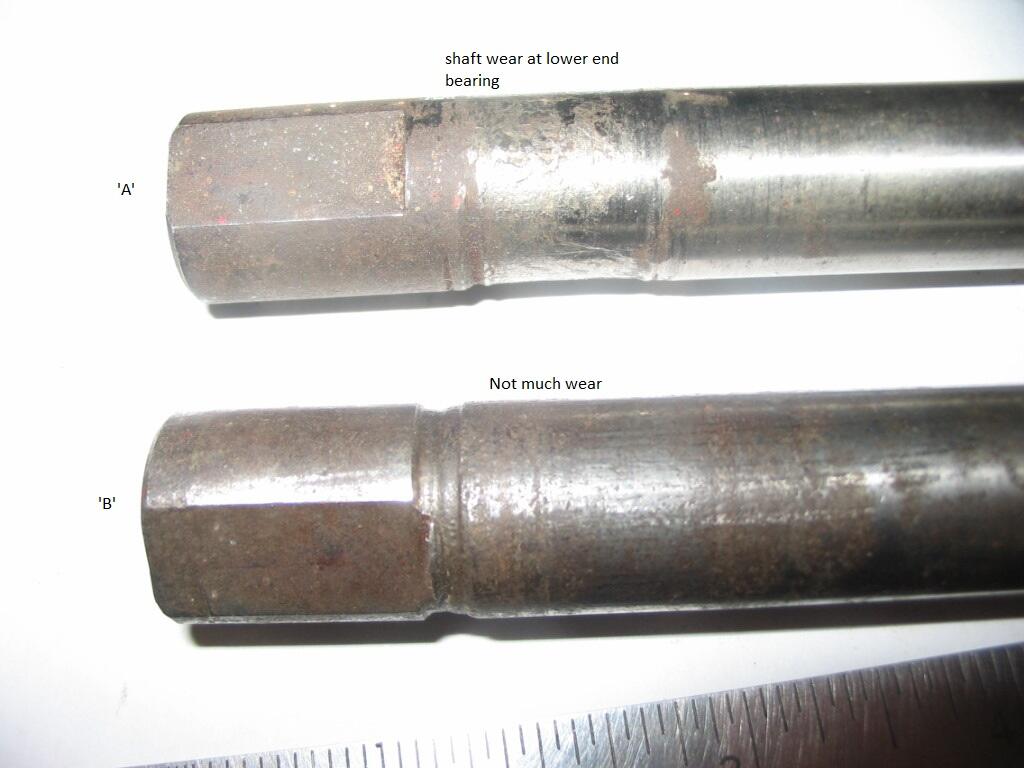

daveoman1966 3,884 #5 Posted February 17, 2023 These are the older 'Double D' spindle shafts taken from a Cast Iron spindle like 5-1483...as in your pic and schematic. The TOP ends...pulley end... are all good to go. All flats on TOP are crisp...not worn. The LOWER end of shaft 'A' is worn...but not terrible like yours. Pulley FLAT is 1-1/2" The LOWER end of shaft 'B' is better...but not perfect. Pulley FLAT is 7/8" Threaded ends are all good too. BOTH are 6-1/4" full length. $20 each... $30 for BOTH... add $8 ship for either or both. PAYPAL money as 'FRIENDS' 1 Share this post Link to post Share on other sites
daveoman1966 3,884 #6 Posted February 17, 2023 The lower bearing is #1508... I likely have one and will include it for only $5 more. 1 Share this post Link to post Share on other sites
