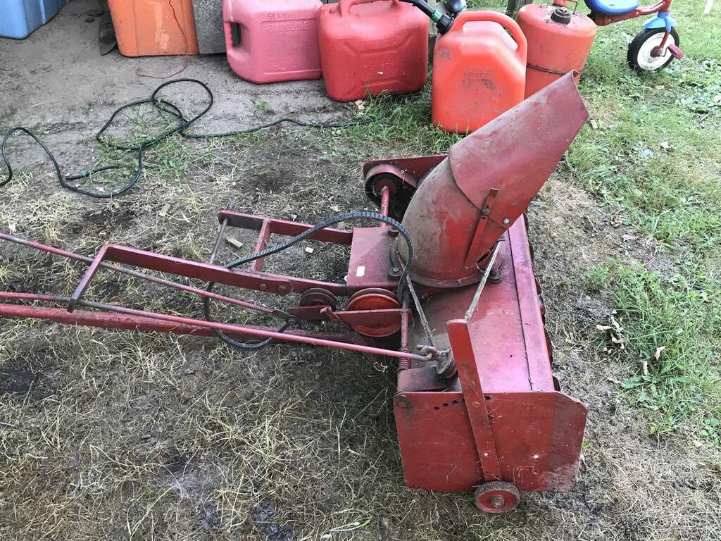

ri702bill 13,189 #7 Posted February 17, 2023 (edited) Not mine, but its cousin someone else has... the 3/8 x8 frame bolt is at the left end of the drive belt. Edited February 17, 2023 by ri702bill 1 Share this post Link to post Share on other sites
