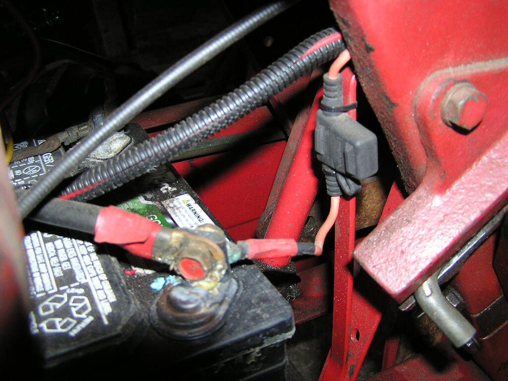

ri702bill 12,696 #2 Posted February 17, 2023 I did one on both the 854 8 speed and the C81. Near the + post on the battery - the wire going to the ammeter, I believe. No pictures - may have some later. Used a 25 amp blade style fuse with the snap over weather resistant cover - made a bracket to "mount" the one on the 854, not so on the C81. Years ago I did have a "thermal event" with Dad's 702 - 50+year old ammeter wire chafed thru - lost the voltage regulator in the process. Adding a fuse is a good idea... 5 Share this post Link to post Share on other sites

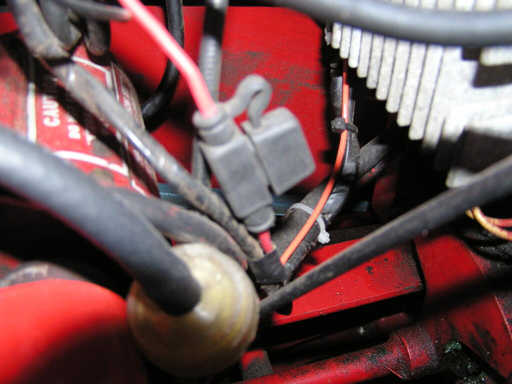

ri702bill 12,696 #15 Posted February 17, 2023 Peek-tures. The 854 was speciffically built to be a reinforced plowing tractor. I added a bent bracket to the left lower hood stand brace - both added fron a 1962 version... Zip tied in place. I think it is important to choose a location that is out of the weather and accessable. Auto parts stores carry these - about 6 bucks and do not come with a fuse. Important - these come in different gauge wire sizes AND temperature ratings - get a big un with the ability to survive next to a toasty Kohler... 4 Share this post Link to post Share on other sites

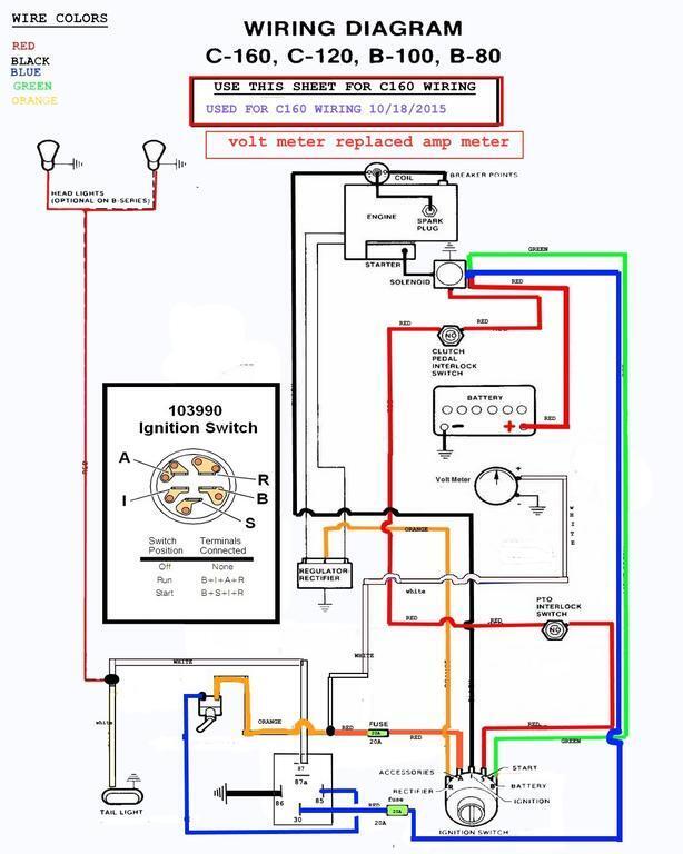

clueless 3,436 #21 Posted February 18, 2023 On 2/17/2023 at 6:41 AM, Achto said: A volt meter will fit in the same hole as an ammeter. In less I'm trying to stay stock, I install a volt meter instead. So how do I wire a volt meter using the wires that go to the ammeter on my C-160? Talk slow I'm color blind and electrical ain't my strong suit. 1 Share this post Link to post Share on other sites
squonk 47,733 #22 Posted February 18, 2023 (edited) 1 hour ago, clueless said: So how do I wire a volt meter using the wires that go to the ammeter on my C-160? Talk slow I'm color blind and electrical ain't my strong suit. Look at these diagrams. One is an ammeter hook up and the other is voltmeter. Same tractor VOLTMETER Voltmeter receives power from key switch thru the meter to ground. You do not want the meter hooked directly to the battery otherwise it will draw power all the time and wipe out the battery and you'll be cussin when you go to mow and it's dead. AMMETER Ammeter gets constant 12 volts from the battery via shared connection at the solenoid. Power flows thru the meter to the key switch. Nothing happens unless key is turned on completing the circuit. Unless the ammeter or wire shorts out causing the tractor to burn up when you're out getting seafood take out. You come home and find out the Ghost of Joseph Lucas has paid you a visit and let the smoke out of your tractor! Edited February 18, 2023 by squonk 1 1 Share this post Link to post Share on other sites
clueless 3,436 #23 Posted February 18, 2023 2 hours ago, squonk said: Look at these diagrams. One is an ammeter hook up and the other is voltmeter. Same tractor VOLTMETER Voltmeter receives power from key switch thru the meter to ground. You do not want the meter hooked directly to the battery otherwise it will draw power all the time and wipe out the battery and you'll be cussin when you go to mow and it's dead. AMMETER Ammeter gets constant 12 volts from the battery via shared connection at the solenoid. Power flows thru the meter to the key switch. Nothing happens unless key is turned on completing the circuit. Unless the ammeter or wire shorts out causing the tractor to burn up when you're out getting seafood take out. You come home and find out the Ghost of Joseph Lucas has paid you a visit and let the smoke out of your tractor! Thanks Mike, I can say the only time I ever dealt with Mr. Joe was in 1969 when an old neighbor lady gave my brother and I a 1958 Ford Anglia that didn't run good . First and last time dealing with him, come to think about it it may be why I'm a little skeptical when doing any wiring . Share this post Link to post Share on other sites
Achto 32,253 #24 Posted February 18, 2023 3 hours ago, clueless said: So how do I wire a volt meter using the wires that go to the ammeter on my C-160? Talk slow I'm color blind and electrical ain't my strong suit. Take the power wire from that goes to the ammeter and run it directly to the switch battery terminal. ( power to the switch ) Run a wire from a switch terminal that only has power with the switch on the "ON" position to the "+" side of the volt meter. Ground the "-" side of the volt meter. 1 Share this post Link to post Share on other sites
