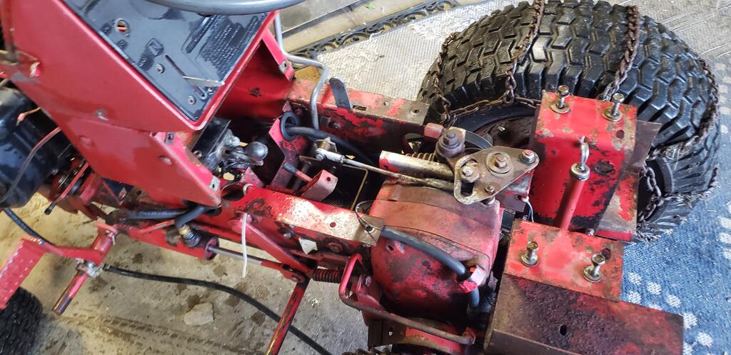

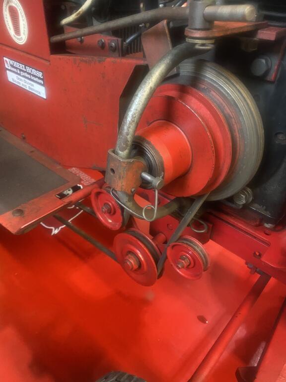

Blackm84 97 #28 Posted February 19, 2023 Also am I missing a pulley on the front belt off the side of the engine? 2 Share this post Link to post Share on other sites
Handy Don 16,212 #29 Posted February 19, 2023 21 minutes ago, Blackm84 said: I am going to soak it in some kroil and try some of my ar-15 roll pin punches. If that doesn't work I have some carbide bits I could drill it out with. Is it at all possible to remove the lower bolts on the steering gear and pull it out with the dash plate still on? Yes. Unless you really need the wheel off the steering shaft, this is an excellent workaround. 19 minutes ago, Blackm84 said: Also am I missing a pulley on the front belt off the side of the engine? From the picture, your PTO looks normal with two pulley sheaves. The drive belt pulley is behind the PTO and locked to the engine shaft. 1 1 Share this post Link to post Share on other sites
Blackm84 97 #30 Posted February 19, 2023 (edited) 54 minutes ago, Handy Don said: Yes. Unless you really need the wheel off the steering shaft, this is an excellent workaround. From the picture, your PTO looks normal with two pulley sheaves. The drive belt pulley is behind the PTO and locked to the engine shaft. is there anything on the steering shaft like bushings or anything that I need to replace? I did notice that the steering wheel had play but if I pushed on the other half of the steering gear it tighted up right away. I was wondering about the pulley because isn't the outer pulley for attachments? it seems like the belt would hit the pto brake if I put it that close. Edited February 19, 2023 by Blackm84 2 Share this post Link to post Share on other sites

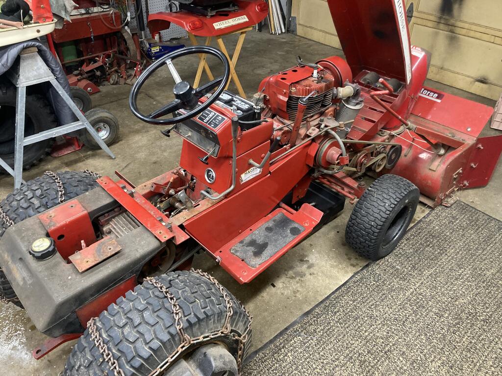

c-series don 11,778 #31 Posted February 19, 2023 The steering shaft can only come out through the bottom. There’s no bushings, just a shaft collar that you can loosen up then push the shaft down and the collar up then retighten. The PTO pulleys are both used, the inner groove is for the mower and snowblower and the outer is for a rear vacuum or generator. I’m sure I’m missing a few attachments but you get the idea. 1 Share this post Link to post Share on other sites

Blasterdad 3,163 #33 Posted February 19, 2023 32 minutes ago, c-series don said: The PTO pulleys are both used, the inner groove is for the mower and snowblower and the outer is for a rear vacuum or generator. Not to contradict you @c-series don but the outer groove is for the snowblower, rototiller, vacuum, ect. Just trying to make sure our new member doesn't get confused... 1 Share this post Link to post Share on other sites

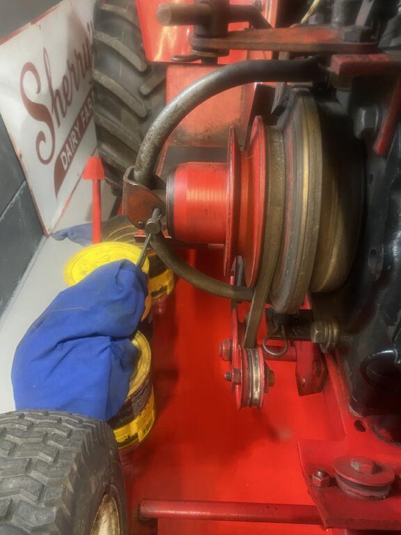

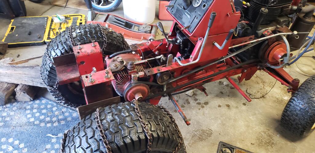

Blasterdad 3,163 #36 Posted February 20, 2023 On 2/18/2023 at 7:28 PM, Blackm84 said: I see what you're talking about now, the PTO brake is bolted on wrong, making it go too far down into the pulley groove. It's supposed to bolt on top of the bracket on the engine. Here's a couple pics of it bolted on correctly, (best I have at the moment) 2 Share this post Link to post Share on other sites
c-series don 11,778 #37 Posted February 20, 2023 11 hours ago, Blasterdad said: Not to contradict you @c-series don but the outer groove is for the snowblower, rototiller, vacuum, ect. Just trying to make sure our new member doesn't get confused... @Blasterdad Not to contradict you,😂 but I’ve never ran my tiller on the outside groove. It simply wouldn’t line up with the mid mount pulleys. Yes the outside is for the generator. Here’s a few pictures, the first three are the tiller and the last is obviously the generator.🙂 2 Share this post Link to post Share on other sites
Blasterdad 3,163 #38 Posted February 20, 2023 (edited) I just looked, mine is on the inside too, Must need to get my pulleys checked! Edited February 20, 2023 by Blasterdad I'm a dumba$$ 2 1 Share this post Link to post Share on other sites
Blackm84 97 #39 Posted February 20, 2023 @Blasterdad It looks like I have the same bracket is it possible its bent? Something seems off on mine I am trying to look at the photos to see what the difference is. 1 Share this post Link to post Share on other sites
Blasterdad 3,163 #40 Posted February 20, 2023 1 minute ago, Blackm84 said: @Blasterdad It looks like I have the same bracket is it possible its bent? Something seems off on mine I am trying to look at the photos to see what the difference is. Yours is just bolted on wrong, it goes on top, look at @c-series don picture in the above posts, it shows it real good. Share this post Link to post Share on other sites
