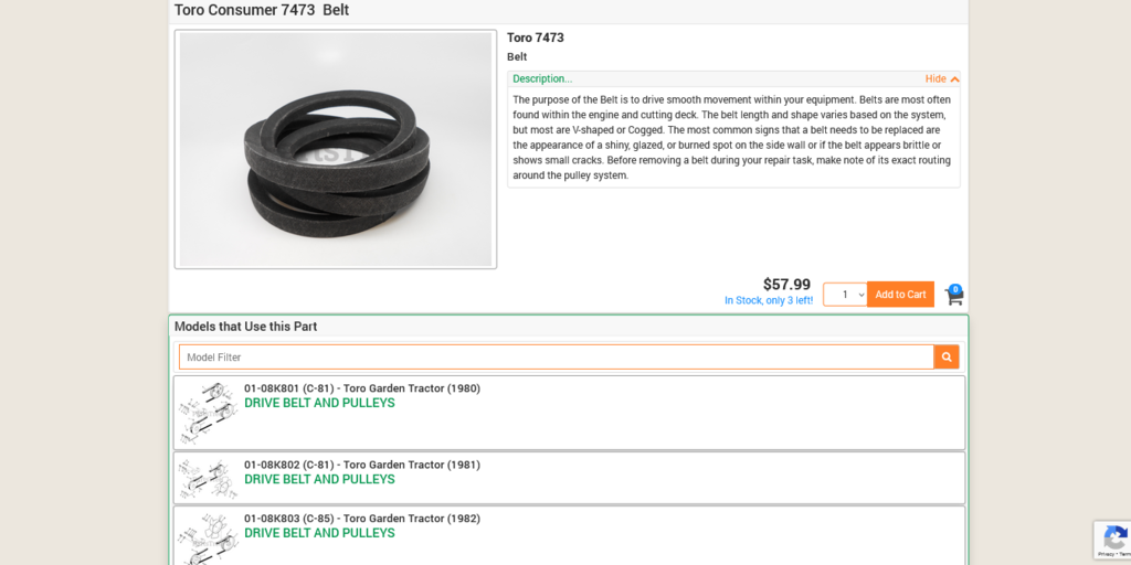

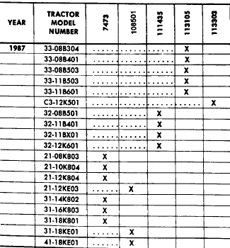

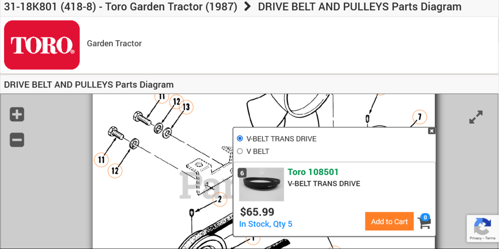

gwest_ca-(File Mod) 12,511 #3 Posted February 15, 2023 Can someone else check? Here is what I have Transmission drive belt 78-7100 replaced by 7473 - HB x 81.9" or 5/8" x 81.9" 2 Share this post Link to post Share on other sites

gwest_ca-(File Mod) 12,511 #6 Posted February 15, 2023 418-8 is a 1987 model 31-18K801 2 Share this post Link to post Share on other sites
gwest_ca-(File Mod) 12,511 #9 Posted February 15, 2023 108501 listed for the hydro models but same dimensions as 7473 Next column in the chart above Transmission drive belt 108501 - (HB/5L x 81.50" or 5/8" x 81.5") Sure wish we had an original parts list for this one. 3 Share this post Link to post Share on other sites
