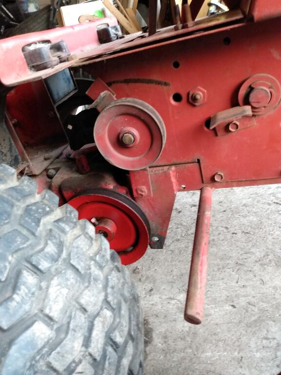

quent pye 16 #1 Posted February 14, 2023 I have a wheel horse tractor and I'm trying to figure out where the spring goes for the clutch 2 Share this post Link to post Share on other sites

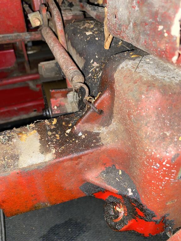

Sparky-(Admin) 19,580 #2 Posted February 14, 2023 The spring goes on the arm in your first picture. The other end goes to a gusset on the top of the transmission axle housing, it has a small hole in it for the loop on the end of the spring. 7 1 Share this post Link to post Share on other sites
quent pye 16 #3 Posted February 14, 2023 Does it have to be a strong spring? 2 Share this post Link to post Share on other sites
953 nut 51,775 #4 Posted February 15, 2023 37 minutes ago, quent pye said: Does it have to be a strong spring? Yes, the spring is what applies tension to your drive belt. Here is a link to the correct spring, https://wheelhorsepartsandmore.com/product/1014-spring-for-wheel-horse/ 2 1 Share this post Link to post Share on other sites
Handy Don 10,635 #5 Posted February 15, 2023 (edited) 1 hour ago, 953 nut said: Yes, the spring is what applies tension to your drive belt. Here is a link to the correct spring, https://wheelhorsepartsandmore.com/product/1014-spring-for-wheel-horse/ I put a loop of wire very tightly clamped in a pair of vise grip pliers and then over the end of the spring to give myself a good hold when installing the spring. Learned this after the very strong spring shot off when my plain pliers lost their grip. Edited February 15, 2023 by Handy Don 2 1 Share this post Link to post Share on other sites

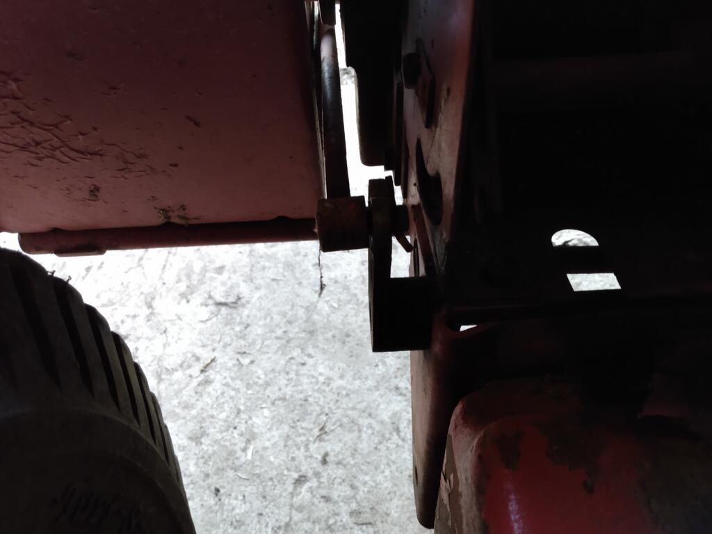

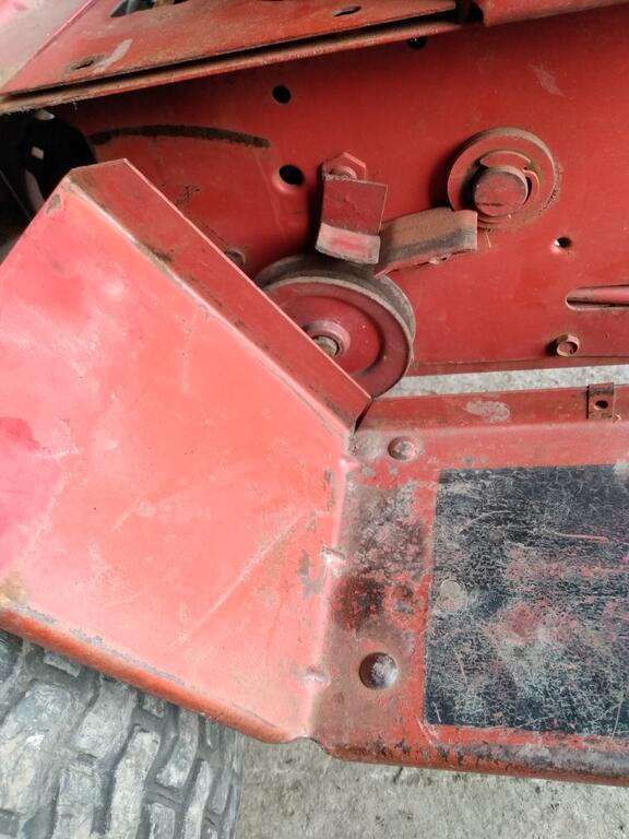

peter lena 8,072 #9 Posted February 15, 2023 @quent pye notice nothing mentioned about lubrication ? second picture , note end of lift arm bushing ? bone dry , no aerosol lubricant in / on the bronze bushings / both sides ? would also bet that any related linkage to that entire clutch set up is rusty / dry . consistently hiding in plane site , is rusty drag , dust , grinding / creaking , binding . especially like the , clutch pedal , jumping bind. also notice the tiny bearing in the idler pulley ? loose fitting trunnion on related linkage ? last photo ? this and more adds up to , a collection of disfunction . only my opinion , but none of those areas / opportunities , exist on my horses . currently bringing back another one , every movement point , actually moves , greasy , pete 1 Share this post Link to post Share on other sites
