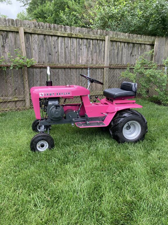

Wheelhorse hoarder 28 #1 Posted February 14, 2023 Hi all, Was wondering what engines people have put in there mk1 lawnrangers. Nobody seems to have done it but would a kohler k101 fit. Thanks 1 Share this post Link to post Share on other sites
Achto 32,923 #2 Posted February 14, 2023 I have seen a few different engines mounted in a Lawn Ranger. I prefer it when it can be done without chopping up the hood. 3 Share this post Link to post Share on other sites

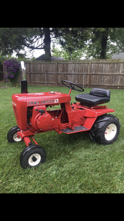

dclarke 4,274 #3 Posted February 14, 2023 Welcome aboard! I put a K91 in one of mine and a K181 in the other. 1 4 Share this post Link to post Share on other sites
953 nut 70,325 #4 Posted February 14, 2023 Very nice looking Lawnranger. I am unfamiliar with the K-101 but it should fit as it will be about the size of the K-91. 1 Share this post Link to post Share on other sites
Pullstart 71,516 #5 Posted February 14, 2023 Thanks for sharing the picture of your little Lawn Ranger! I’ve always been on the fence about owning one. Maybe that means I’m on high alert. I guess whenever one shows up at my door, I’ll open the gate! 1 Share this post Link to post Share on other sites

kpinnc 19,060 #8 Posted February 15, 2023 (edited) K181 will fit, thought the air cleaner fits really tight. If you want electric start- you also have to do something different with the battery. Under the fender is one option. I used a smaller bracket and a motorcycle battery in the normal spot under the hood. Edited February 15, 2023 by kpinnc 1 Share this post Link to post Share on other sites
