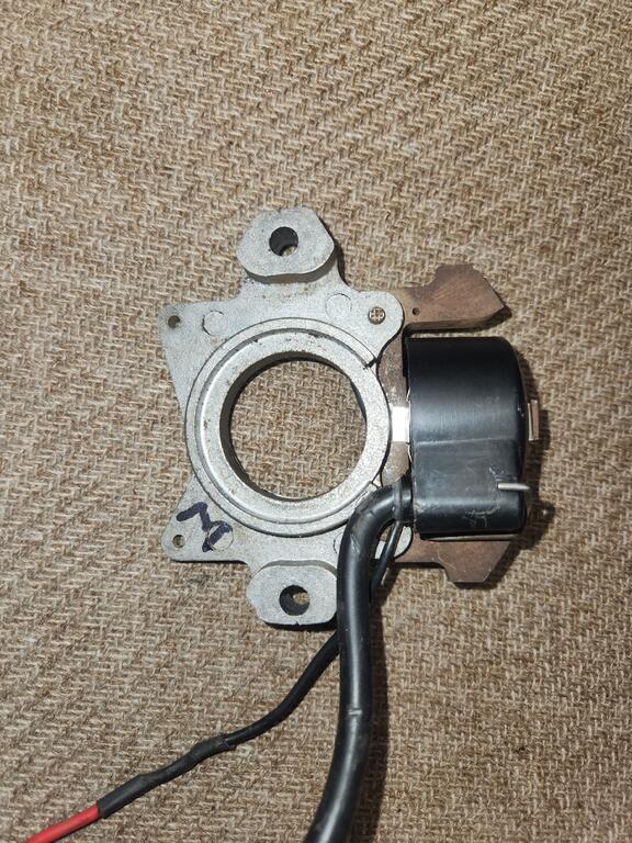

Gregor 4,848 #6 Posted February 12, 2023 I had already taken the wire off of the condenser, and got the same result. There is actually spark, but it's very weak, and very intermittent. There is no kill wire, just that little button on the points cover housing. It is this type of coil. This one is from my motor, and it ran fine. 1 Share this post Link to post Share on other sites

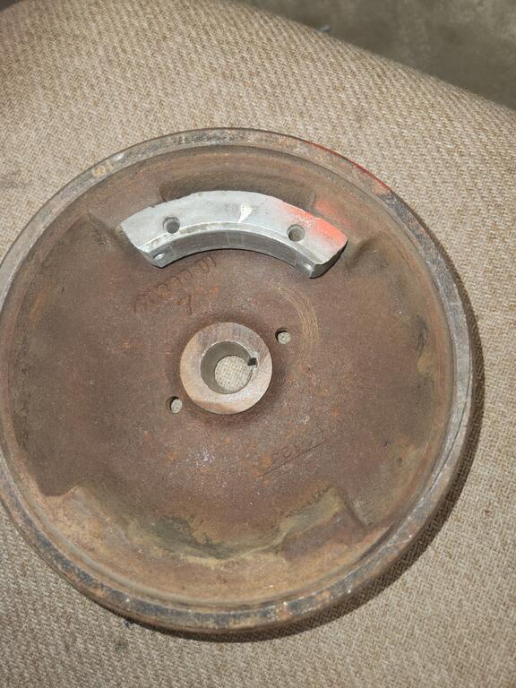

squonk 48,324 #7 Posted February 12, 2023 53 minutes ago, wallfish said: Once had a K91 acting like that. Spark was OK with the plug out laying on the head but it would always loose spark with the plug installed. Drove me nuts! Adjusting the points at very small intervals solved the problem somehow. It ended up pretty far off of .020 Guessing it was because of a weak spark (Coil maybe?) because it was always a soft orange, never got near that nice sharp snapping blue spark. Yup. Play with the points gap. Mags are more fussy when it comes to the primary circuit build up time. How about the flywheel magnets? Did you try swapping flywheels? 1 Share this post Link to post Share on other sites
Gregor 4,848 #8 Posted February 12, 2023 6 minutes ago, squonk said: Yup. Play with the points gap. Mags are more fussy when it comes to the primary circuit build up time. How about the flywheel magnets? Did you try swapping flywheels? There is only one large magnet. It is secure and seems to be quite strong, but I will try that. 1 Share this post Link to post Share on other sites
Gregor 4,848 #9 Posted February 12, 2023 Same result. I will try playing with the points some. 1 Share this post Link to post Share on other sites
