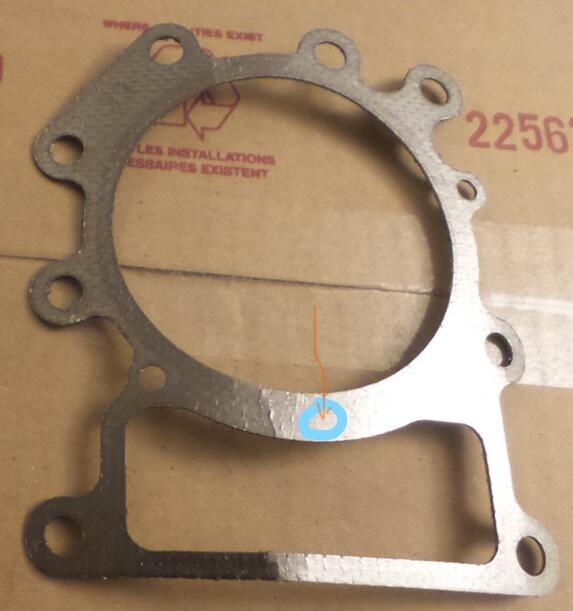

bc.gold 3,406 #2 Posted May 24, 2023 Appears that the engineers at Briggs heard my request, a head gasket impregnated with graphene. Share this post Link to post Share on other sites
lynnmor 7,904 #3 Posted May 24, 2023 14 hours ago, bc.gold said: Appears that the engineers at Briggs heard my request, a head gasket impregnated with graphene. If only they would have put another bolt right here the gaskets wouldn't blow. Share this post Link to post Share on other sites
bc.gold 3,406 #4 Posted May 24, 2023 (edited) 8 hours ago, lynnmor said: If only they would have put another bolt right here the gaskets wouldn't blow. Thoughts, using a centre punch to dimple the block and cylinder head in the weak area. Edited May 25, 2023 by bc.gold Share this post Link to post Share on other sites
