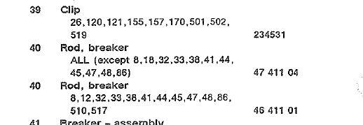

pfrederi 20,823 #3 Posted February 9, 2023 There are two lengths for eh pins in Big blocks...maybe wrong one??? What is spec Number?? 4 Share this post Link to post Share on other sites

pfrederi 20,823 #7 Posted February 9, 2023 I have pulled them out that is when i discovered there were two lengths...(ordered wrong part ## ) Share this post Link to post Share on other sites

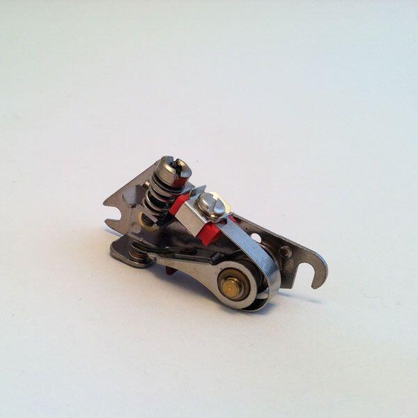

rmaynard 17,409 #19 Posted February 10, 2023 I too find the .003 to be curious. That small of a gap just doesn't seem right. Just to deviate a bit back to 2011. I experimented with a modification for points on a K-series engine. This mod allowed you to actually adjust the points with the engine running. It was a bracket that mounted on the engine, and then you used Chevy points that had an Allen screw, spring-loaded adjustment. The experiment went well, but I found that it was not practical for everyday use. Guys were using them for pulling tractors and cleaning the whole set-up after each use. In winter, they were prone to getting wet since the cover could not be sealed against the weather. I shelved the system and went back to regular Kohler points. For more info go to: https://mwsc.co/collections/k-series-engine-parts/products/points-bracket Here is a picture of the points: You can find the discussion here at https://www.wheelhorseforum.com/topic/23910-kohler-points/?tab=comments#comment-210266 2 1 Share this post Link to post Share on other sites
squonk 47,266 #20 Posted February 10, 2023 Seems to me if the bracket was made out of "U" channel instead of an "L" a cover could have been fashioned to seal it. Have a small hole in the front or bottom with a grommet for the wire and a bigger hole with a rubber plug for the adjustment. Share this post Link to post Share on other sites
stevasaurus 23,737 #21 Posted February 10, 2023 (edited) That bracket for points that Bob shows uses the old Chevy D-106-PS points on the Kohler 10 hp and up Kohlers. The PS stands for Pre-set for the dwell on like 283 and 327 Chev's. Those distributor caps had a little sheet metal door that lifted up to adjust the points with and Allen Wrench. Edited February 10, 2023 by stevasaurus 2 Share this post Link to post Share on other sites

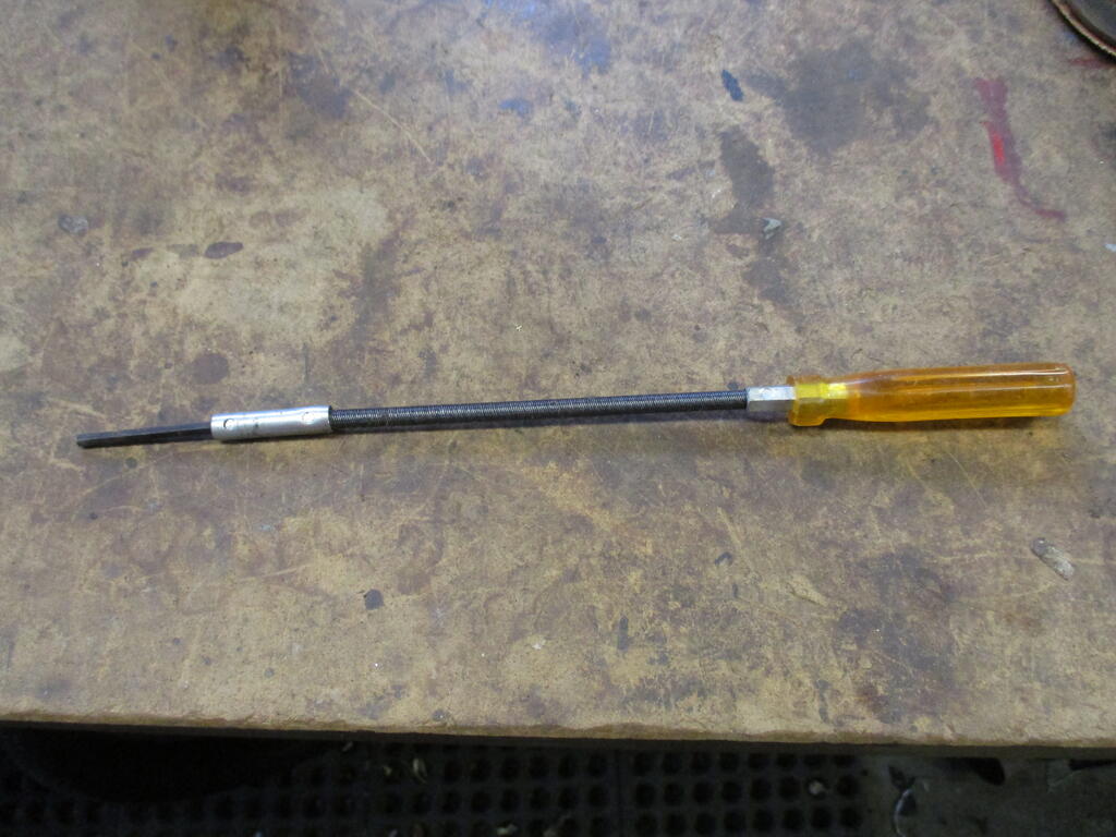

squonk 47,266 #22 Posted February 10, 2023 54 minutes ago, stevasaurus said: That bracket for points that Bob shows uses the old Chevy D-106-PS points on the Kohler 10 hp and up Kohlers. The PS stands for Pre-set for the dwell on like 283 and 327 Chev's. Those distributor caps had a little sheet metal door that lifted up to adjust the points with and Allen Wrench. I used to have a tool that was about a foot long and curved. Had a cable inside with an Allen wrench on one end and a knob on the other. Open the window and insert the Allen end into the points. Turn the knob with the engine running and watch the dwell meter. 2 2 1 Share this post Link to post Share on other sites

pfrederi 20,823 #24 Posted February 11, 2023 18 hours ago, squonk said: I used to have a tool that was about a foot long and curved. Had a cable inside with an Allen wrench on one end and a knob on the other. Open the window and insert the Allen end into the points. Turn the knob with the engine running and watch the dwell meter. Like this one??? So much easier doing the points on my 66 Chevelle than my friends Ford. Share this post Link to post Share on other sites
