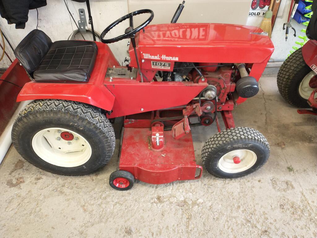

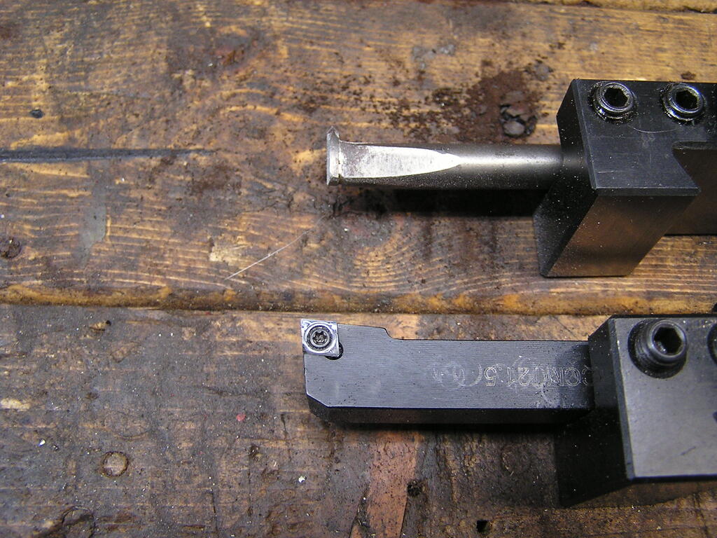

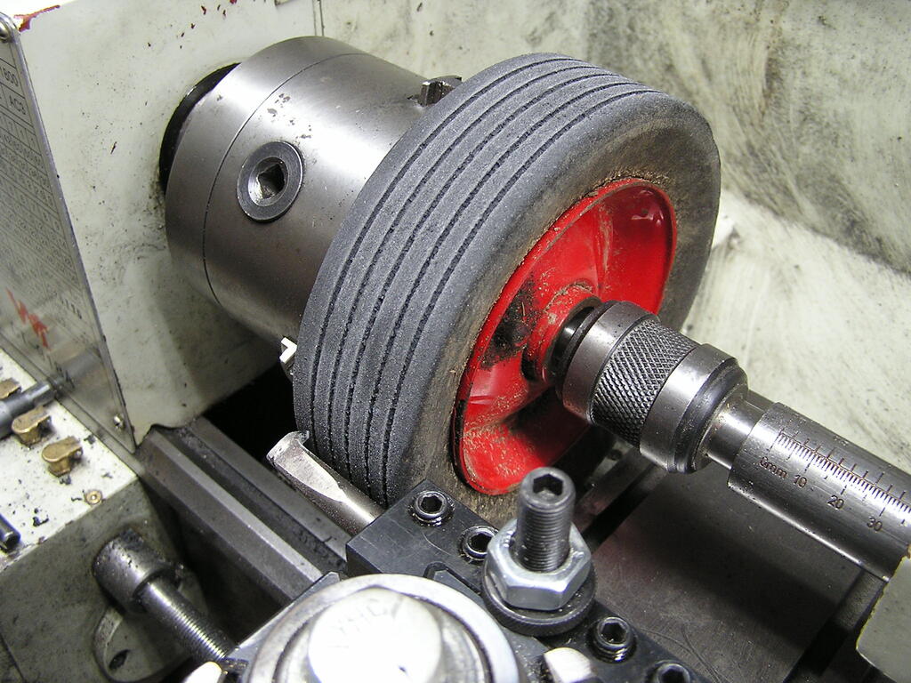

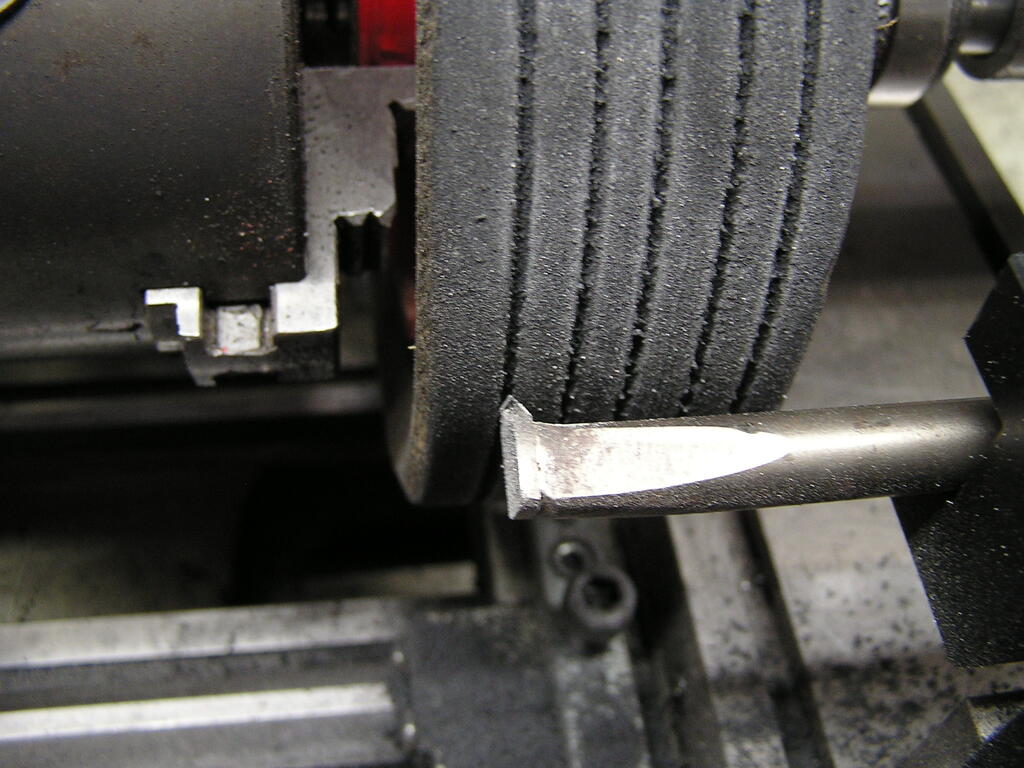

ri702bill 10,081 #1 Posted February 7, 2023 (edited) Working on getting this 1970 32" gear drive deck going again, I found I needed to replace the aftermarket plastic lawnmower wheels on it. I searched the "Parts Department" and found that one of the later 3 blade C series decks I got from @Docwheelhorse had useable wheels with zerk fittings. Both needed a bit of attention - one was worn mostly on one side, the other was egg shaped. I chucked them up in the lathe and trued them up, sanded them with coarse emery cloth. Now they looked like go-kart slicks. Figured why not groove them? Cut them with a boring bar, cleaned up the cuts with the tip of a #3 centerdrill by hand... I call them "Wee- treads"... The rubber actually cut just fine - in the past I have had to put rubber parts in the freezer for at least 2 hours before I could get a clean cut. Edited February 7, 2023 by ri702bill 7 6 Share this post Link to post Share on other sites
