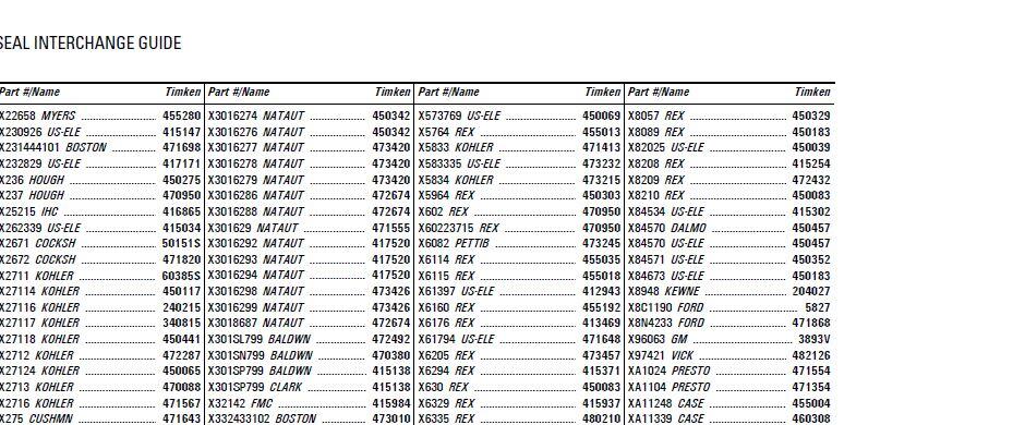

pfrederi 19,880 #12 Posted February 7, 2023 Kohler I guess likes to keep secrets. The Kohler part number for your seal is X-583-2-s. SKF interchange can't find it neither can Timken (see pic). To get a speedie sleeve you are going to have to know the dimensions so you could find a SKF equivilent (there may not be one)...and like ri702bill said the installation tool will most likely be to short to work. Share this post Link to post Share on other sites
