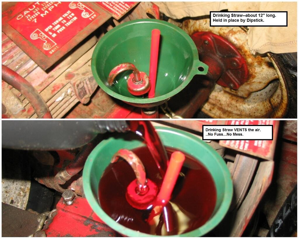

daveoman1966 3,882 #5 Posted February 7, 2023 You may find this 'fill-er-up' funnel method useful.. NOTE... do NOT overfill these hydros. If they are overfilled, the fluid...either ATF or 10-30 oil will 'foam up' resulting in power loss with likely internal damage. 2 1 Share this post Link to post Share on other sites

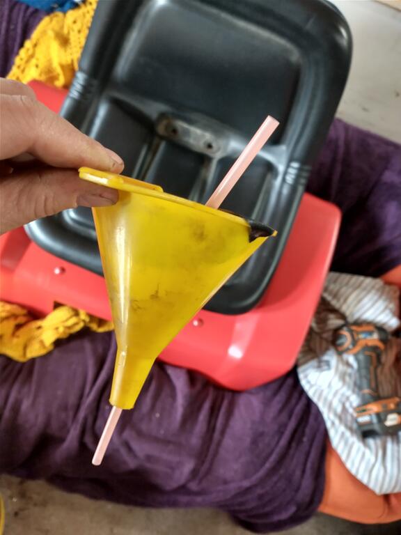

ebinmaine 78,352 #6 Posted February 7, 2023 6 minutes ago, daveoman1966 said: You may find this 'fill-er-up' funnel method useful.. NOTE... do NOT overfill these hydros. If they are overfilled, the fluid...either ATF or 10-30 oil will 'foam up' resulting in power loss with likely internal damage. Here's what Trina put together. 2 1 Share this post Link to post Share on other sites

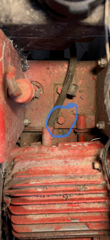

TractorEd 674 #7 Posted February 9, 2023 (edited) On this ‘79 C-161 , I removed the circled bolt and it does go through and act as a vent. Edited February 9, 2023 by TractorEd 2 Share this post Link to post Share on other sites
