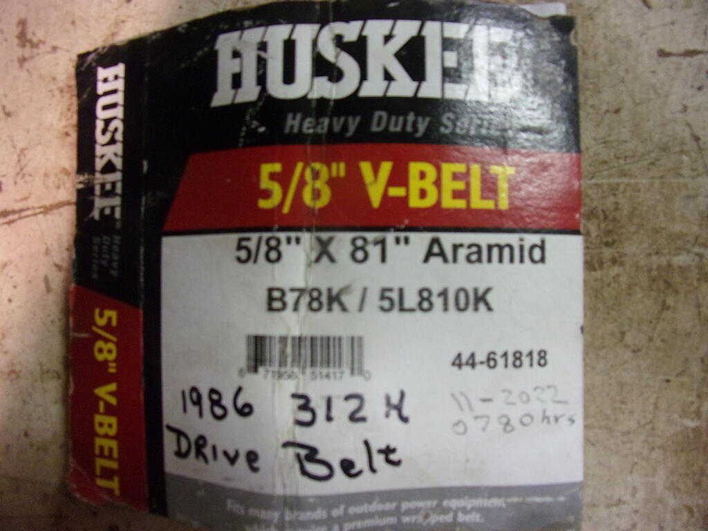

Ed Kennell 43,352 #4 Posted February 6, 2023 (edited) This is the belt I use on my 1990 312Hydro. This has the Eaton 1100 transmission. Your 1987 312A has the Eaton 700 transmission and may take a different length belt. I buy all my belts from TSC and when in doubt about the size, I buy several and return the ones that I don't use. Oh, to the Edited February 6, 2023 by Ed Kennell 1 2 Share this post Link to post Share on other sites
