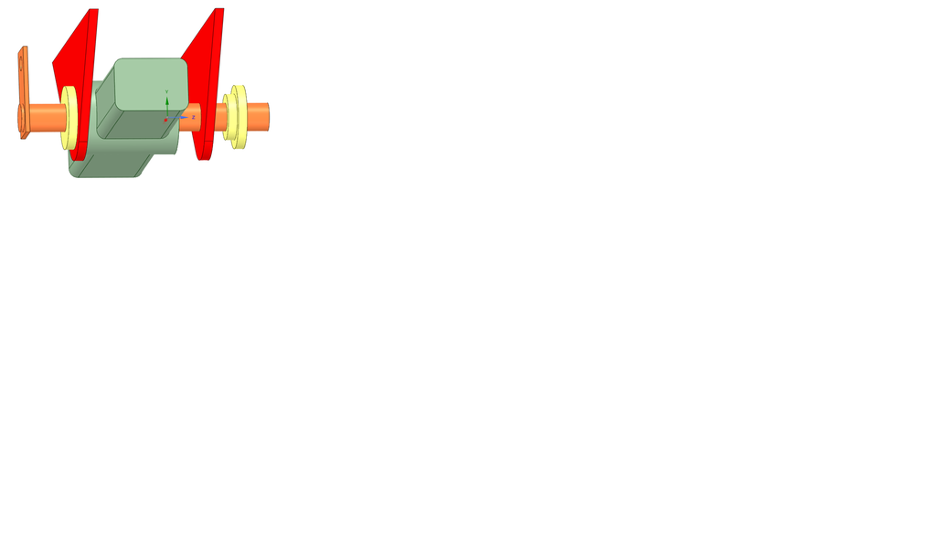

Damien Walker 297 #3 Posted February 5, 2023 Hello! I haven't installed steering spindle bushes but it shouldn't be too difficult if you have the necessary equipment to do it with. I would clamp the axle up at a jaunty angle (to get the angled bearing vertical in a drilling or milling machine and bore it out to a larger size, possibly reaming for a final finish. You could then press in steel or oilite bearings of the correct bore for the spindles again reaming for final size. Needle roller bearings should be possible too. If you don't have the kit to do this with a local machine shop should do it with ease. The axle pivot bearings are easier but it depends on where the wear is....is it the cast iron axle or in the metal plate mountings? I have a Commando 7 that required extensive re-bushing and in my case, the wear was all in the axle so I bored out the centre pivot hole and pressed in a steel sleeve to make up the difference. If the metal plates have worn, again, bore them out round and fit bushed. If you use T shaped bushes (you'd have to turn these on a lathe to suit) welded them in place, you'd then need a longer pivot pin to make up the extra length. The pin is 3/4" diameter across the whole range of tractors as far as I am aware. I have attached a crude 3D drawing...hope this helps! Red = Existing Chassis Orange = Extended Pin (doesn't have to be this long!) Yellow are the two bushes Alternatively, you could simply replace the axle. I have several lying about...unfortunately postage from the UK to the US would be prohibitive but you must have thousands of spares over there. Good luck! Share this post Link to post Share on other sites
