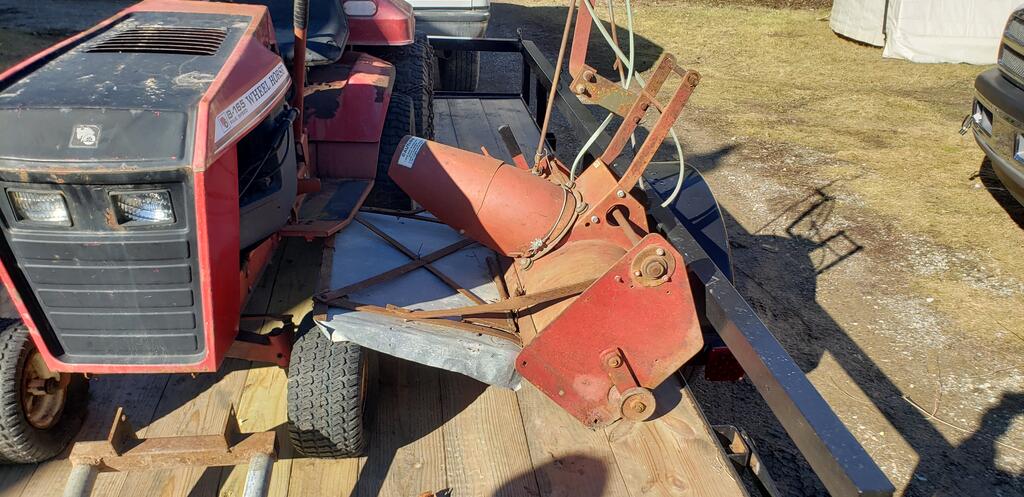

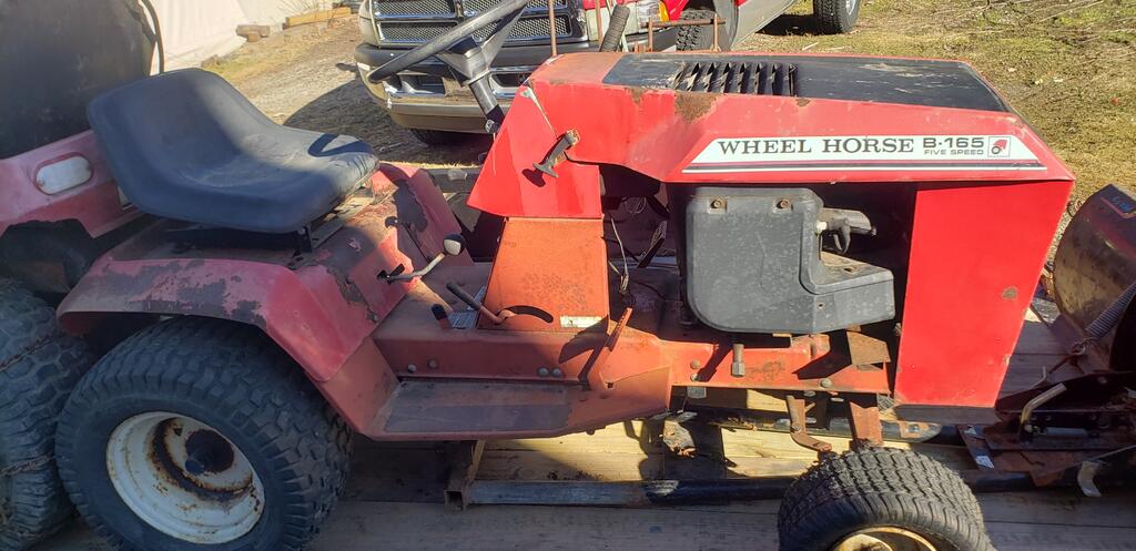

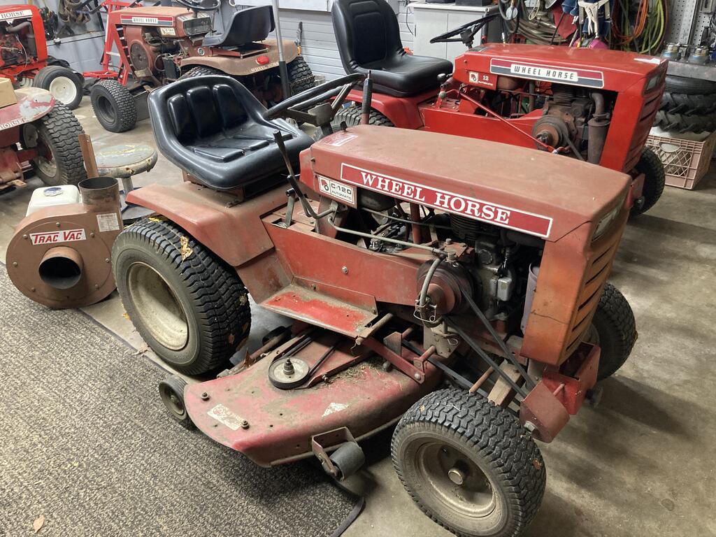

Blackm84 97 #54 Posted February 12, 2023 Well got them home here is some pics 3 2 Share this post Link to post Share on other sites

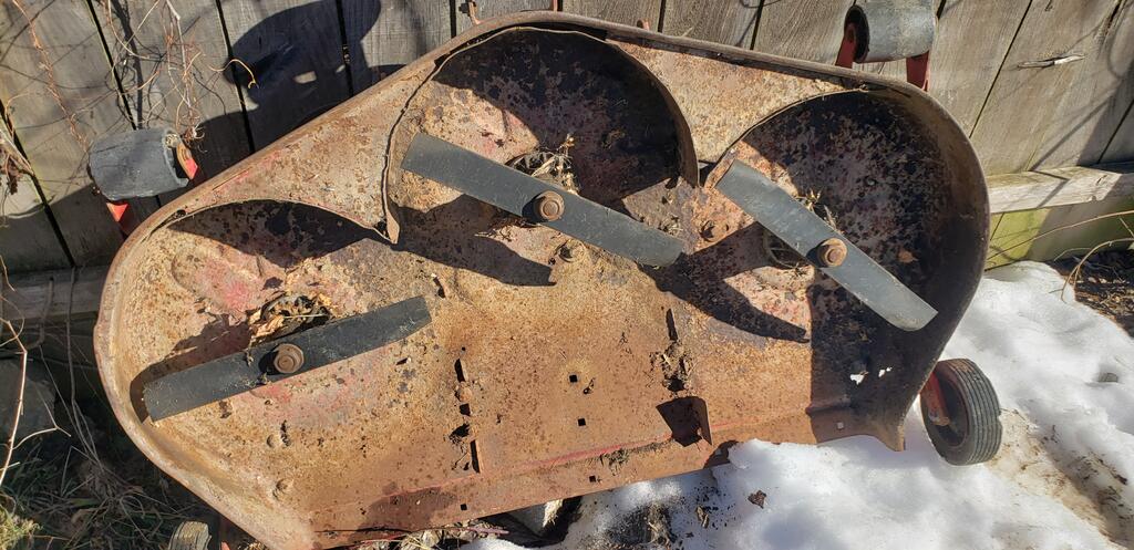

Blackm84 97 #55 Posted February 12, 2023 Here is one of the blower and deck 1 1 Share this post Link to post Share on other sites

Blasterdad 3,163 #57 Posted February 12, 2023 Nice! It looks like a 42" RD deck. By what I can see I don't think the snowblower is for the "C", looks like a "B" set up. Interesting "drift buster" on the front of it, just when I thought I've seen it all, Lol. Not sure about the plow either, the mount looks fabricated? It also looks like the hitch housing on the back of the transmission is busted on the "C" She should clean up nice! Share this post Link to post Share on other sites
Blackm84 97 #58 Posted February 13, 2023 (edited) yea it looks like its partially cracked for the hitch mount, I am going to ask my buddy to see if I can try and weld a piece on there if not the only thing its going to pull is a small yard dump cart. I need a service manual or parts break down especially for the front tie rods, it needs new ones but I am unsure which ones to get. I really like the b-165 both models the tags are no longer legible so there either an 83 or 84. Edited February 13, 2023 by Blackm84 Share this post Link to post Share on other sites

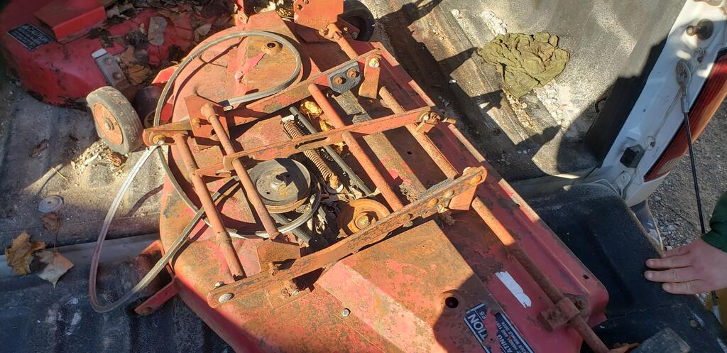

Blackm84 97 #61 Posted February 13, 2023 Here is a top pic of the deck 1 Share this post Link to post Share on other sites
Blasterdad 3,163 #62 Posted February 13, 2023 2 minutes ago, Blackm84 said: Here is a top pic of the deck That goes to the "C" Did you get the mule drive for the deck with it? 1 Share this post Link to post Share on other sites

Blasterdad 3,163 #65 Posted February 13, 2023 1 minute ago, Blackm84 said: I might have it has a bucket full of parts. what is the mule drive? Sorry if its a dumb questions I am new to these machines. Best pics I have at the moment, they're the PTO drive pulleys that mount on the front Tach-A-Matic... 1 Share this post Link to post Share on other sites

Blasterdad 3,163 #68 Posted February 13, 2023 Yes, that's it, 2 pulleys... 1 Share this post Link to post Share on other sites
Blackm84 97 #69 Posted February 13, 2023 Just now, Blasterdad said: Yes, that's it, 2 pulleys... yea then I might have to hunt one down as one of the pulleys was bent really bad. Will any mule drive fit on the c-145? or are they really specific? 1 Share this post Link to post Share on other sites
Blasterdad 3,163 #70 Posted February 13, 2023 (edited) 7 minutes ago, Blackm84 said: yea then I might have to hunt one down as one of the pulleys was bent really bad. Will any mule drive fit on the c-145? or are they really specific? Any C, 300 400 500 should work, the mule for a 520 H 60" deck being the exception, ( won't work ). I think the 37" deck had a funky mule too... Edited February 13, 2023 by Blasterdad 1 Share this post Link to post Share on other sites

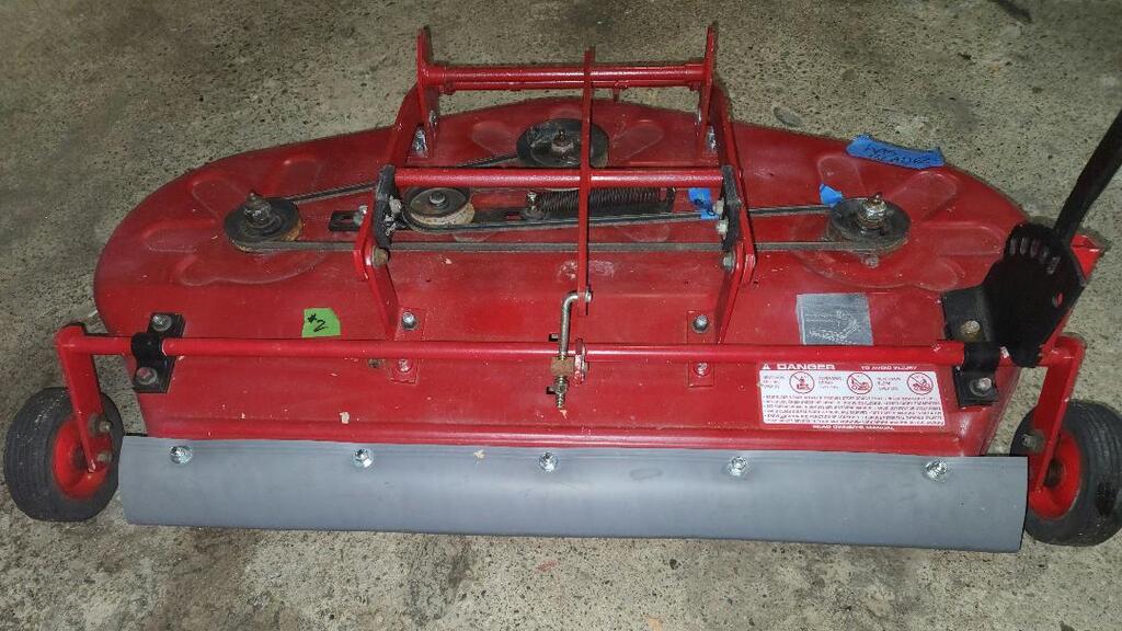

Brockport Bill 2,327 #71 Posted February 13, 2023 1 hour ago, Blackm84 said: Here is one of the blower and deck suggest you consider sand blast to clean bottom rust and corrosion -- get to clean metal, then prime and paint -- i did that and made major improvement - adds many years to lnogevity - - also installed delector flange on rear ( use cariage bolt with rounded head ) Cuttings do not discharge to rear underneath of tractor onto wheel rims, tires and tranny --- i used kitchen cabinate vinyl kick plate that has natural curve on edge 2 1 Share this post Link to post Share on other sites

Blasterdad 3,163 #73 Posted February 13, 2023 Just now, Blackm84 said: I will see if I can find it tomorrow and take a picture. Maybe the pulleys are removable? Yes they are Pretty easy to replace... 1 Share this post Link to post Share on other sites
Blackm84 97 #74 Posted February 13, 2023 3 minutes ago, Brockport Bill said: suggest you consider sand blast to clean bottom rust and corrosion -- get to clean metal, then prime and paint -- i did that and made major improvement - adds many years to lnogevity - - also installed delector flange on rear ( use cariage bolt with rounded head ) Cuttings do not discharge to rear underneath of tractor onto wheel rims, tires and tranny --- i used kitchen cabinate vinyl kick plate that has natural curve on edge I plan on total disassembly and rebuild with stainless bolts and to rebuild the spindles. That vinyl cabinet kick plate is genius! 1 Share this post Link to post Share on other sites
