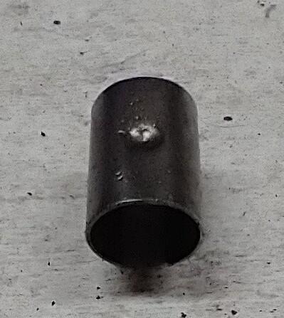

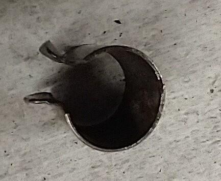

ebinmaine 76,546 #1 Posted February 4, 2023 Are these available for purchase somewhere? 1 1 Share this post Link to post Share on other sites

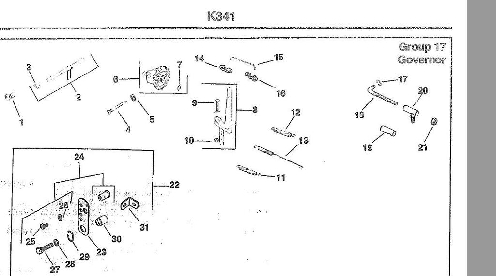

ebinmaine 76,546 #5 Posted February 4, 2023 3 minutes ago, peter lena said: @ebinmaine add in name and model of carb , what it on ? lots of stuff out there , have to be more specific , pete Model varies. This flew off a Kohler K341 engine with a #30 1 Share this post Link to post Share on other sites
peter lena 9,643 #7 Posted February 4, 2023 @ebinmaine look on amazon , k341 engine # 30 part , pete 1 Share this post Link to post Share on other sites

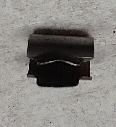

gwest_ca-(File Mod) 11,920 #9 Posted February 4, 2023 That retainer does not have to be removed to release the ball. Steady pressure and a twist should separate them and snap back together. 4 Share this post Link to post Share on other sites
ebinmaine 76,546 #10 Posted February 4, 2023 25 minutes ago, gwest_ca said: That retainer does not have to be removed to release the ball. Steady pressure and a twist should separate them and snap back together. That'd be true but for the previous owner caking a great layer of paint on the whole thing. I tried with all the care and patience I could muster to get the clip off but it flew a ways to the ????? area. 1 Share this post Link to post Share on other sites
squonk 45,078 #11 Posted February 5, 2023 Take a screwdriver and a hammer and tap the clip edge towards the opposite end of the rod. The clip will slide down the rod and away from the ball so you can unhook it. No twisting or turning. Clip stays on the rod. I know " Now you tell me!" 2 Share this post Link to post Share on other sites
