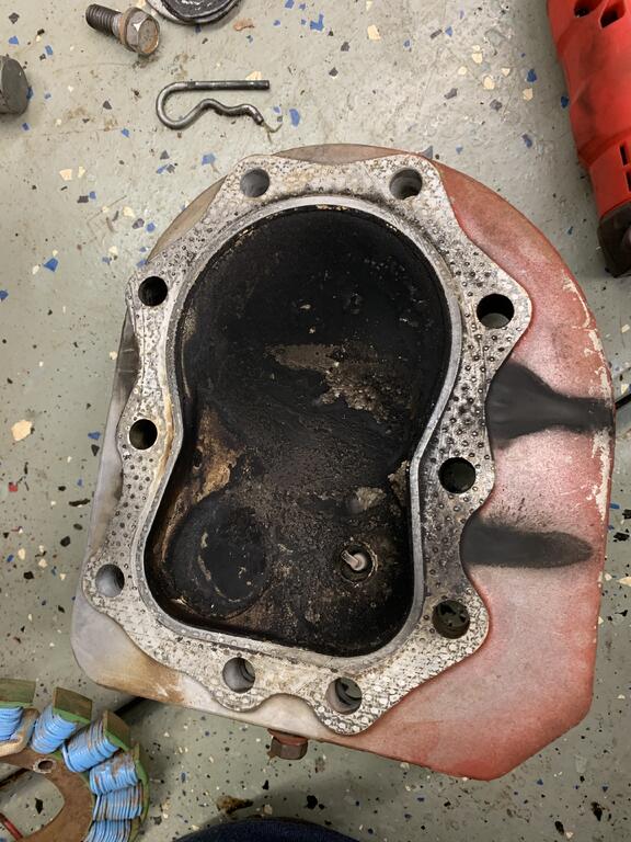

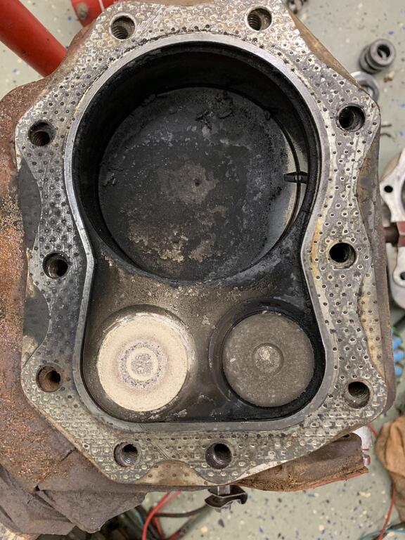

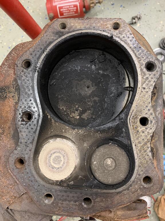

Horse Newbie 7,405 #204 Posted October 15, 2023 Okay fellows, analyze… 2 Share this post Link to post Share on other sites
Horse Newbie 7,405 #205 Posted October 15, 2023 I just turned the crank over by hand and it has no compression ! I guess I’ve done all this for nothing … 1 2 Share this post Link to post Share on other sites

ebinmaine 80,750 #208 Posted October 15, 2023 19 minutes ago, Horse Newbie said: I just turned the crank over by hand and it has no compression ! I guess I’ve done all this for nothing … With the head off I'd hope there's no compression!! 1 3 Share this post Link to post Share on other sites

Bill D 3,156 #211 Posted October 15, 2023 1 hour ago, Horse Newbie said: Okay fellows, analyze… Definitely had a blown head gasket. Are the cylinder walls smooth. 1 Share this post Link to post Share on other sites
Horse Newbie 7,405 #212 Posted October 15, 2023 19 minutes ago, Bill D said: Definitely had a blown head gasket. Are the cylinder walls smooth. Seem to be… 1 Share this post Link to post Share on other sites
