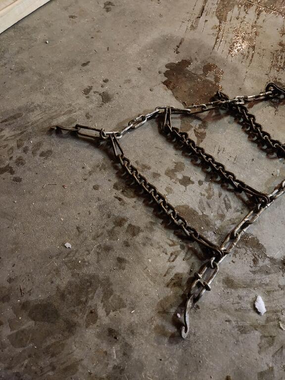

atrerice 2 #1 Posted January 28, 2023 This is my first winter with the 314-8 and plowed the driveway a few days ago after the first decent snow we've gotten here in Michigan this winter. I realized the wheel weights weren't quite enough though. I tried installing the tire chains that came with it and I can't figure out how to attach them. Anyone have an idea how these attach? The hooks on these chains don't look anything like what I've seen in youtube videos. Thanks in advance! Art 1 Share this post Link to post Share on other sites

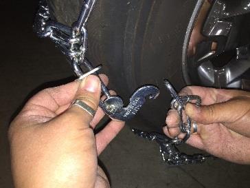

lynnmor 8,882 #2 Posted January 28, 2023 Maybe this photo will help: 2 1 Share this post Link to post Share on other sites
ri702bill 12,414 #3 Posted January 28, 2023 (edited) That latch is the over-center style and works quite well. Per the picture above, the regular chain link on the right goes over the the latch and down into the LOWER notch by the left pinky finger. Rotate the latch to the left, down into and below the link that is held with the thumb and finger. Slide the small oval lock up into the UPPER notch. It is now closed. A bit of advise. Use a zip tie to keep the oval lock in place when done - I had one loosen - once. Deflate the tire and mount the chain AS TIGHT as you can get it, re-inflate the tire - the chain should be tightly in place. Be sure the cross link connectors are facing out - if not, your chain is inside out. Bill Edited January 28, 2023 by ri702bill 2 Share this post Link to post Share on other sites

atrerice 2 #10 Posted January 29, 2023 Thanks guys! I did get the chains on using all your suggestions. Now, they are a bit long for these tires as there's a lot of slack in them even though I used the last link in the chain. Is there a way to maybe shorten them? 1 Share this post Link to post Share on other sites
lynnmor 8,882 #11 Posted January 29, 2023 13 minutes ago, atrerice said: Thanks guys! I did get the chains on using all your suggestions. Now, they are a bit long for these tires as there's a lot of slack in them even though I used the last link in the chain. Is there a way to maybe shorten them? Sure, just cut some off, you maybe need to remove one cross chain. Large pliers, a hacksaw and a vise can be helpful. 1 Share this post Link to post Share on other sites
Blasterdad 3,167 #12 Posted January 29, 2023 11 minutes ago, atrerice said: Thanks guys! I did get the chains on using all your suggestions. Now, they are a bit long for these tires as there's a lot of slack in them even though I used the last link in the chain. Is there a way to maybe shorten them? Yes, move the S hook one link back, (the one that doesn't lock) & hook the locking hook one link forward like the guy did in the video... Share this post Link to post Share on other sites
WHGuy413 2,859 #13 Posted January 31, 2023 If they are not super loose you could always use bungee cords on the inside and outside to tighten them up. But this only works if they are not super loose. If they are I recommend taking a cross link out. Shortening the chains to what fits and re installing the cross link in a different position. 2 Share this post Link to post Share on other sites

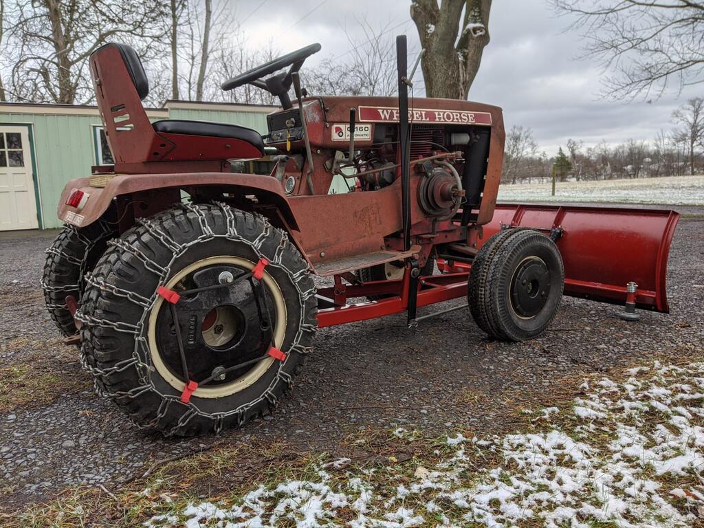

rjg854 13,164 #14 Posted January 31, 2023 I have to use chain tighteners because my wheels are fluid filled and I can't really let the pressure off without letting out the fluid. 1 Share this post Link to post Share on other sites
midpack 1,147 #15 Posted January 31, 2023 If you know anyone taking down a trampoline, the springs make great chain tighteners! 😉 2 2 Share this post Link to post Share on other sites
OutdoorEnvy 1,816 #16 Posted January 31, 2023 3 minutes ago, midpack said: If you know anyone taking down a trampoline, the springs make great chain tighteners! 😉 That's a good idea. Here in tornado alley there are many a trampolines that get picked up each spring in windy storms and mangled beyond repair and end up at curbs for big trash day. I may get a handful next one I see. Share this post Link to post Share on other sites
