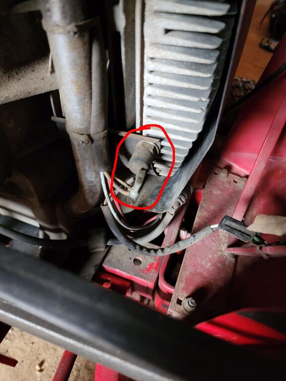

Tims520 18 #18 Posted January 29, 2023 (edited) What's the part I circled? I have to prop the hood up because the snowblower doesn't let you open it all the way, and the 2x4 I use has dropped a couple times. Looking around for anything it might have hit, this part is a candidate. Could it cause this problem or, since I have 12V at the coil with the ignition on (as well as tried a jumper) is it irrelevant? Edited January 29, 2023 by Tims520 1 Share this post Link to post Share on other sites
lynnmor 8,970 #19 Posted January 29, 2023 21 minutes ago, Tims520 said: I have to read through the post Ed linked to again, but I think that means it's time to test the module, which I believe will require me to remove the engine shroud, right? Not bad for maintenance, but that makes this a summer job. The wires come up from the module and it can be tested at the coil, see the service manual you were just directed to. If the module then tests bad it is time to pop the flywheel and open your wallet real wide. The part you circled grounds the temperature light turning it on if it senses overheating. It can cause you no operational problems. 1 Share this post Link to post Share on other sites
