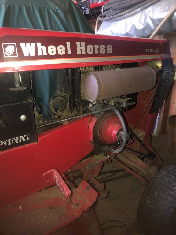

Sharp08 43 #5 Posted February 4, 2023 Thanks for the info, does anyone know if the trans in this pictured 312-8 speed is the same as the one in my 1973? Would it be a direct bolt up? 3 Share this post Link to post Share on other sites
kpinnc 18,970 #6 Posted February 5, 2023 What's wrong with the 312? Probably a more capable machine. 1 Share this post Link to post Share on other sites
Sharp08 43 #7 Posted February 5, 2023 All I know about the 312 is that it sat for 10-15 years without running. The 73 I restored was used weekly to mow. A guy I know is willing to part with the 312 and if the trans is the same I’d like to pick it up for trans parts or a total swap. 1 Share this post Link to post Share on other sites
953 nut 69,474 #8 Posted February 5, 2023 13 hours ago, Sharp08 said: Would it be a direct bolt up? Do you know for sure that the 312-8 transmission is good? It should a reasonably easy swap though it won't bolt right up. You will be going from a six speed to an eight speed so the clutch/brake rod setup will need modification. You may want to use the rear fender/seat support with gas tank from the 312 or could stick with the tool box, seat support, your choice. The shift lever may need to be swapped out. It has been done many times and there are several threads on here about it. 2 1 Share this post Link to post Share on other sites
Blasterdad 3,168 #9 Posted February 5, 2023 1 hour ago, 953 nut said: You will be going from a six speed to an eight speed so the clutch/brake rod setup will need modification. He said it's an eight speed tranny in it... Not sure who's right here, but if so, it should bolt up okay. 1 Share this post Link to post Share on other sites
Handy Don 17,484 #10 Posted February 5, 2023 (edited) On 2/5/2023 at 7:04 AM, 953 nut said: You will be going from a six speed to an eight speed so the clutch/brake rod setup will need modification Several threads on this change in the past. I don’t recall anyone overly pleased with the effort vs. result. On 2/5/2023 at 8:59 AM, Blasterdad said: Not sure who's right here, but if so, it should bolt up okay. Two key install differences between 6- and 8-speeds: input pulley and brake drum location. Either or both can prevent easy bolt-up. The input pulley shaft on a 6-speed is shorter than on 8-speeds. The former commonly used a pulley with the setscrew in the valley of the pulley instead of outside putting the valley of the pulley quite snug up against the transaxle body. This can also affect the drive line alignment and side tin spacing since the larger 12hp engine is wider. The brake drum on the 6-speed rotates in the opposite direction from the 8-speed and the band mounts differently so the brake linkage needs significant changes. Edited February 6, 2023 by Handy Don Share this post Link to post Share on other sites
Sharp08 43 #11 Posted February 5, 2023 Thank you for the responses. I think I’m going to have to just crack my 73, 8 speed open this spring and see what the issue is first. 1 Share this post Link to post Share on other sites
kpinnc 18,970 #12 Posted February 5, 2023 1 hour ago, Sharp08 said: I think I’m going to have to just crack my 73, 8 speed open this spring and see what the issue is first. I think you'll be far happier with the end result this way. ...so go buy the 312 and put it to work while getting the 10 horse 8 speed back in shape! 2 Share this post Link to post Share on other sites
