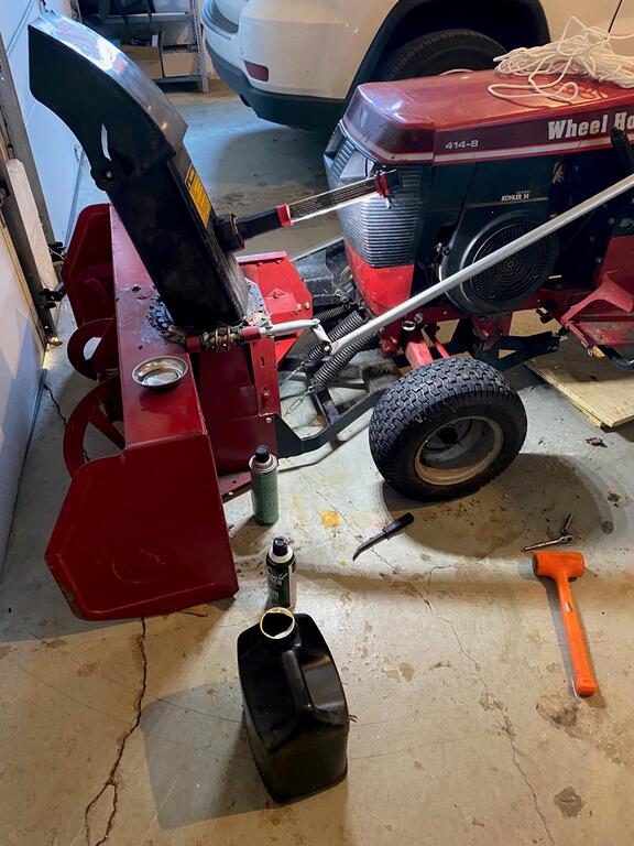

F. Marra 17 111 #4 Posted January 25, 2023 I have a manual lift with my two stage snowblower. The blower is a 44" ber-vac that came with two lift springs that attach to the front tach. I adjust the tension with small turnbuckles. The mid tach is attched to the blower frame with an adjustable rod that can also reduce the lift height and weight. Between the tractor lift adjustment and the blower adjustments, I have no problem lifting the snow blower up and down during the course of a driveway cleaning. say around 10 passes and lifts. (FYI Im 39 and never been to a gym in my life). However, I do have two small boys and once their feet can reach the pedals I expect them to take over snow removal duties. At that point, I will be shopping for a dedicated wheelhorse with hydraulic or electric lift for snow removal duties. A cab would be nice too, but i dont want to spoil them, So hopefully they just understand a little snow being blown back and freezing your face builds character or i can introduce them to a shovel too. Point being i dont think they will have the strength at that age to lift the blower without stopping and using two hands. -Frank 2 3 Share this post Link to post Share on other sites

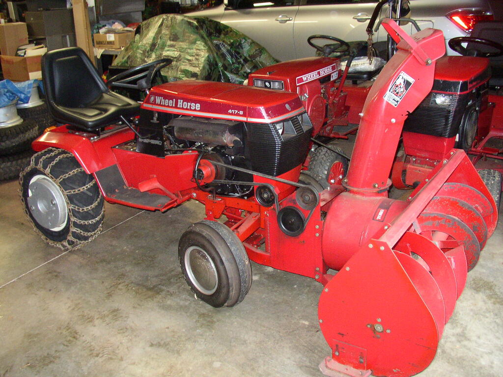

SPINJIM 1,997 #9 Posted January 25, 2023 (edited) Getting back to the original question, the two stage blower is WAY too heavy to continually lift manually. I have a two-stage on a 417-8 with ELECTRIC LIFT, and it handles it because I have TWO LIFT ASSIST SPRINGS, one on the back of the lift rod and another in the front below the hood. The 2-stage is a bear to get off and on, so I leave it on the 417 as a dedicated snow blower. I'll be selling the whole unit in the spring because we're moving to a retirement community where the community handles all of the snow removal. But if I sell it too soon, I know I'll be causing a blizzard in February. Jim Edited January 25, 2023 by SPINJIM 5 Share this post Link to post Share on other sites
