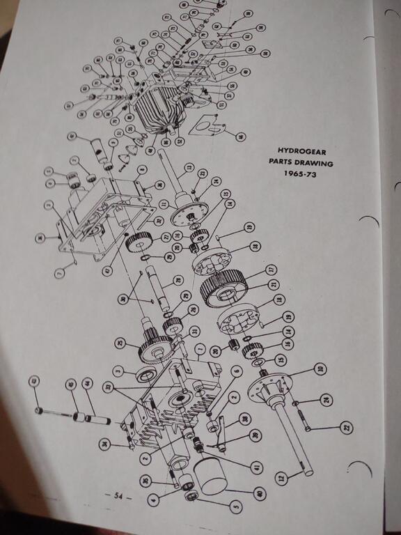

tmix61 29 #1 Posted January 23 (edited) Downloaded this manual but the hydro gear diagram parts drawing for a 65 to 73 and I have a 77 is the rear axle the same everything inside the rear end and everything up front is different? This is the only exploded view of the rear and I can find! 1977 D200 Edited January 23 by tmix61 1 Share this post Link to post Share on other sites
daveoman1966 3,242 #2 Posted January 23 Go to the Toro MPV . The transaxle will be shown. https://lookup3.toro.com/partdex/index.cfm?xCaller=Toro Ener your model number EXACTLY as: 71-20KS01 2 1 Share this post Link to post Share on other sites
