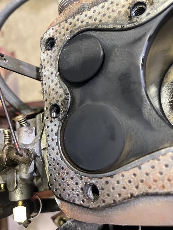

857lover 291 #1 Posted January 21, 2023 (edited) so i have been working on this engine for some time i’ve done a lot with it and it’s never ram quite right and i rebuilt the engine new valves new rings new pistion new connecting rod and such but it’s just not seeming to run quite right and it puffs out the carb when running and there seems to be a lot of carbon built up on the intake and exhuast valve and it probably has saw about a hour of run time it’s can be hard to start and dosent seem to rev up very high when pulling back governor arm and it’s not even snapping back do you guys think the engine could possibly be not timed correctly this was my first time rebuilding any engine what do you guys think i should look at IMG_1157.MOV IMG_1157.MOV perly Edited January 21, 2023 by 857lover Share this post Link to post Share on other sites

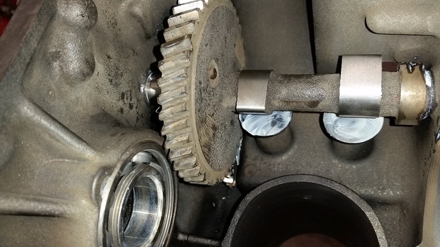

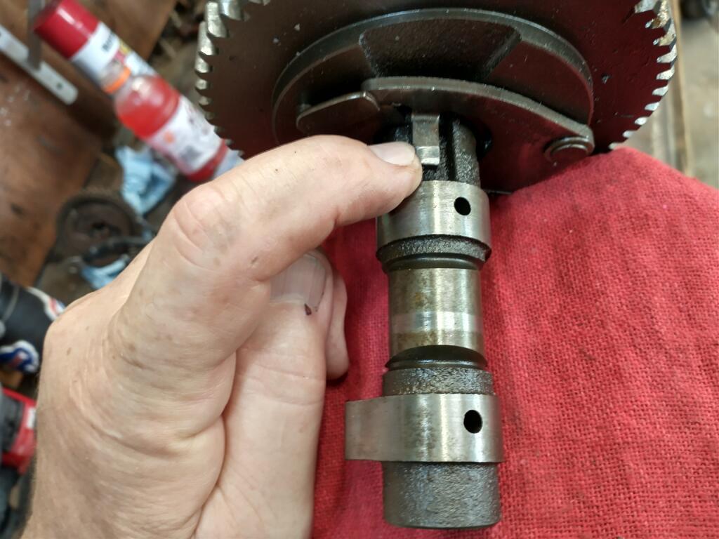

squonk 45,081 #8 Posted January 22, 2023 Did your cam look like this? Or this? 1 Share this post Link to post Share on other sites

857lover 291 #10 Posted January 22, 2023 it’s the botttom one 1 hour ago, squonk said: Did your cam look like this? Or this? 1 Share this post Link to post Share on other sites
