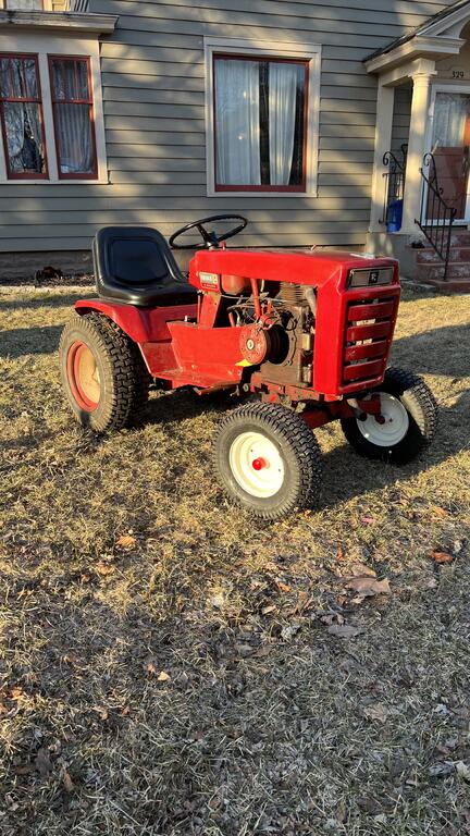

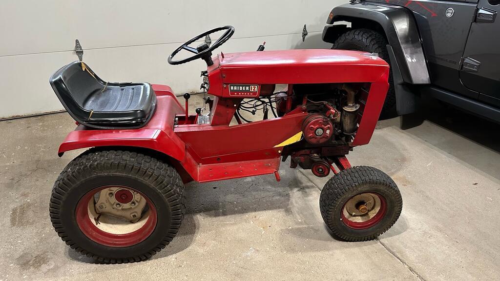

Redav72 231 #1 Posted January 21, 2023 Meant to start a resto-thread a little sooner, but here we are. I periodically peruse the classifieds looking for something both nearby and economically priced, in December I hit on a classified ad that peaked my interest. Only half an hour away and looked to be well maintained. The seller and I agreed on a price and we pushed it up on my trailer. His dad had bought it new in Ohio way back in 1972 and had put it to work on lawn and snow duty. The tractor was maintained in running shape but will receive a thorough reconditioning before being pressed back into service. One of the coolest bits that came with it was a bit of provenance, some type written correspondence from the late 1980's between the previous owner and Wheel Horse corporate inquiring about a failed ignition system. Additionally, the it came with a complete set of manuals and some really nice hand-drawn notes that outline belt placement and part numbers. I think the personal documentation is perhaps my favorite part of this find. 2 7 Share this post Link to post Share on other sites
Sparky-(Admin) 26,621 #2 Posted January 21, 2023 Interesting paint scheme on the wheels. How deep are you going to go in the resto? Shooting for showroom mint? 1 Share this post Link to post Share on other sites

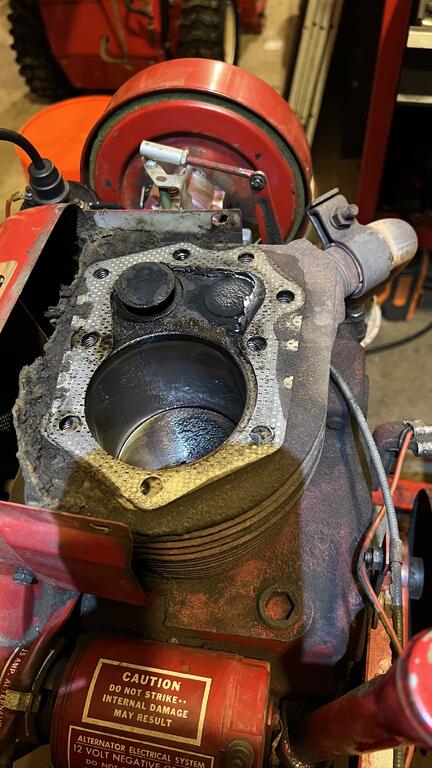

Redav72 231 #3 Posted January 21, 2023 (edited) When I went to look at it the owner and I spent a good hour just trying to get it started to no avail. I was hooked by this point though so we agreed to a discounted price and pushed it up on my trailer. Got it home and ordered a carb kit and a spark plug, that did the trick and I was able to take a short jog around the block. Condition Notes: Front tires were consistently loosing air but the rubber appeared solid. Engine made some funny popping surges and I could see exhaust back through the carb. The head had blown out the plug at some point and had an insert with smaller plug. PO had converted the ignition to points and breaker. The tins had been repainted at some point and the decals were scrapped off. The seat was a replacement and was in pretty bad shape. Needed a new battery Electric PTO is disconnected. Drive belt is worn and cracked and a bit jumpy Headlight wiring melted on muffler The Plan: Since it was well maintained as a worker I'm planning to honor the effort that the PO put in. new plug and carb rebuild (done) strip all the tins off and pressure wash, buff the paint cleanout combustion chamber, gasket, new head bolts, engine tune-up (done) new decals repaint the hubs (front done) new seat (done) rewire headlights and tail light evaluate electric PTO, have a mechanical PTO that I might swap in add a mowing deck New belt Edited February 20, 2023 by Redav72 Updating item status 1 4 Share this post Link to post Share on other sites

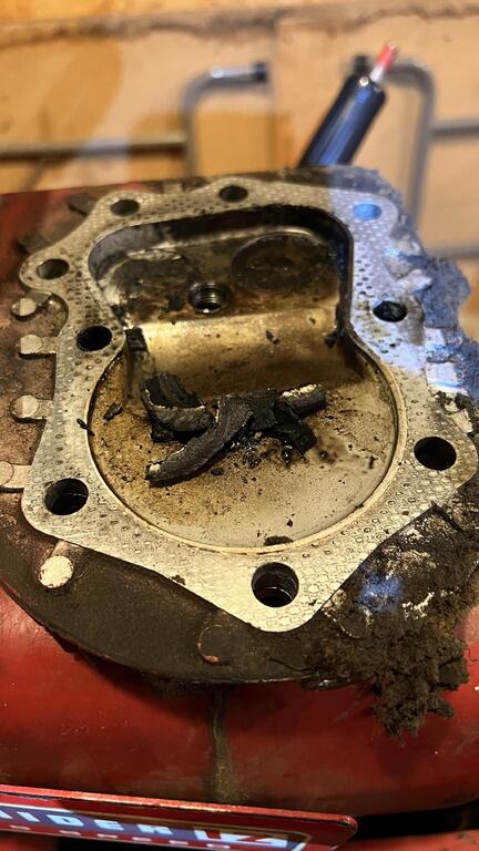

Redav72 231 #4 Posted January 21, 2023 Worked on the engine a couple weeks ago, lots of carbon build up. Have a gasket on order from isavetractors and I’ll replace the head bolts with new grade 8 when I reattach. 3 2 Share this post Link to post Share on other sites

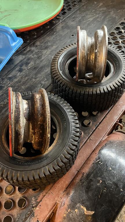

Redav72 231 #5 Posted January 21, 2023 (edited) Today though was front wheel day. I dislike dismounting and mounting tires (old rubber and lots of force makes me nervous). Fortunately my local farm and fleet will dismount for free and then charges only 12$ when I come back to have the tires remounted. Picked up the paint and some wire wheels after they dismounted the tires. Edited January 21, 2023 by Redav72 4 Share this post Link to post Share on other sites

oliver2-44 11,791 #9 Posted January 22, 2023 4 hours ago, Redav72 said: @Redav72 Noticed your piston has carbon on one half and wet with oil on the other half. I had an engine that looked like that and was told it was a sign of piston blow by. My engine is still running but slight smoke and maybe a little down on power. 2 Share this post Link to post Share on other sites

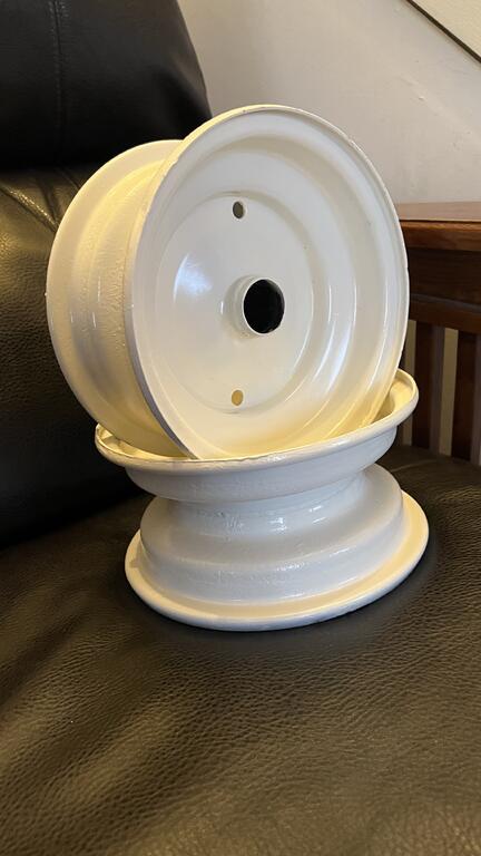

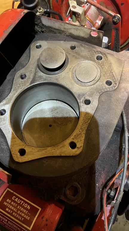

Redav72 231 #10 Posted February 12, 2023 Got the front wheels painted and back together, unfortunately one of the pair still doesn’t hold air so it’s tubes for me. Last weekend I went out and picked up a new seat, installed it this afternoon. Head gasket came in and I got the he head buttoned down. IMG_6680.MOV IMG_6680.MOV 2 Share this post Link to post Share on other sites

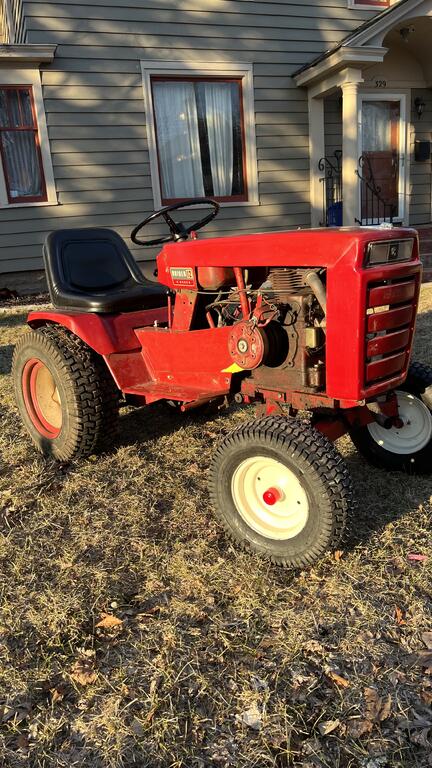

Redav72 231 #17 Posted February 20, 2023 Picked up new front tires at farm and fleet, caps from WH parts and more. Pretty happy to see it running again. Sent a few texts of progress back to the original owner so he know that’s it’s being taken care of. The paint cleanup will have to wait for spring weather but I’m pretty pleased that it’s back to being a useful tractor. 2 Share this post Link to post Share on other sites
