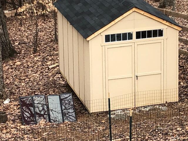

Sailman 1,307 #1 Posted January 21, 2023 (edited) Anybody have tractors stored in buildings/ sheds without electricity needing to trickle charge batteries? I do.... Been messing around with some solar panels and looking for a way to charge batteries without running long drop cords. Here is what I found to be a great option. https://www.harborfreight.com/100-watt-amorphous-solar-panel-kit-63585.html?_br_psugg_q=solar+panel Not the cheapest option (got mine on sale) but I like the kit because it comes with panels, controller (needed to keep batteries from draining at night) and long attachment wires. Also, these amorphous panels will put out a charge in almost any kind of light. Kit also comes with 2 -12 volt lights so as long as controller is hooked to a battery you have light in that remote shed / barn. Panels are easy to move around so I just rotate the set up between 2 different sheds keeping 5 tractors and 1 dirt bike topped up. Edited January 21, 2023 by Sailman added info 2 Share this post Link to post Share on other sites

Sailman 1,307 #4 Posted January 21, 2023 The solar trickle chargers would work just fine. I like the added feature of lighting in the shed plus I keep it hooked to a marine battery when not charging the tractors and that gives me other options with an inverter in sheds with no electricity. I pair the panels up instead of attaching all 4 together. Allows me to move the 2 panels easier between sheds. Still plenty of juice for charging batteries. Share this post Link to post Share on other sites
lynnmor 8,875 #5 Posted January 21, 2023 Why not take a few passes with a plow and run some 14-2 UF? Maybe you have obstacles, but $150 for 250' isn't bad if you consider the nuisance of maintaining solar equipment. 3 Share this post Link to post Share on other sites

Sailman 1,307 #7 Posted January 22, 2023 2 hours ago, lynnmor said: Why not take a few passes with a plow and run some 14-2 UF? Maybe you have obstacles, but $150 for 250' isn't bad if you consider the nuisance of maintaining solar equipment. Would cost me a whole lot more than $150 given the location of the shed, sodded yard, concrete and access to my electric panel. Not sure what maintenance you are talking about? Wash the solar panels every 6 months everything else is on cruise control. But hey...to each his own. Works for me. Share this post Link to post Share on other sites
