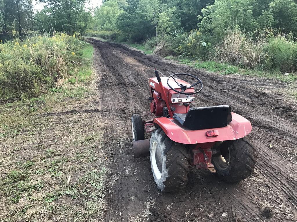

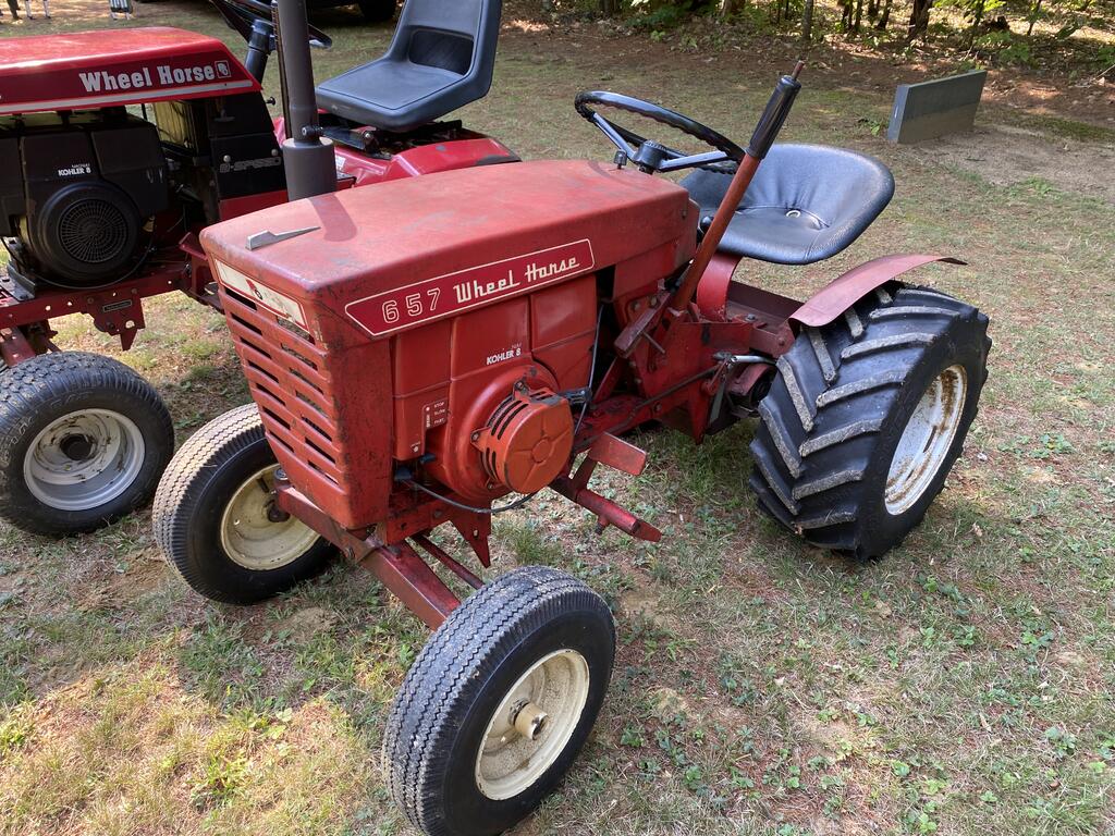

Pullstart 70,678 #2 Posted January 20, 2023 Whatever ones I’m sitting over top of Honestly, these old ags are hard as a rock and not very deep lugs, but with no added weight, they never disappoint me. 3 Share this post Link to post Share on other sites

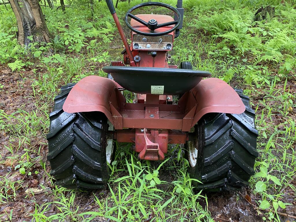

Pullstart 70,678 #3 Posted January 20, 2023 I also run Deestone brand on a few of my rigs. They are not the greatest in everything and do run small, but they do quite well in most instances. These are 23x10.50-12’s, measuring about 8.5-9” wide. 1 Share this post Link to post Share on other sites

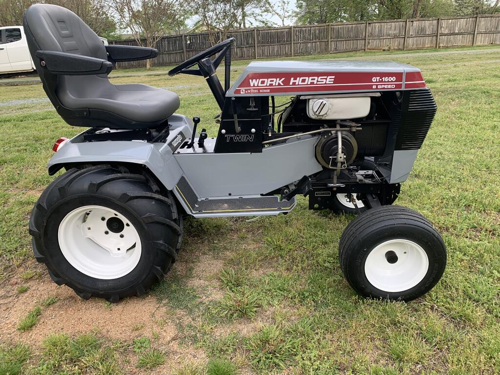

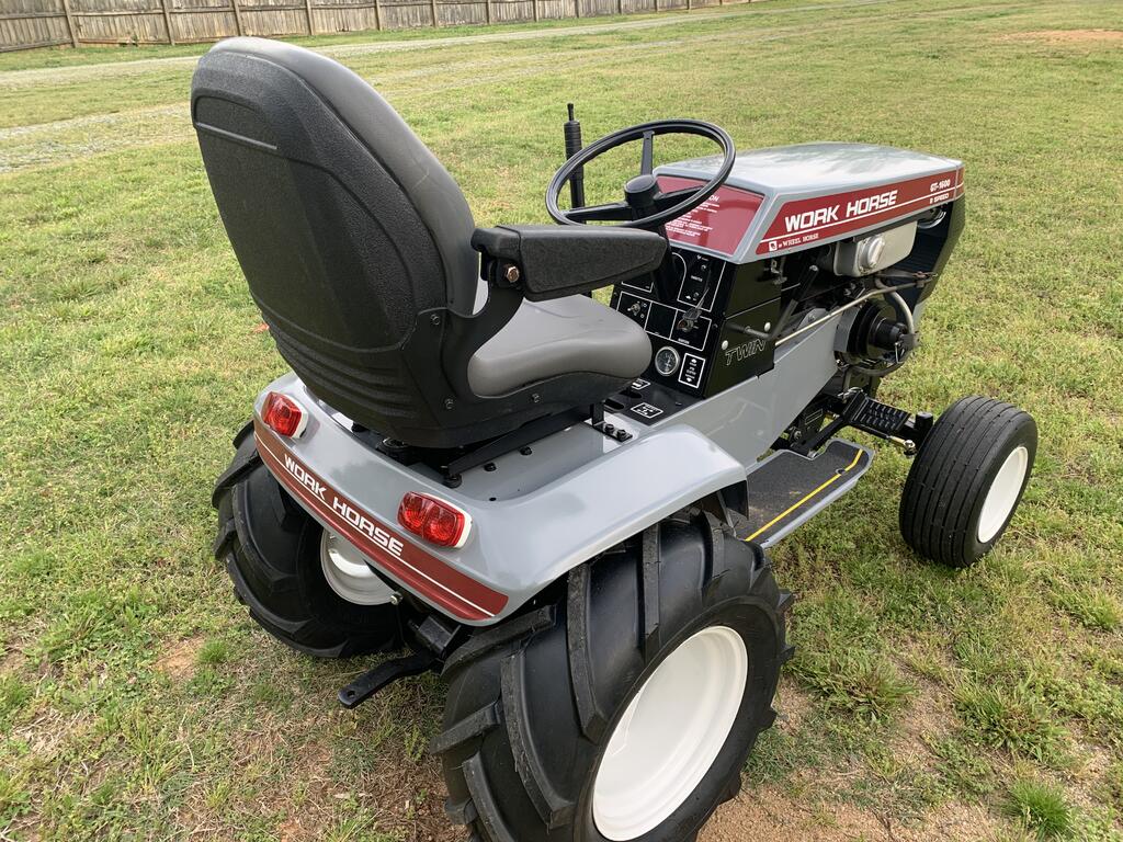

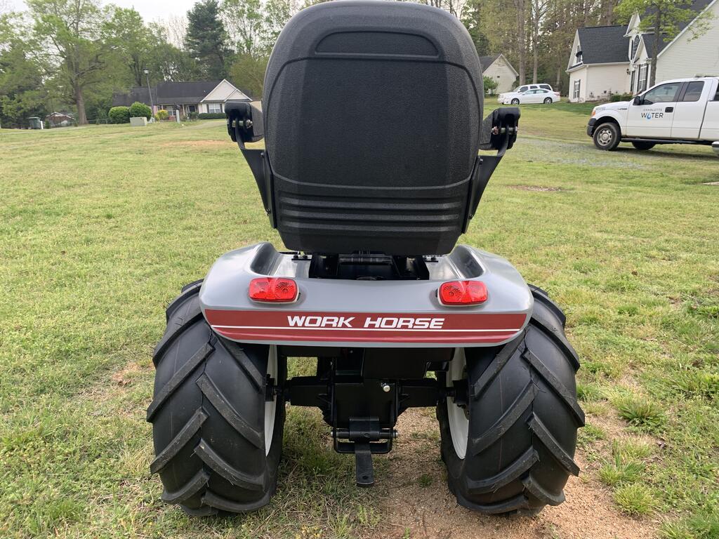

Horse Newbie 7,405 #4 Posted January 20, 2023 I have Hi-Run 23x10.50-12’s on my 1984 Work Horse GT-1600. They work great ! 3 3 Share this post Link to post Share on other sites

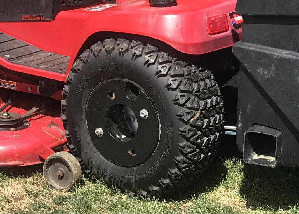

davem1111 2,282 #5 Posted January 20, 2023 Carlisle 23x10.50- 12’s on my GT-1848, liking them a lot so far. 7 1 Share this post Link to post Share on other sites

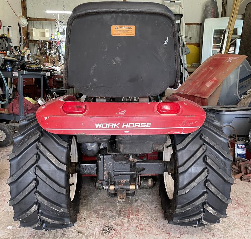

stevebo-(Moderator) 8,741 #6 Posted January 20, 2023 Firestone floatations are very popular with guys that pull using uncut tires. 3 Share this post Link to post Share on other sites

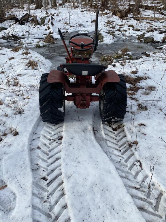

stevebo-(Moderator) 8,741 #7 Posted January 20, 2023 I like these for all all round use. 4 Share this post Link to post Share on other sites
Achto 32,095 #8 Posted January 20, 2023 The Firestone Flotation 23 is most likely the best that there is for traction. Something about their 23 degree angle on the bar tread just works. They are also the most expensive. https://www.millertire.com/23x10-50-12-firestone-flotation-23-tire-4-ply/ Carlisle True Power's would run a close second. I run these on a few of my tractors and have never been disappointed. https://www.millertire.com/23x10-50-12-carlisle-tru-power-4-ply-tire/ Weight and traction go hand and hand on a tractor BUT you can over do things. If you have so much weight and traction that the wheels will not slip, sooner or later something else is going to give. Usually some thing expensive. I've seen guys brag in a plow field that they were having no problems while others were getting stuck. THEN.....they were stuck, with a hand full of broken pieces inside their tranny. 's are tuff little tractors but they are still little tractors, they will last a long time when used with in their limitations. 4 5 1 Share this post Link to post Share on other sites

857lover 291 #11 Posted January 21, 2023 On 1/19/2023 at 7:47 PM, Pullstart said: Whatever ones I’m sitting over top of Honestly, these old ags are hard as a rock and not very deep lugs, but with no added weight, they never disappoint me. definitly like the look on theese 1 Share this post Link to post Share on other sites
