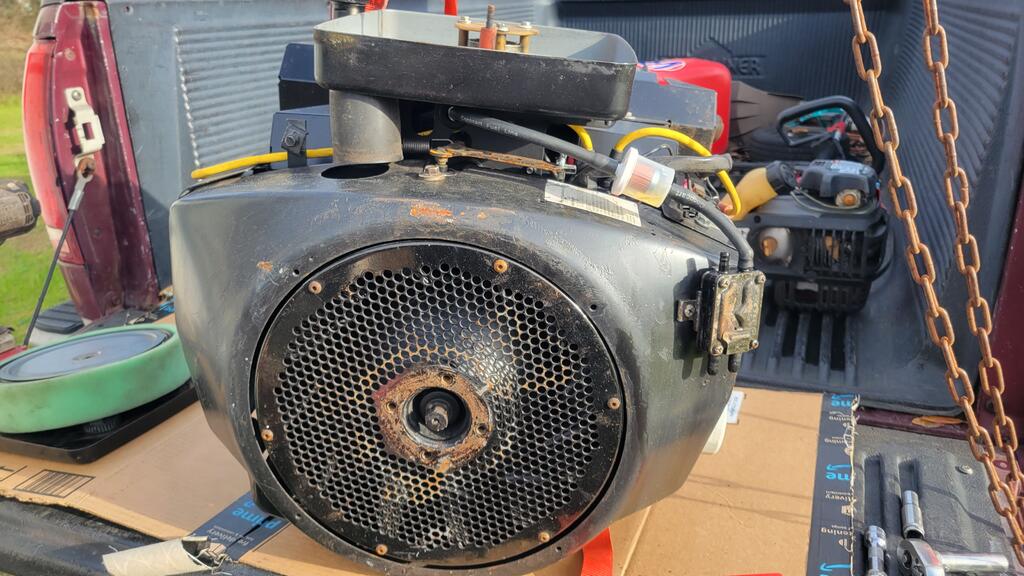

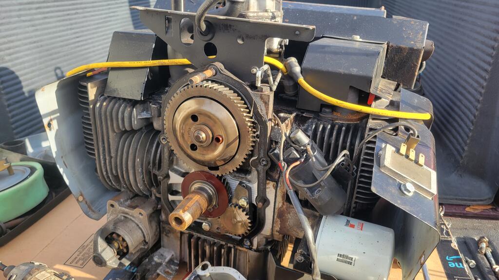

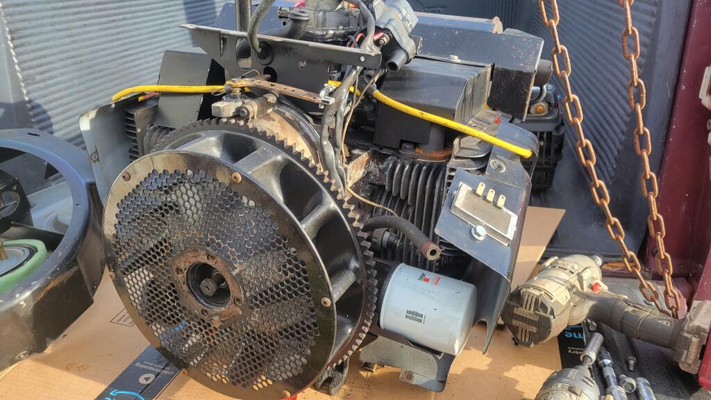

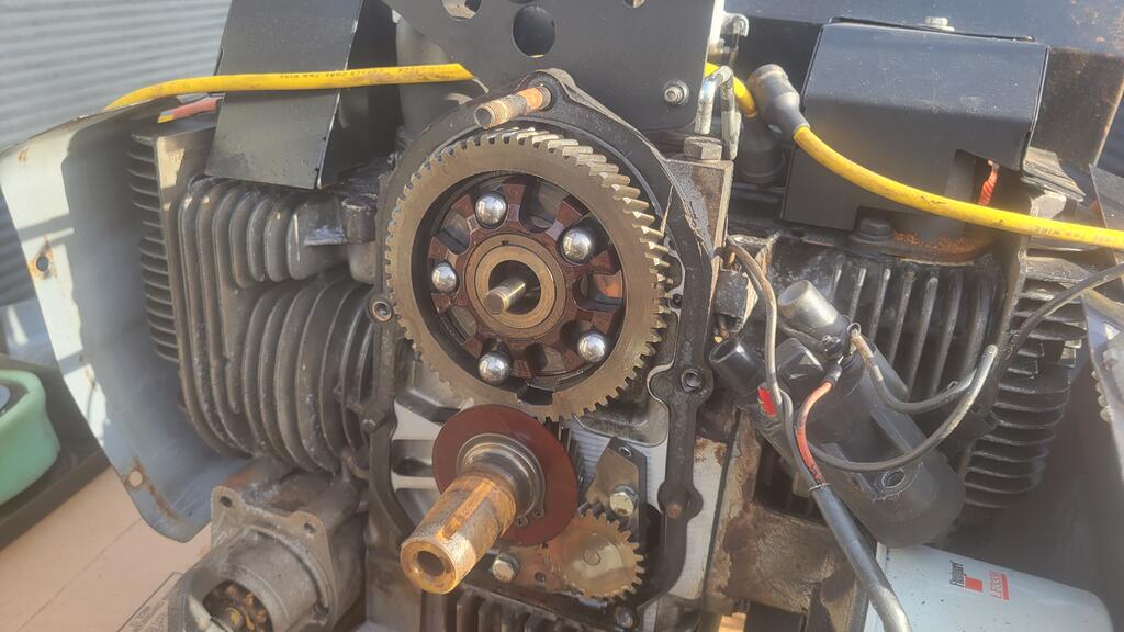

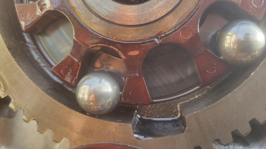

RED-Z06 2,718 #1 Posted January 19, 2023 (edited) Ive done enough of these now its just another task ill be doing to any P series i get before i install the engine into whatever equipment its for or out of. Basically the symptoms are consistent, loses engine speed under load, and runs too fast when the load comes off or the throttle is advanced off idle. The plastic spacer splits and causes this, iSaveTractors has the metal spacers to fix it, i heat my spacers to about 550⁰ and put 638 retaining compound on to add security to it. Its vital that the hole in the disc lines up at 3oclock with the pin in the cover on assembly Edited January 19, 2023 by RED-Z06 2 Share this post Link to post Share on other sites

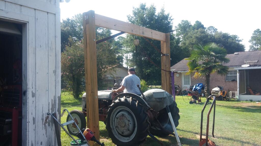

RED-Z06 2,718 #5 Posted January 20, 2023 8 minutes ago, Handy Don said: Man, being able to do the engine work outdoors on the tailgate of pickup is darned impressive! How do you remove the spider that’s on the engine, especially if you’re trying to get on off a parts engine? Once these steel replacements are installed its a permanent fixture. I have a 10ft high gantry next to the shop with a 3000lb chain hoist on it, i roll the tractor under it, unbolt everything, hook the strap around it and lift it up/out. Then i push the tractor back, and back the truck under...set the engine down on the tailgate. Beats bending over and lifting stuff. 1 Share this post Link to post Share on other sites
Handy Don 16,751 #6 Posted January 20, 2023 1 hour ago, RED-Z06 said: I have a 10ft high gantry next to the shop with a 3000lb chain hoist on it, i roll the tractor under it, unbolt everything, hook the strap around it and lift it up/out. Then i push the tractor back, and back the truck under...set the engine down on the tailgate. Beats bending over and lifting stuff. I agree about bending for work and for lifting--those days are g o n e gone! I put a strong point in my garage ceiling for the same purpose. First used when swapping an engine onto a roller. Since then I also got a hydraulic lifting cart (similar to the ½ ton HF model) for much easier access to mowers, blowers, engines, etc. BTW, it’s also fun for giving seated grandchildren a lift! Still curious about how you get a good flyball spider off the camshaft without damaging anything--I have a good one on a parts engine that I’d like to save as a spare. Share this post Link to post Share on other sites
RED-Z06 2,718 #7 Posted January 20, 2023 31 minutes ago, Handy Don said: I agree about bending for work and for lifting--those days are g o n e gone! I put a strong point in my garage ceiling for the same purpose. First used when swapping an engine onto a roller. Since then I also got a hydraulic lifting cart (similar to the ½ ton HF model) for much easier access to mowers, blowers, engines, etc. BTW, it’s also fun for giving seated grandchildren a lift! Still curious about how you get a good flyball spider off the camshaft without damaging anything--I have a good one on a parts engine that I’d like to save as a spare. There really isnt anything to grab onto, the spider comes down nearly flush with the thrust plate on the gear. Tou could try to drill and tap some 1/4-20 holes but its really thin around the hub already. Ive looked into pulling the whole gear. But at $50 a pop for a new spider and you do it once and done...not worth the effort. Share this post Link to post Share on other sites

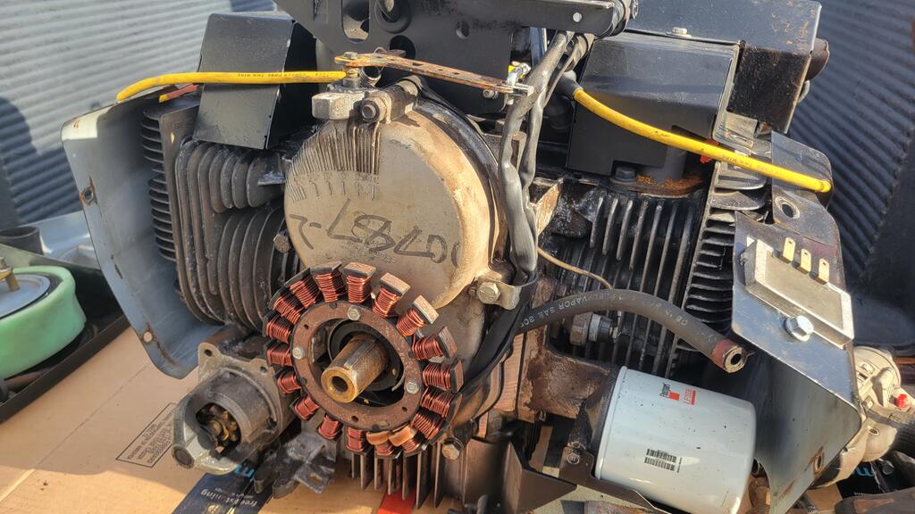

RED-Z06 2,718 #8 Posted January 20, 2023 Wanna know something cool i learned...the magnetic pellet in the ignition pickup, if it pops out you have a 50/50 shot of it going back in right...and if its wrong you have no spark and get to pull it all apart again. 1 Share this post Link to post Share on other sites
Wheelhorse#1 1,902 #9 Posted January 20, 2023 Good work,tip and eyes Im not so sure I would've seen that small crack with my eyes.I don't own any Onan's yet ! Some people swear by them others say they have a lot of problems with them or a particular series not sure ? Share this post Link to post Share on other sites
