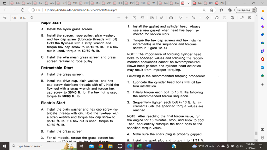

953 nut 68,519 #8 Posted January 19, 2023 Kohler service manual calls for retorque of head bolts, That is good enough for me. 2 Share this post Link to post Share on other sites
