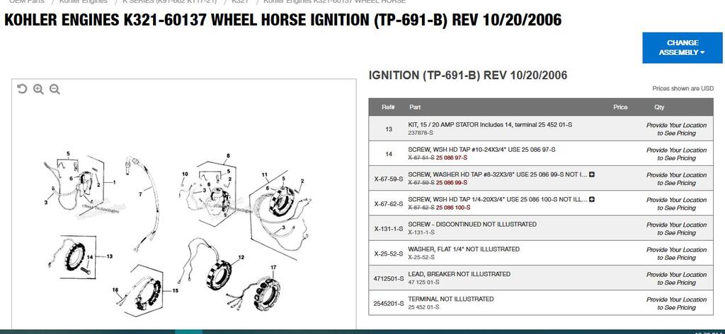

23 Reo 235 #1 Posted January 17, 2023 What size alternator do I have on my 1972 Raider 14 with a K321S-60137A? I am going to put on additional lights for plowing. 1 Share this post Link to post Share on other sites
ebinmaine 79,502 #2 Posted January 17, 2023 That's most likely a 10 or 15 amp alternator but even if it was only a three. You put LED lights on there I think you'd be perfectly fine. 5 1 Share this post Link to post Share on other sites
pfrederi 20,823 #3 Posted January 17, 2023 Kohler says 15 1 2 Share this post Link to post Share on other sites
