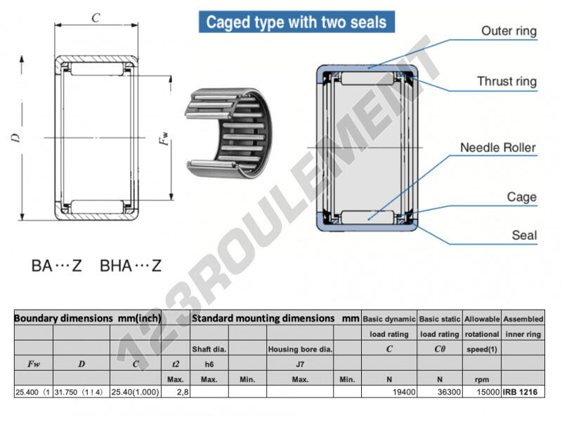

gloubigoulba 87 #26 Posted January 20, 2023 Hi, i suppose the only difference beetwin B and BA bearing is that BA has seals B-2816_IKO.pdf 1 Share this post Link to post Share on other sites
