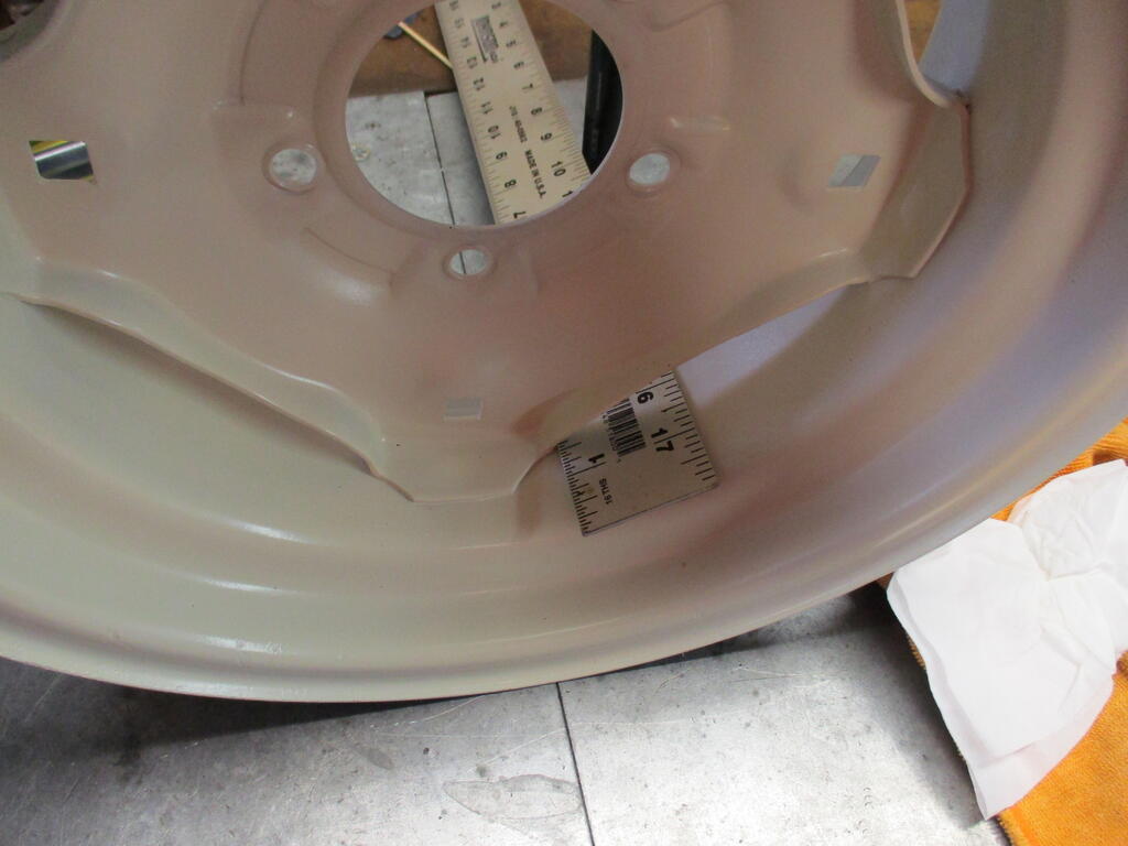

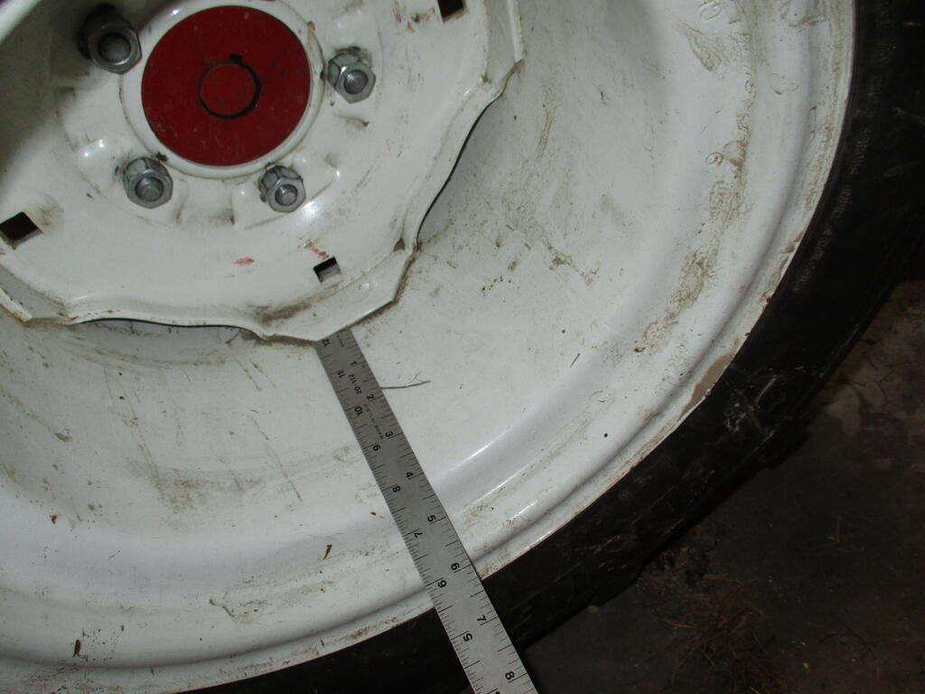

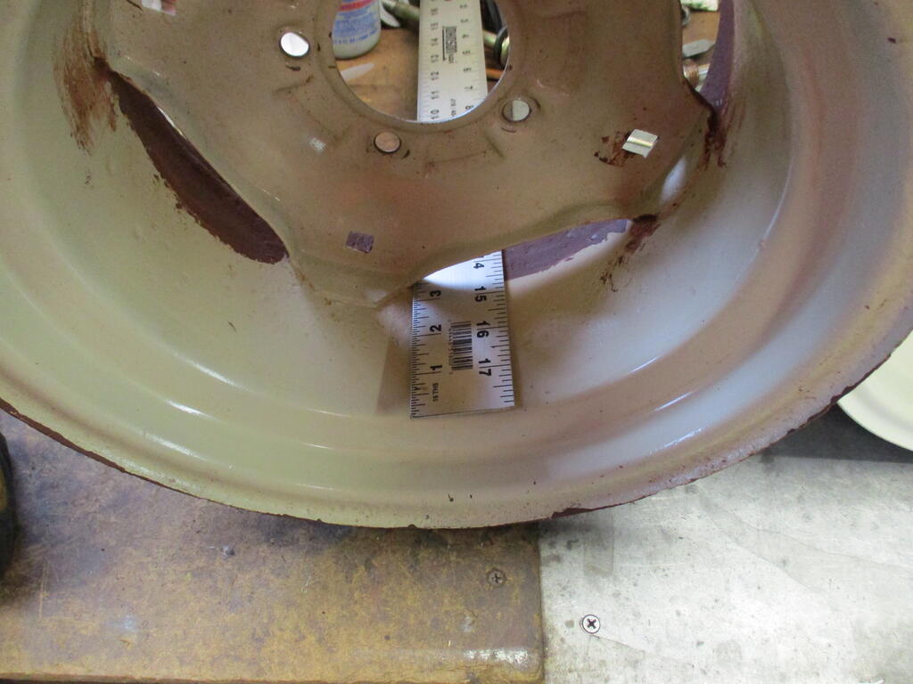

pfrederi 20,866 #7 Posted January 15, 2023 (edited) Most all 300s and 400s had same rim size. 7" They would mount 8.50 9.50 (some entry level early 300s had 5" some late 400s had 8.5)) Easy way to figure out what rim size you have 1st pic about 1" from flange to drop center edge is a 5" rim 2nd pic about 2.5 " from flange edge to drop center edge is 7" rim 3rd pic about 4 " from flange edge to drop center edge is the 8.5" Edited January 15, 2023 by pfrederi 1 Share this post Link to post Share on other sites

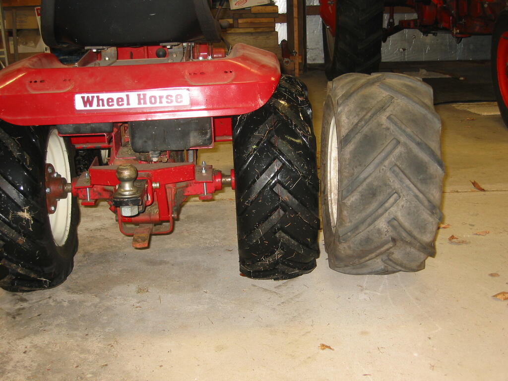

pfrederi 20,866 #8 Posted January 15, 2023 Something else to consider. WH had a habit of using up old stock so sometimes the size listed in parts manuals may not be what was actually put on. also over the years wheels get replaced. Finally the brand of tire makes a difference. Pic shows a Deestone 10.50 on a 7" rim and a Carlisle 10.50 on a 8.5" rim 1 Share this post Link to post Share on other sites
Searcher60 209 #9 Posted January 15, 2023 (edited) 6 hours ago, pfrederi said: Most all 300s and 400s had same rim size. 7" They would mount 8.50 9.50 (some entry level early 300s had 5" some late 400s had 8.5)) Easy way to figure out what rim size you have 1st pic about 1" from flange to drop center edge is a 5" rim 2nd pic about 2.5 " from flange edge to drop center edge is 7" rim 3rd pic about 4 " from flange edge to drop center edge is the 8.5" That is exactly what I was needing to know! Now I know that I have surface rusty 7” Wheels on my 87’ Kohler Mag 416-8. I will assume that 8.5” wheel only came on the 520? And, what is your opinion of putting that 8.5” on the 400 series. The only reason I ask is because I can get a really good deal on them with new tires. Thank you so much! Edited January 15, 2023 by Searcher60 Share this post Link to post Share on other sites
pfrederi 20,866 #10 Posted January 16, 2023 My 310-8 is my mud season tractor. Fat AGs (Carlilse 10.50s) in 8.5" rims., no weights do not want to sink into the mud No clearance issues. just make sure the 8.5 yu get come from a WH. Other guys used 8.5 with more back set they may rub/interfere... 1 Share this post Link to post Share on other sites
