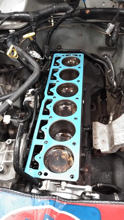

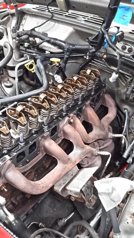

Bill D 2,308 #8 Posted February 13, 2023 (edited) Well, it's alive! Decided to take a chance and put a new head on it. Changed the oil before I changed the head and it still had great oil pressure (30 psi at idle when hot) and no funny noises, so likely no bearing damage. Got the improved TUPY head from a 2004 Grand Cherokee for $200 and had an engine builder friend of mine from work rebuild it for $350. With gaskets and oil I'm in it for about $850. I've got some Seafoam in the oil to help clean up any leftover sludge from coolant/oil mix. Going to run it for about 300 miles then change it again. Currently has Mobil 1 full synthetic, high mileage oil in it. Here's some pictures of reassembly. The last photo is a picture of a TUPY head. The original 0331 head does not have this casting mark. Edited February 13, 2023 by Bill D 2 Share this post Link to post Share on other sites
