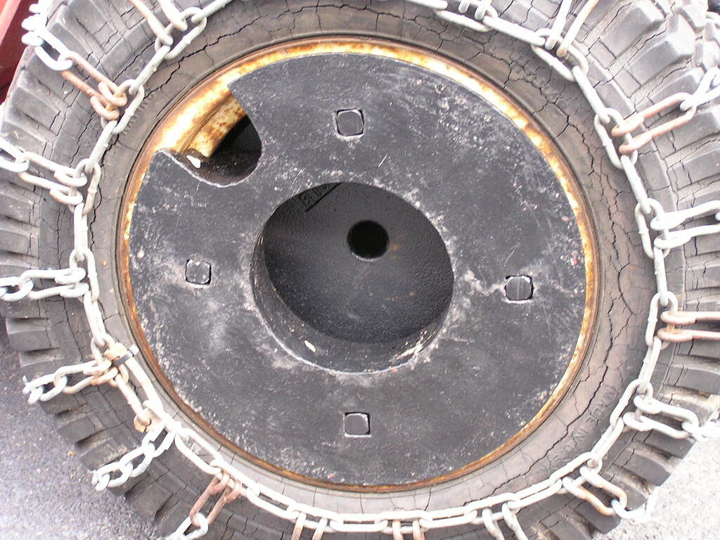

Pullstart 68,534 #2 Posted January 12, 2023 (edited) As for tire width, a skinnier tire applies more psi to the ground. I like the look of a fat tire, but a comparable diameter skinny normally out performs a wide one. As for limited slip, you might find that added weight by means of bolt on weight, wheel weights or fluid filling tires (my favorite) will be enough to get you what you’re looking for. Edited January 12, 2023 by Pullstart 2 Share this post Link to post Share on other sites
ri702bill 10,642 #3 Posted January 12, 2023 7 minutes ago, Pullstart said: added weight by means of bolt on weight, wheel weights or fluid filling tires (my favorite) will be enough to get you what you’re looking for. Absolutely - agree with the last two choices unless you have to add even more for the task at hand. I prefer to add weight to the wheels themselves, not up on the hitch - better for the Unidrive outer bearings. Share this post Link to post Share on other sites
