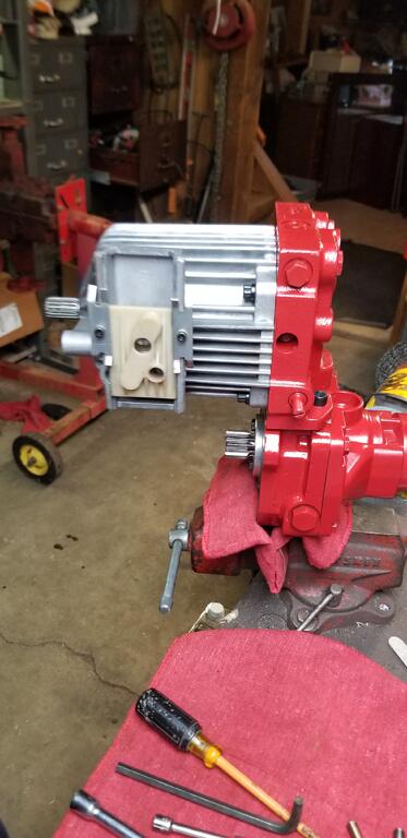

gt14rider 1,283 #30 Posted January 11, 2023 The body core is the same on gt14, pn# 7200. Little history on the tractor, got it on the cheap, it would roll a couple of feet and stop,( not running ) push back sum and would roll a few feet stop, when I pulled it apart found a small shop rag all ripped up in transmission. Someone was in there before, changed out bolts and lock nuts. Rebuilt the piston to piston pump. Will try and get parts to fix this on 1 2 Share this post Link to post Share on other sites

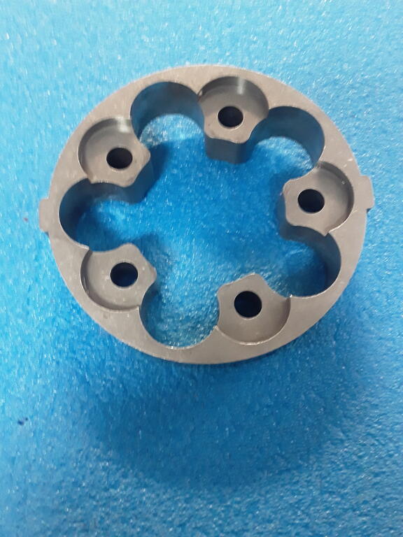

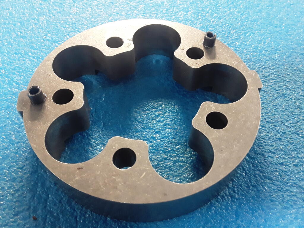

lynnmor 9,073 #39 Posted January 12, 2023 I wonder if the crack could be caused by the bolts being too loose. In order to crack, it appears that the part must be spread by shifting under the bolt head a bit. The bolts wouldn't need to be very loose, just enough to allow a small amount of movement under the considerable torque present there. 1 Share this post Link to post Share on other sites
ebinmaine 81,145 #40 Posted January 12, 2023 3 minutes ago, lynnmor said: I wonder if the crack could be caused by the bolts being too loose. In order to crack, it appears that the part must be spread by shifting under the bolt head a bit. The bolts wouldn't need to be very loose, just enough to allow a small amount of movement under the considerable torque present there. I can see the logic in that. I don't almost go so far as to say that the bolts and locking nuts for those in any Wheel Horse transmission should be single use only. 1 Share this post Link to post Share on other sites

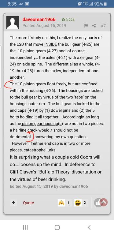

gt14rider 1,283 #41 Posted January 14, 2023 Found this from @daveoman1966 So what do you think of using locktite 680 retaining compound on the crack, the body core is in side bull gear, new bolts and lock nut 1 Share this post Link to post Share on other sites
ebinmaine 81,145 #42 Posted January 14, 2023 So basically that's a "super glue" to hold the crack together? Seems like it would work as long as the crack itself doesn't impede the movement of that differential pinion gear. Share this post Link to post Share on other sites

JimSraj 590 #47 Posted January 16, 2023 The body in the diff of the 6 speed from my 1267 did the same thing. Pinions showed a considerable amount of wear and the circular spring that holds them in has grooves worn into it. Got another six speed that I had hoped to just swap into the tractor but that trans needs help too so hoping to make one good one from the two with minimal ordered parts. I’m just getting back to that project. Need to revisit stevesaurus video first though. 1 Share this post Link to post Share on other sites
jeremi3210 759 #48 Posted January 23, 2023 Almost every 10 pinion I've ever had apart was cracked like that one. I replace them with 8 pinions. 1 Share this post Link to post Share on other sites
ebinmaine 81,145 #49 Posted January 23, 2023 8 hours ago, jeremi3210 said: Almost every 10 pinion I've ever had apart was cracked like that one. I replace them with 8 pinions. I can certainly understand the thought process of using an 8 pinion given that they're so much more rugged. Of Trina's 60s Herd there'll be 3 with these 10 pinion Limited Slip Differentials. She's not a large person like me 🐻 and she also doesn't run as much tractor weight as I do and she's very careful about abusing machinery... so I'll likely leave them all as is with little concern for breakage. She needs all the help available to her for traction. I thought about putting an LSD in my C160 Automatic but decided to stay with the more robust 8 pinion even though it's an open diff. That tractor will be VERY heavy for a Wheelhorse. Any thoughts on ways to increase traction from an 8 speed or have you always just added more weight to the tractor like I've been? Share this post Link to post Share on other sites
Lee1977 7,809 #50 Posted January 23, 2023 On 1/14/2023 at 8:50 AM, gt14rider said: Found this from @daveoman1966 So what do you think of using locktite 680 retaining compound on the crack, the body core is in side bull gear, new bolts and lock nut Basically. just a bad design a little wear and loose pinions most likely caused the crack. They did away with the center piece held the pinions in the end plates with 4 bolts holding the 8 pinion together 1 Share this post Link to post Share on other sites
