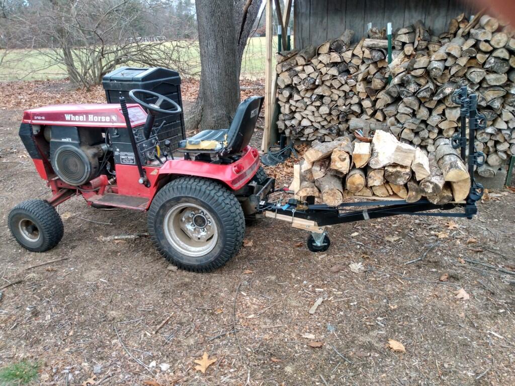

CCW 1,519 #1 Posted January 10, 2023 (edited) So if you followed my "Proof of Concept" thread you would have seen my thought process on the hauler pictured below. In this photo I tested the system by loading it with firewood. Move began okay, but ultimately failed because the single dolly wheel is both too small and narrow to handle any real weight on the lawn and the system did not have good balance and finally tipped the load of wood on the ground. Digging around the parts pile in my shop came across to old snow blower tires and a steel rod. Onto idea number two building a small little trailer to do the job with. Much more traditional and I do not expect any problems with it. Edited January 10, 2023 by CCW 3 Share this post Link to post Share on other sites
ebinmaine 80,929 #2 Posted January 10, 2023 Two of those dolly wheels and at the back. ...? Share this post Link to post Share on other sites
SylvanLakeWH 32,695 #3 Posted January 10, 2023 or just tip a dolly and attach... insta trailer... Share this post Link to post Share on other sites
CCW 1,519 #4 Posted January 10, 2023 1 hour ago, ebinmaine said: Two of those dolly wheels and at the back. ...? I have a couple of snowblower tires that will work better. 57 minutes ago, SylvanLakeWH said: or just tip a dolly and attach... insta trailer... Major consideration is the terrain that this will be used on. Plus you know how we all seem to like to cogitate, design, build and test some crazy ideas. How we learn. 2 Share this post Link to post Share on other sites
