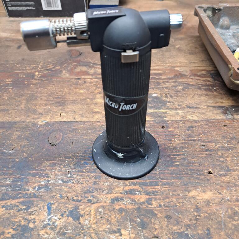

WHX?? 57,641 #9 Posted January 10, 2023 (edited) I'm with with the soldering crew. Nothing against crimping with the proper tool and on the job every thing was crimped due to time & ease. In the tractor shop I remove the insulator if it has one, solder then shrink. Most of my soldering is done with a HF cheapy micro torch. Edited January 10, 2023 by WHX?? 7 Share this post Link to post Share on other sites

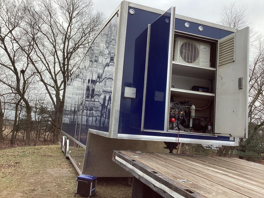

Pullstart 70,999 #12 Posted January 10, 2023 (edited) In my wiring job today, I used a few of these for some 6 gauge wire. I put a piece of heavy duty heat shrink tubing on either wire just past the stripped end, then slid a larger heat shrink tube over a wire and assembled… then heat shrinked the splice as well. It’s in a breaker box, and I wanted to be sure the wires couldn’t touch each other. Edited January 11, 2023 by Pullstart Never posted the picture 3 Share this post Link to post Share on other sites

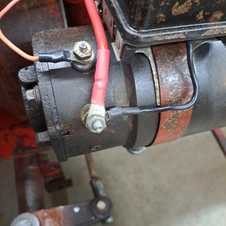

grinchsr 674 #15 Posted January 11, 2023 I have a beat up 416 with an Onan. I am making the 9 pin go away. I know I can buy a connector and the pins but like I said it is beat up. It lived in Rutland VT under a cover sometimes and sometimes not 1 Share this post Link to post Share on other sites

Pullstart 70,999 #18 Posted January 11, 2023 14 hours ago, WHX?? said: hope telling us you soldered it first? I updated with a picture. This was in a breaker box in an enclosed trailer. Share this post Link to post Share on other sites

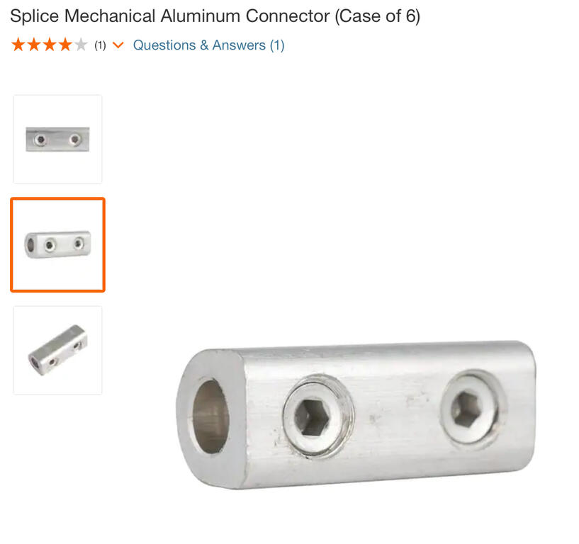

Handy Don 17,191 #19 Posted January 11, 2023 3 hours ago, Pullstart said: Aluminum works just fine as long as the electrical connection is very solid and does’t generate heat that can cause loosening via thermal expansion/contraction. 1 Share this post Link to post Share on other sites
Pullstart 70,999 #20 Posted January 11, 2023 @Handy Don come to think of it, I used steel - I just found a picture of aluminum 1 Share this post Link to post Share on other sites
