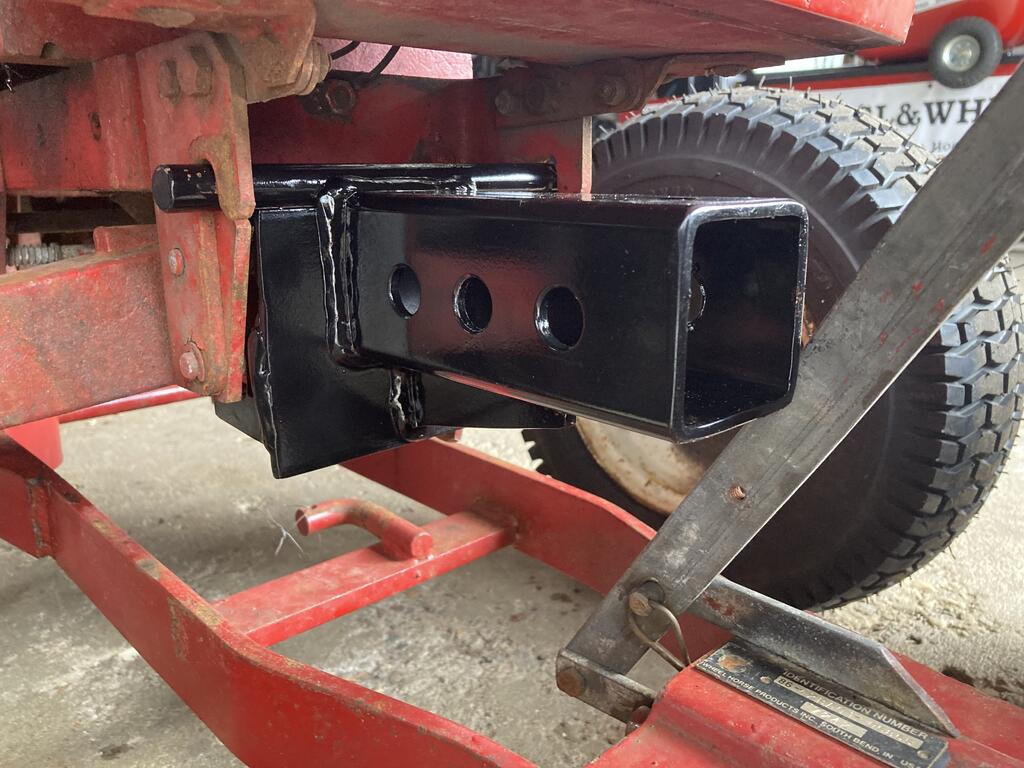

SylvanLakeWH 32,695 #2 Posted January 9, 2023 That's pretty nice! Here's mine... simple but gets it done.., 5 2 Share this post Link to post Share on other sites

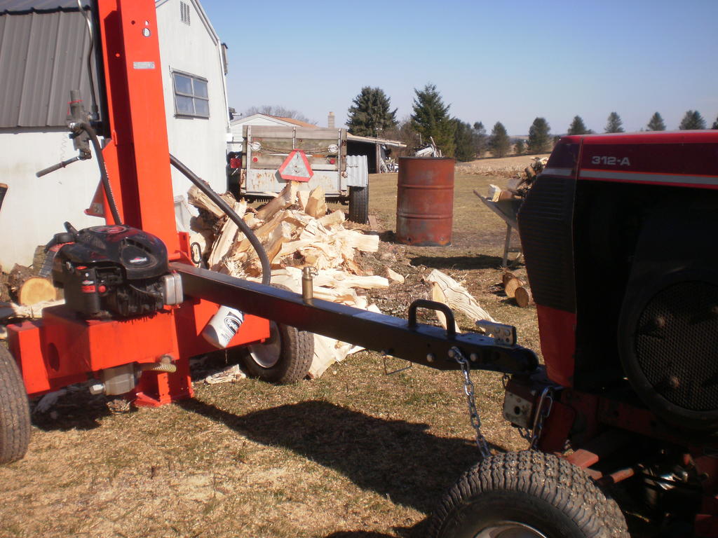

Achto 32,843 #4 Posted January 10, 2023 Nice ideas!! Only front hitch in my herd came on the high performance Ranger that I bought last fall. 2 Share this post Link to post Share on other sites
Handy Don 17,560 #5 Posted January 10, 2023 (edited) @Achto What a forlorn looking beast! Is that a K161 stuffed in there? Digging the segmented mower belt, too. Edited January 10, 2023 by Handy Don Share this post Link to post Share on other sites

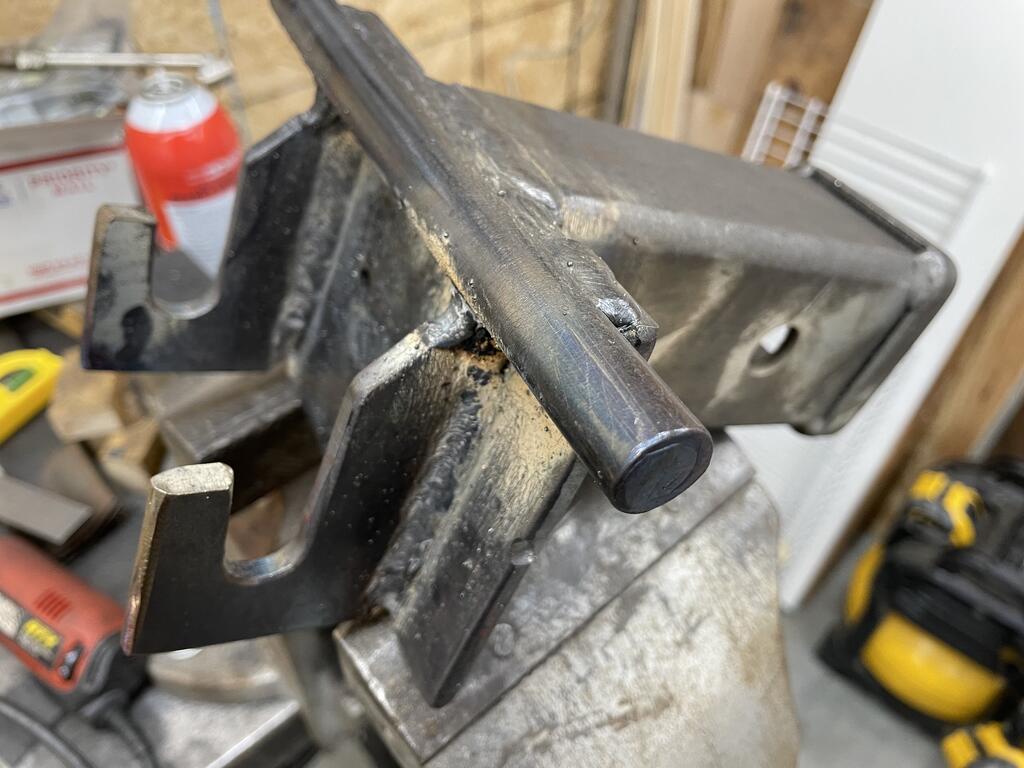

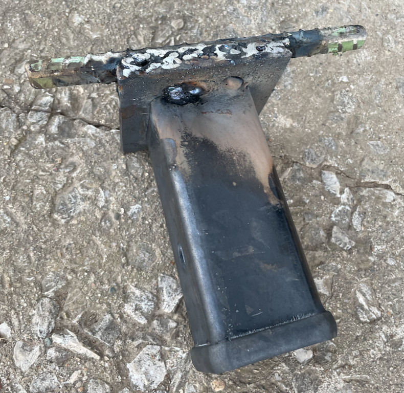

davem1111 2,395 #12 Posted January 10, 2023 21 hours ago, SylvanLakeWH said: That's pretty nice! Here's mine... simple but gets it done.., I wanted one of these and saw them on Flea-Bay for about $75 plus about $25 shipping but didn't want to spend that much, so I built my own from a $15 receiver tube, a few plates of metal and a piece of rebar I had laying around. I have a spare front Tach-A-Matic receiver that I'm going to modify to put in place of the stock hitch on the back, then I can mount this hitch back there. I built a battery box/winch attachment on a 2" insert, which then I can mount on either the front or the back. I also have ideas to make a boom for lifting things, and I have a 2" cargo tray I can mount on there also. It really adds to the versatility of the tractor. 2 1 Share this post Link to post Share on other sites
ebinmaine 80,929 #13 Posted January 10, 2023 2 minutes ago, davem1111 said: I wanted one of these and saw them on Flea-Bay for about $75 plus about $25 shipping but didn't want to spend that much, so I built my own from a $15 receiver tube, a few plates of metal and a piece of rebar I had laying around. I have a spare front Tach-A-Matic receiver that I'm going to modify to put in place of the stock hitch on the back, then I can mount this hitch back there. I built a battery box/winch attachment on a 2" insert, which then I can mount on either the front or the back. I also have ideas to make a boom for lifting things, and I have a 2" cargo tray I can mount on there also. It really adds to the versatility of the tractor. Great stuff Dave and all of them better get pictures when built or @SylvanLakeWH will be notified. 🚓 1 Share this post Link to post Share on other sites

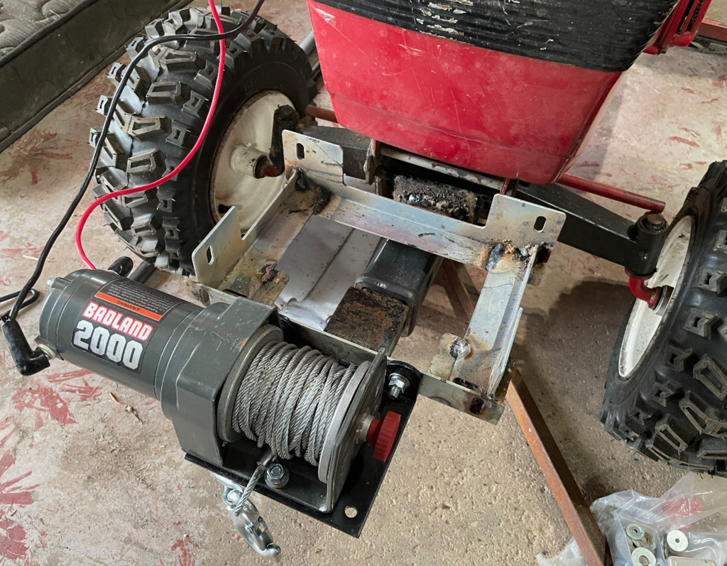

davem1111 2,395 #14 Posted January 10, 2023 3 minutes ago, ebinmaine said: Great stuff Dave and all of them better get pictures when built or @SylvanLakeWH will be notified. 🚓 I thought I posted some already, but maybe I forgot... This is just the receiver, plate, and rebar spot welded in place, no "ears" for the bottom bar yet. My welds are ugly, but I've pulled out some pretty big logs with the winch on this already: 1 1 2 Share this post Link to post Share on other sites
Handy Don 17,560 #15 Posted January 10, 2023 38 minutes ago, davem1111 said: My welds are ugly, but I’ve seen worse...mine! 1 Share this post Link to post Share on other sites

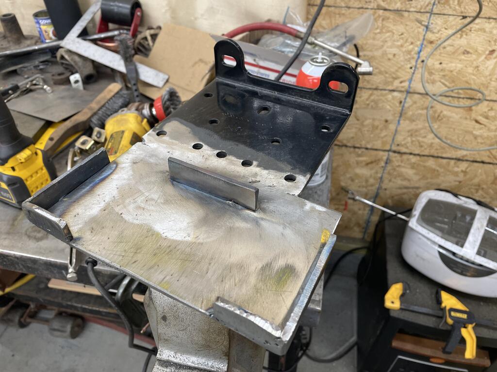

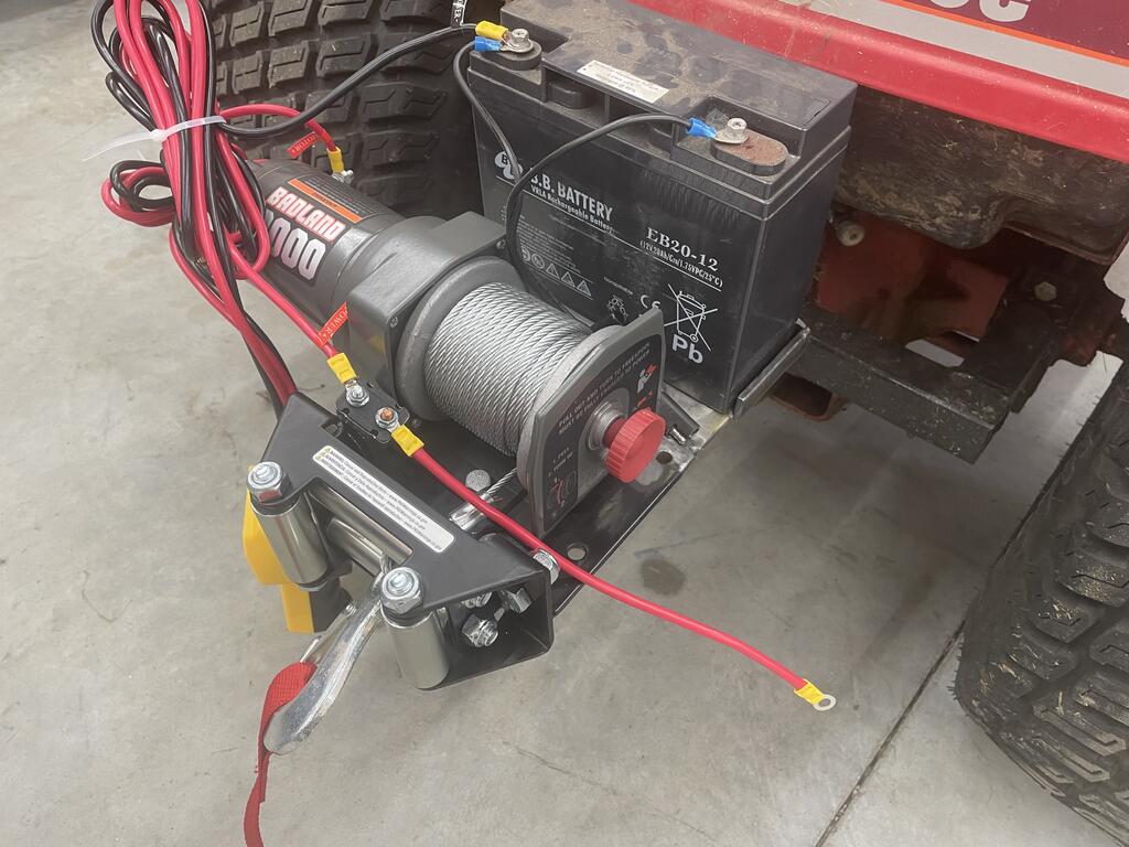

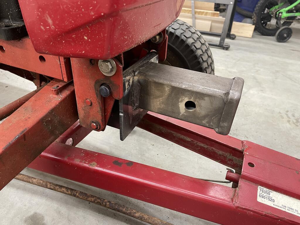

OoPEZoO 618 #16 Posted January 10, 2023 Here is mine......I built it over the holidays because I was bored. All made from scrap steel except the receiver tube. I still want to put some quick disconnects on the wire connections, figure out a battery hold down solution, and I need to wait until warmer weather to paint it, but it will work if I need it until then. My main goal was to be able to swap the winch/battery assembly from the front of the tractor, to the back, and also to the tongue of my utility trailer so I could use it to pull things up onto the trailer. 4 Share this post Link to post Share on other sites
Handy Don 17,560 #17 Posted January 10, 2023 7 minutes ago, OoPEZoO said: All made from scrap steel except the receiver tube. You have an exceptionally rich scrap steel source! Nice work, especially adding the low braces to keep pressure off the hitch locking bar. Share this post Link to post Share on other sites
davem1111 2,395 #18 Posted January 10, 2023 14 minutes ago, OoPEZoO said: Here is mine......I built it over the holidays because I was bored. All made from scrap steel except the receiver tube. I still want to put some quick disconnects on the wire connections, figure out a battery hold down solution, and I need to wait until warmer weather to paint it, but it will work if I need it until then. My main goal was to be able to swap the winch/battery assembly from the front of the tractor, to the back, and also to the tongue of my utility trailer so I could use it to pull things up onto the trailer. SWEET!! Much nicer than mine. And like @Handy Don said, nice collection of scrap. (I've been keeping my eye open for freebies but haven't scored any lately, guess I need to buy some). Yeah, I'm planning to do the quick disconnects thing, front & back, a more "integrated" switch for the winch, and I think I've got the hold down figured out but haven't installed it yet. Not sure if you saw what I mentioned about the Tach-A-Matic, but you can get one of those front ones for not too much money. I have one already and I'm going to adapt it for the rear hitch so I can move the 2" receiver back there. I hope, anyway. . If I had a utility trailer, I'd want to be able to mount it on there too. The reason I first bought this winch was to get a non-running car onto a U-Haul flatbed trailer. It pulled a 1992 Porsche 924 with a stuck rear brake drum up there. Strained, but made it. 1 Share this post Link to post Share on other sites
OoPEZoO 618 #19 Posted January 10, 2023 (edited) 19 minutes ago, Handy Don said: You have an exceptionally rich scrap steel source! Nice work, especially adding the low braces to keep pressure off the hitch locking bar. Thanks.....and yes I do. I'm lucky to have access to pretty much an unlimited supply of plate steel in random shapes, sizes, and thicknesses 1/4" and less. Most of it is painted, but nothing a flap wheel or two can't handle. Its crazy how expensive materials have become. I make the rounds past every scrap bin at work on a weekly basis to make sure nothing goes to waste. Also.....check your local scrap yards/recycling centers. We have a good one here that sells scrap steel by the LB. Pick out what you want, weigh it, pay, and walk out. I VERY rarely buy steel retail anymore unless its something specific. Edited January 10, 2023 by OoPEZoO 2 1 Share this post Link to post Share on other sites

peter lena 10,089 #24 Posted January 11, 2023 @OoPEZoO looking right at it ? opportunity your female front mount hitch end , relation to the bolt hole on the plow frame ? put an eye bolt in that , and a lift spring to your hitch end, adaptor , spring pull should only enhance blade lift , your scrap steel / weld skills , can easily envision a hook up . maybe even an angular slide in lift point for a heavier / larger spring ? you are right there , pete Share this post Link to post Share on other sites
Handy Don 17,560 #25 Posted January 11, 2023 27 minutes ago, peter lena said: @OoPEZoO looking right at it ? opportunity your female front mount hitch end , relation to the bolt hole on the plow frame ? put an eye bolt in that , and a lift spring to your hitch end, adaptor , spring pull should only enhance blade lift , your scrap steel / weld skills , can easily envision a hook up . maybe even an angular slide in lift point for a heavier / larger spring ? you are right there , pete Of course, adding spring assist to the lift also reduces the down pressure on the plow scraper edge so this becomes a balance between comfort and performance! 1 Share this post Link to post Share on other sites
