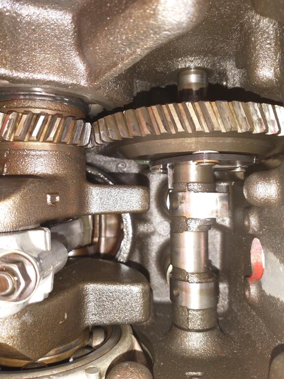

squonk 48,324 #27 Posted January 9, 2023 So If you weren't planning on changing the rings and honing it, Why did you even take it apart? Share this post Link to post Share on other sites
ebinmaine 81,139 #28 Posted January 9, 2023 5 minutes ago, squonk said: So If you weren't planning on changing the rings and honing it, Why did you even take it apart? Originally to check the balance gears which were loose so I'm REALLY glad I took them out. While I was in there I figured I would pop the rod cap off just to see how the inside of that looked. 1 1 Share this post Link to post Share on other sites
squonk 48,324 #29 Posted January 9, 2023 If the gears were loose the engine is loose too. I had small amount of wobble in my K341 gears and when it was torn down the crank and bore were out of round, piston skirt was broken and the guides were shot. You engine may run forever, but don't be surprised if it doesn't. Hate to see another 16 get ruined. 2 Share this post Link to post Share on other sites

ebinmaine 81,139 #33 Posted January 9, 2023 13 minutes ago, squonk said: If the gears were loose the engine is loose too. . Hate to see another 16 get ruined. No worries Mike. Somebody's standard bore rebuilt this one in the past. It has a newer piston, rings, rod, and the cross hatch is still very evident in a lot of the cylinder bore. My experience shows most people don't touch the balance gears. I checked with the two local small engine repair shops I would normally deal with and neither one of them has ever changed the balance gear set. That's not a huge surprise for one of the places because the guy is only about 30 or 35 years old... but the other place has been in business 30 or 40 years. One of the technicians used to work at a Toro dealer and both of the guys there used to handle these Kohler singles on a very regular basis. I was quite surprised when they told me they hadn't handled them but I guess when you think about it they're 30 years old at the newest now so they're sort of off the radar screen as usable machines to most folks. Believe me when I tell you I feel the same as most of the folks on this site about keeping this old iron alive. If I wasn't reasonably confident that this engine was going to last a few more years I wouldn't put it together as a runner. I have two other Kohler 16 HP engines that I know are loose and I also know they run. I won't use either one of them until they're bored over and rebuilt with new parts. . 2 Share this post Link to post Share on other sites

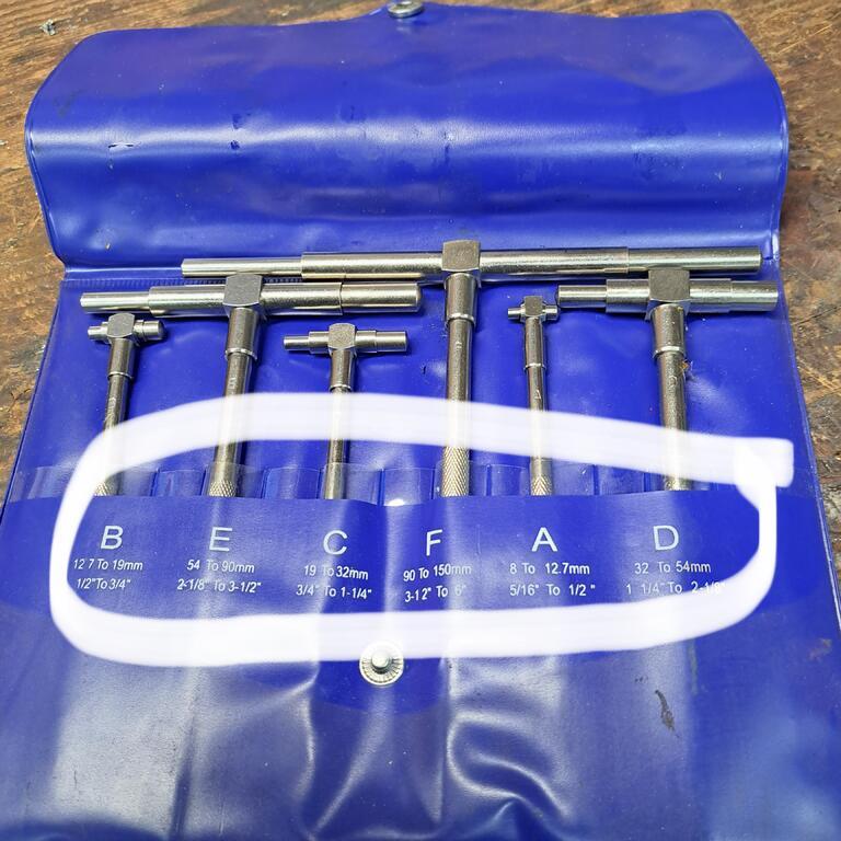

ebinmaine 81,139 #36 Posted January 9, 2023 10 hours ago, Achto said: Some thing to add to your arsenal one day. Maybe not the best quality sets if you are a machinist, but they will be good enough to let you know what's going on & what you need for parts. https://www.harborfreight.com/search?q=telescoping bore gauge https://www.vevor.com/outside-micrometers-c_10820/vevor-outside-micrometer-premium-precision-carbide-tips-machinist-tool-0-4--p_010689764898?utm_source=google&utm_campaign=18457895227&utm_term=&gclid=EAIaIQobChMI1OuP8bG6_AIVhxfUAR0I8gmzEAQYBSABEgLkV_D_BwE&v_tag=7ec532d0-9011-11ed-ac31-9daacb9ce42b.1 Thanks for the links. I have a set of mics. Might have to get a set of bore gauges.... 1 Share this post Link to post Share on other sites
WHX?? 58,347 #37 Posted January 9, 2023 I got a set in the jungle for the about the same price and right to my door. Good enough for the hobbyist... Now just to figure out how to use them! 1 1 Share this post Link to post Share on other sites
pacer 3,181 #38 Posted January 9, 2023 (edited) 44 minutes ago, WHX?? said: how to use them! Pretty simple, select the proper size ( (the 'E' will cover most of out stuff) slip it into the cyl at a slight angle and gently move it til its straight across and gently tighten it, pull it out with it locked in that setting and use the mic to measure that. I generally do 4-5 readings in different areas of the bore. The reading in the pic was in a K241, notice the reading is at dead straight across at 3.25 which is factory bore and the other is the crank measuring at 1.49 wear (std is 1.50) -- That was a remarkable little engine for that little wear! Edited January 9, 2023 by pacer 1 1 Share this post Link to post Share on other sites

WHX?? 58,347 #44 Posted January 10, 2023 (edited) 1 hour ago, pacer said: and use the mic to measure that. Thanks Pacer... I was using calipers not a mic ... it that my down fall? I tried measuring some Onan bores like this and wrote down all the numbers. Gave the block to @Achto and he measured it ovaled which i did not see. I trust Dan more than my toes so the block went on the shelf. I was ok at algebra but 1+1 aways = 3... Edited January 10, 2023 by WHX?? 1 Share this post Link to post Share on other sites
lynnmor 9,073 #45 Posted January 10, 2023 (edited) 1 hour ago, WHX?? said: I got a set in the jungle for the about the same price and right to my door. Good enough for the hobbyist... Now just to figure out how to use them! The way I was taught to use them 59 years ago is as follows: Choose the appropriate size. Put a drop of oil on each contact area. Insert the gage in the bore and have it at a slight angle. Slightly tighten the clamping screw., it too should have a drop of oil on the inside end. Rock the gage over center one time so that it compresses to bore size. Continued rocking can only collapse it too far. Mike the gage to find the highest reading, being mindful of the not so tight screw. Lather, Rinse, Repeat till you get consistent readings. Trying to find the exact perpendicular contact points by eye ain’t gonna happen. Always store the gages at their largest position so the spring isn’t collapsed. This just in, calipers have no place in engine work. Edited January 10, 2023 by lynnmor 1 2 Share this post Link to post Share on other sites
WHX?? 58,347 #46 Posted January 10, 2023 7 minutes ago, lynnmor said: This just in, calipers have no place in engine work. Whats the theory behind this? Guess I'll be following Dan's link.. Like @953 nut always says let the shop tell you but always nice to know what yer up against. 1 1 Share this post Link to post Share on other sites
lynnmor 9,073 #47 Posted January 10, 2023 You cannot get accurate measurements with calipers. Many will tell you otherwise, and I have worked with those and seen their work. When measuring a bore, there is no way to get a reading down in where it matters. The contact points of a caliper are flat, how would you measure with flat surfaces contacting round surfaces? To me, a caliper is a quick check device to get a rough measurement. Share this post Link to post Share on other sites
ebinmaine 81,139 #48 Posted January 10, 2023 13 minutes ago, lynnmor said: To me, a caliper is a quick check device to get a rough measurement. Pretty much what I was always told. Share this post Link to post Share on other sites
WHX?? 58,347 #49 Posted January 10, 2023 20 minutes ago, lynnmor said: a caliper is a quick check device to get a rough measurement. Exactly what I would/was aiming for ... let the machine shop figure out the details. 1 1 Share this post Link to post Share on other sites
