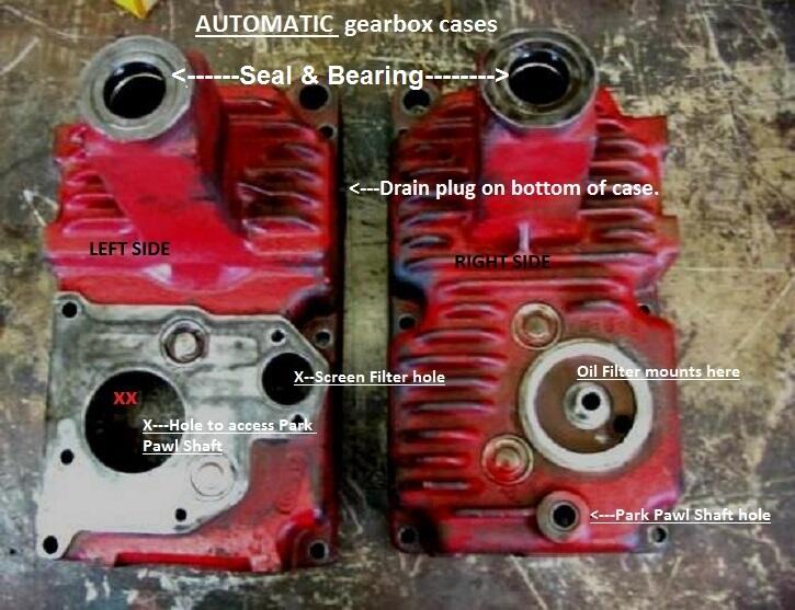

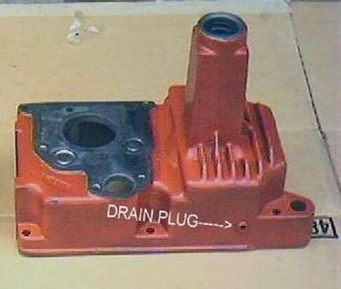

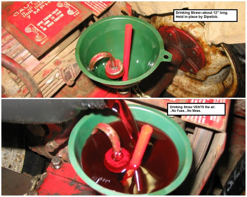

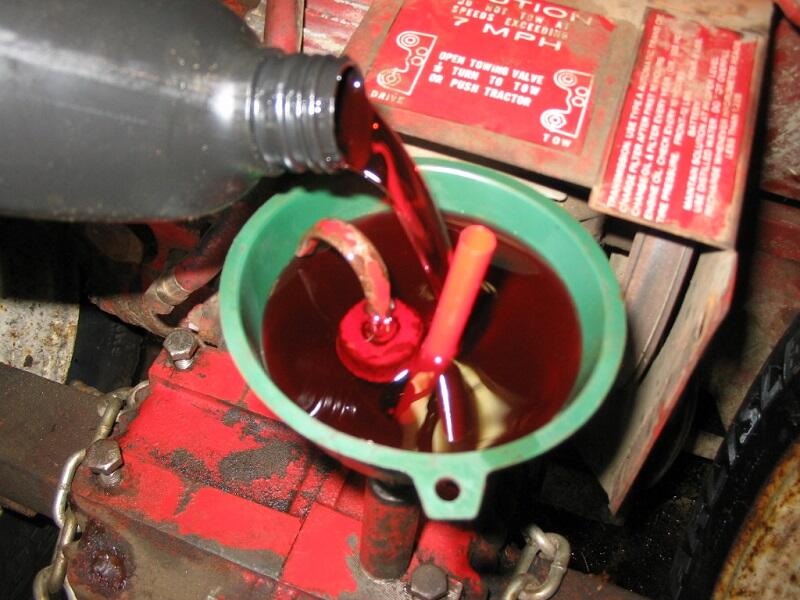

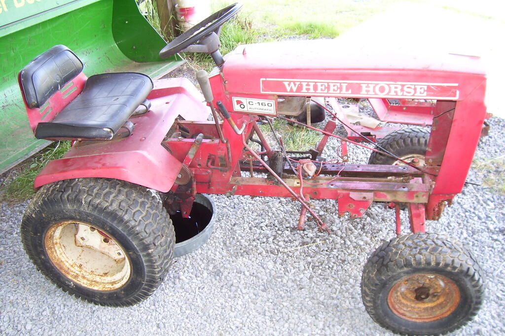

daveoman1966 3,882 #2 Posted January 6, 2023 Remove the HEX plug on the trans case bottom. Replace it...change the filter, then use this no-spill method to refill... Don't over-fill it as the fluid will foam up resulting in poor performance. Run it for a little while, then recheck fluid lever...DO NOT OVERFILL. 3 2 2 Share this post Link to post Share on other sites

ebinmaine 77,507 #4 Posted January 6, 2023 13 minutes ago, Joker72 said: transaxle/hydro fluid Should be standard issue 10w30 engine oil in there. General consensus on the filter is use a Wheelhorse/Toro brand or get a wix 51410 which is a NAPA Gold 1410. I'd recommend installing a magnetic drain plug. 8 minutes ago, daveoman1966 said: then use this no-spill method to refill Dave AWESOME write up and fast. Neat idea on the funnel/straw. 2 1 Share this post Link to post Share on other sites
