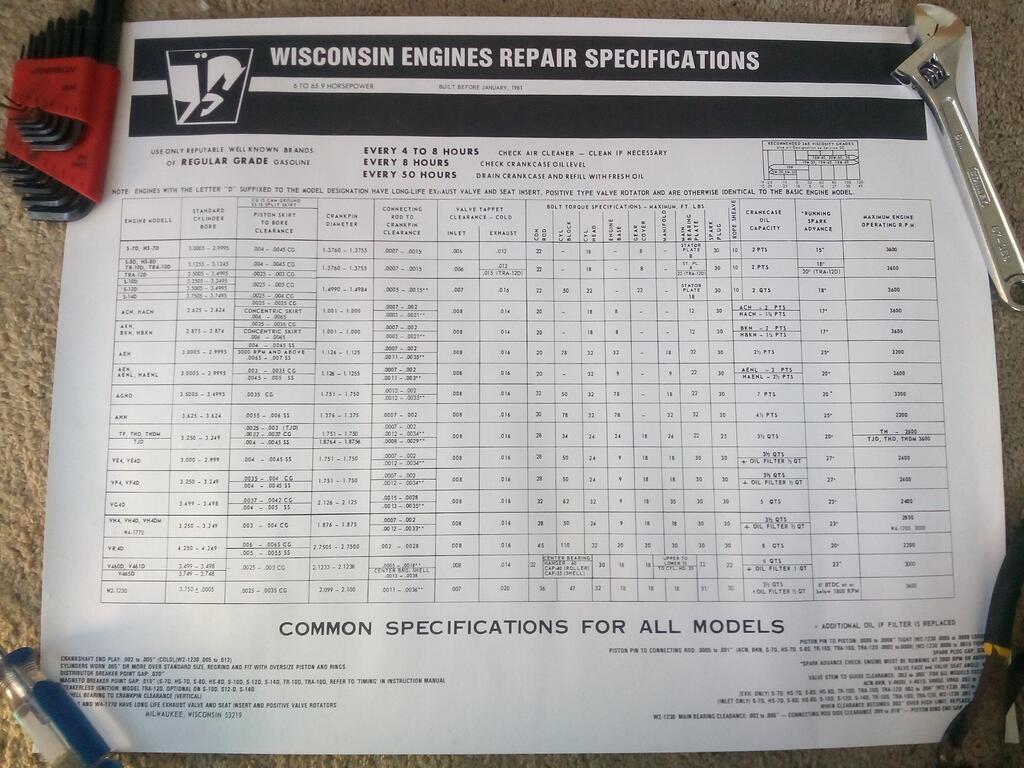

oliver2-44 11,791 #35 Posted January 8, 2023 On 1/5/2023 at 4:34 AM, Tonytoro416 said: My 1945 Wisconsin ADH is rated 3.9Hp@2600 RPM. It looks similar in size, but their hard to tell by size. It has a 2.750 bore and 3-1/4" stroke. So about the bore of a 7 hp K161 but the stroke of a 16 hp K341. Wisconsin doesn't list compression numbers, but I'm told my engine runs about 60-65psi, low by todays standard. Some of the Gibson "D" tractors used the ADH engine. The table below gives specs on a lot of Wisconsin engines. 1 1 Share this post Link to post Share on other sites
WHGuy413 2,859 #36 Posted January 8, 2023 What a great story. It’s great seeing tractors that have progressed throughout a family over the years. I look forward to following your progress on it. 2 Share this post Link to post Share on other sites
Tonytoro416 1,393 #37 Posted January 8, 2023 11 hours ago, oliver2-44 said: My 1945 Wisconsin ADH is rated 3.9Hp@2600 RPM. It looks similar in size, but their hard to tell by size. It has a 2.750 bore and 3-1/4" stroke. So about the bore of a 7 hp K161 but the stroke of a 16 hp K341. Wisconsin doesn't list compression numbers, but I'm told my engine runs about 60-65psi, low by todays standard. Some of the Gibson "D" tractors used the ADH engine. The table below gives specs on a lot of Wisconsin engines. This is awesome. Thank you 2 Share this post Link to post Share on other sites

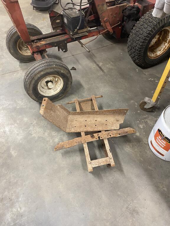

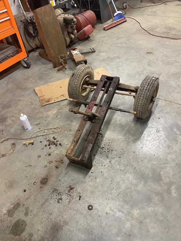

Tonytoro416 1,393 #38 Posted January 8, 2023 Dad and I worked on the raider today a little bit after picking up a roller 1077. (Couldn’t pass on it for $50). We split the frame and rear end. Also got the tiller off 4 Share this post Link to post Share on other sites

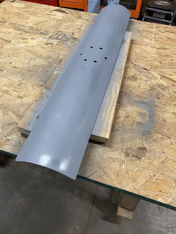

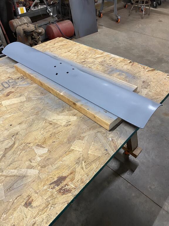

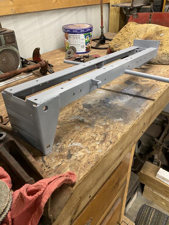

Tonytoro416 1,393 #43 Posted January 15, 2023 (edited) Been tearing apart the donor tractor so been a little slow as far as showing progress. ready to start cleaning up parts and start putting it back together Also spent some time sanding and priming a mid mount grader blade I scored on here last week Edited January 15, 2023 by Tonytoro416 2 3 Share this post Link to post Share on other sites
Pullstart 71,482 #44 Posted January 16, 2023 @Tonytoro416 was that the grader in Kalamazoo? Shoulda come up for a visit if you were that close! 1 1 Share this post Link to post Share on other sites
Tonytoro416 1,393 #45 Posted January 16, 2023 It was and I thought of that I really did but I just haven’t had the time. Starting to fill up with fertilizer at work in preparation for spring so haven’t been able to break away 1 Share this post Link to post Share on other sites
Tonytoro416 1,393 #46 Posted January 16, 2023 He shipped me the grader thankfully or I definitely would have made it your way 1 Share this post Link to post Share on other sites
