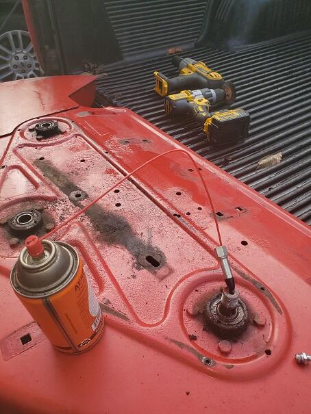

GAJoe 852 #1 Posted January 2, 2023 (edited) FYI Just in case someone else has a deck spindle with the components "brown welded" as mine did. I'm force feeding Kroil using a rubber tip that came with my grease gun with an extra long red spray can tube that I saved from a SeaFoam treatment kit. I removed the zerk grease fitting and cleaned out the grease in the shaft with Q-Tips. I put the tip to the zerk hole and the Kroil came bublin' up around the shaft. Edited January 2, 2023 by GAJoe 4 6 Share this post Link to post Share on other sites
GAJoe 852 #2 Posted January 2, 2023 (edited) And it worked like a charm All three pullies off and shafts out in a morning! Edited January 2, 2023 by GAJoe 4 3 Share this post Link to post Share on other sites

davem1111 2,396 #8 Posted January 4, 2023 On 1/2/2023 at 12:14 PM, GAJoe said: And it worked like a charm All three pullies off and shafts out in a morning! I've got a couple of old decks I need to try that on. Is Kroil a lot better than PB Blaster? Pretty sure they're both better than WD-40 for breaking down existing rust. I'd like to hear opinions on these products. Does one work better than another when also applying intense heat (MAPP, etc.)? 1 Share this post Link to post Share on other sites
GAJoe 852 #9 Posted January 4, 2023 7 minutes ago, davem1111 said: I've got a couple of old decks I need to try that on. Is Kroil a lot better than PB Blaster? Pretty sure they're both better than WD-40 for breaking down existing rust. I'd like to hear opinions on these products. Does one work better than another when also applying intense heat (MAPP, etc.)? I've used both Kroil and PB Blaster. I've had better results with Kroil. I still have a can of PB Blaster in the shop that I haven't picked up after using Kroil. 2 1 Share this post Link to post Share on other sites
GAJoe 852 #10 Posted January 4, 2023 (edited) 20 minutes ago, davem1111 said: I've got a couple of old decks I need to try that on. Is Kroil a lot better than PB Blaster? Pretty sure they're both better than WD-40 for breaking down existing rust. I'd like to hear opinions on these products. Does one work better than another when also applying intense heat (MAPP, etc.)? I gave the pulley hubs a couple good soakings and only one of the three resisted the Wonder Bar lift slightly, but did come off without a fight. Two of the shafts came out easily and I let the third soak a bit after the "force feed". I got as much of the grease out with Q-tips before doing the force feed. I knew that if the Kroil could get to the parts that the fight would be easier. Then I happened to think that the grease channels provided the Kroil a path to those parts. I just had to devise a method to get the Kroil through the grease channels. If the grease has gotten old and hard it probably wouldn't move out of the way. Edited January 4, 2023 by GAJoe 2 Share this post Link to post Share on other sites
