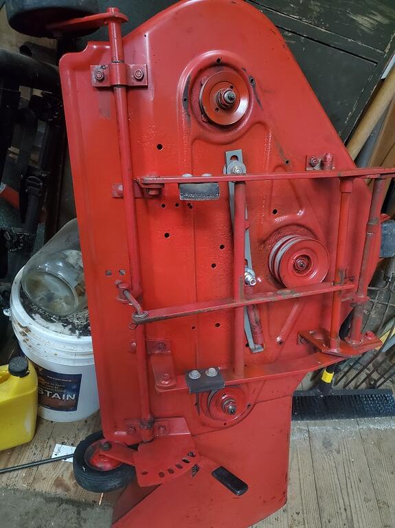

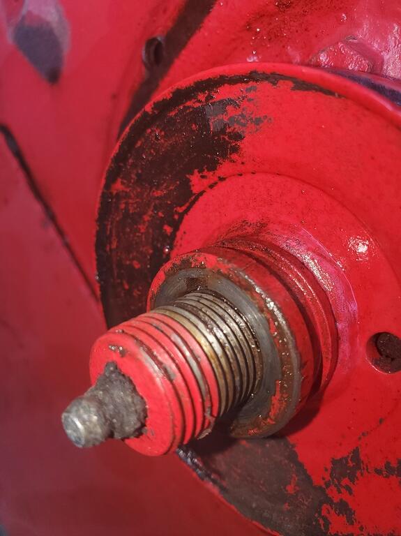

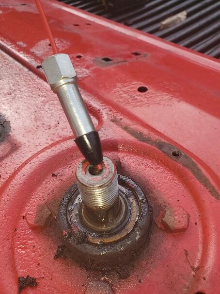

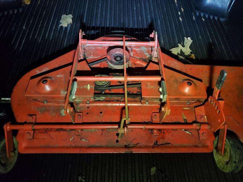

GAJoe 852 #1 Posted January 2, 2023 (edited) I have a few questions on this 36" deck that I bought that was said to come from a B-80. The tag was painted over and I was unable to get the paint off and preserve the #'s. I got the large 1 & 1/16" nylon lock nuts off of the spindles but I can't tell if the spool piece underneath is also threaded. It seams to be attached to the pully and also it also looks to have a key-way. It can't turn to un-thread if there's a key in the shaft. There are holes in the pully as if a spanner wrench type tool is used to spin it on and off on the threads. Someone has used a pipe wrench on the spool piece in the past. How do I proceed? Try to lif it off of the shaft with the two "Wonder Bars" , one on each side (or is that a different version) or make a spanner wrench and spin it off counter clock-wise by the threads? When I get the pulley off of the top of the deck should the shaft with blade still attached fall out of the spindle housing if everything is freed up and not "brown welded"? If it should and things are "brown welded" and it doesn't come out easily should I try tapping it out using a brass rod on the top of the shaft? Is the snap ring accessible with the shaft in the housing? I'm guessing not. The wheels on each end of the deck have zerk grease fittings that seem to just fill the middle of the wheel with grease to lubricate the axle and hub bushing. See the void with grease? So does the grease just slowly leak out to lubricate the bushing? Is the proper procedure to pump grease until I see some escaping around the shaft? Edited January 2, 2023 by GAJoe 2 Share this post Link to post Share on other sites
daveoman1966 3,879 #2 Posted January 2, 2023 For the Left and Right spindle pulleys, rent a Power Steering Pulley Puller tool from AutoZone. There is a 'ridge' in the top of each pulley and the puller tool will grip that ridge to pull it off of the center shaft. The tool works like a 3-jaw puller...with it looks like this: Share this post Link to post Share on other sites
GAJoe 852 #3 Posted January 2, 2023 (edited) Remove the Zerk grease fitting and let the end pivot on that hole? I just watched a YouTube on the use of that tool and the end of the threaded shaft is too far from the groove for the "Clam shell" to reach the groove I think. Is there different length "clam shells" in the kits? Edited January 3, 2023 by GAJoe reduce burden on web site Share this post Link to post Share on other sites
daveoman1966 3,879 #4 Posted January 2, 2023 44 minutes ago, GAJoe said: Remove the Zerk grease fitting and let the end pivot on that hole? I just watched a YouTube on the use of that tool and the end of the threaded shaft is too far from the groove for the "Clam shell" to reach the groove I think. Is there different length "clam shells" in the kits? Of course, remove the grease zerk. Rent the tool / kit from Autozone...it'll work. Return the tool undamaged and you'll get the rent back. 3 Share this post Link to post Share on other sites
GAJoe 852 #5 Posted January 2, 2023 (edited) When I get the pulley off of the top of the deck should the shaft with blade still attached fall out of the spindle housing if everything is freed up and not "brown welded"? If it should and things are "brown welded" and it doesn't come out easily should I try tapping it out using a brass rod on the top of the shaft? Is the snap ring accessible with the shaft in the housing? I'm guessing not. Edited January 2, 2023 by GAJoe change question 1 Share this post Link to post Share on other sites

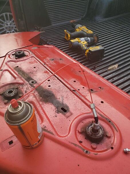

peter lena 9,471 #6 Posted January 2, 2023 @GAJoe this is my approach to deck rebuilding , most important LEVERAGE SPOT is spindle bolt s to deck , under pulley . use top of bolt as rocker / leverage point , wonder bar up against the center of the pulley , that strength area , on each side , with wonder bar , will move the pulley with ease . another vital part is the hi temp 560 deg lucas grease in the regreasing of related bearings . regreased all deck bearings and mule drive bearings , same bearing. also regreased the PTO cone bearings . that lubrication makes those decks wun without effort , and no noise . my 3 decks are set up like this , no noise or failures , pete 1 1 Share this post Link to post Share on other sites
GAJoe 852 #7 Posted January 2, 2023 (edited) 1 hour ago, peter lena said: @GAJoe this is my approach to deck rebuilding , most important LEVERAGE SPOT is spindle bolt s to deck , under pulley . use top of bolt as rocker / leverage point , wonder bar up against the center of the pulley , that strength area , on each side , with wonder bar , will move the pulley with ease . another vital part is the hi temp 560 deg lucas grease in the regreasing of related bearings . regreased all deck bearings and mule drive bearings , same bearing. also regreased the PTO cone bearings . that lubrication makes those decks wun without effort , and no noise . my 3 decks are set up like this , no noise or failures , pete That took about two minutes using the Wonder bars (: . Easy as pie! Thanks Peter! Can you address my other questions? Should the shaft come out the bottom of the spindle once the belt pulley is off? Update: the center one did! (: A couple other questions in my opening. I would appreciate any insight. Edited January 2, 2023 by GAJoe 1 Share this post Link to post Share on other sites
peter lena 9,471 #8 Posted January 2, 2023 @GAJoe if the center one released the shaft the others might too , would not force , possible snap ring . would remove the spindle housing anyway , for clean up and bearing removal , my bearings are , 6203 ( 3/4 ) 2RSC3. those wide rubber side grease shields , are easily removed with a small putty knife , be careful , no damage , so they pop right back in . wipe out original grease , flush with carb cleaner , repack with lucas hi temp , green grease , marine grease , both are rated at 560 temp . also do your mule drive bearings , same bearing . and your pto drive cone bearings , inner needle bearing , wipe out , and very small amount of grease , so it does not sling to clutch face . this detail combo , really frees up that deck , for amazingly free , spin up , also did this , went after every sloppy area , pto lever related drive is smooth / solid / easy .also did a ground upgrade from same spot. let me know , pete , everything said is in use on my 3 horses , very reliable , it all works , pete 1 1 Share this post Link to post Share on other sites
GAJoe 852 #9 Posted January 2, 2023 (edited) 16 hours ago, peter lena said: @GAJoe if the center one released the shaft the others might too , would not force , possible snap ring . would remove the spindle housing anyway , for clean up and bearing removal , my bearings are , 6203 ( 3/4 ) 2RSC3. those wide rubber side grease shields , are easily removed with a small putty knife , be careful , no damage , so they pop right back in . wipe out original grease , flush with carb cleaner , repack with lucas hi temp , green grease , marine grease , both are rated at 560 temp . also do your mule drive bearings , same bearing . and your pto drive cone bearings , inner needle bearing , wipe out , and very small amount of grease , so it does not sling to clutch face . this detail combo , really frees up that deck , for amazingly free , spin up , also did this , went after every sloppy area , pto lever related drive is smooth / solid / easy .also did a ground upgrade from same spot. let me know , pete , everything said is in use on my 3 horses , very reliable , it all works , pete Yes another did come out after I removed the woodruff key but the last is putting up a fight. So I'm force feeding Kroil using a rubber tip that came with my grease gun with an extra long red spray can tube that I saved from a SeaFoam treatment kit. I removed the zerk grease fitting and cleaned out the grease in the shaft with Q-Tips. I put the tip to the zerk hole and the rust colored Kroil came bublin' up. Edited January 3, 2023 by GAJoe 4 1 Share this post Link to post Share on other sites
GAJoe 852 #10 Posted January 2, 2023 And It worked great! Three pullies off and shafts out in a morning. 1 1 Share this post Link to post Share on other sites
GAJoe 852 #11 Posted January 3, 2023 I got the bearings and seals out today also. One thing that I learned is that the top bearing and seal have to come out of the top of the housing and the rest out of the bottom after removing the snap rings. As I found in a post the spacer between the bearings can be shifted to the side so that a punch can be used to tap the bearings out slowly and evenly tapping opposite sides. Hope this helps someone else. 1 2 Share this post Link to post Share on other sites

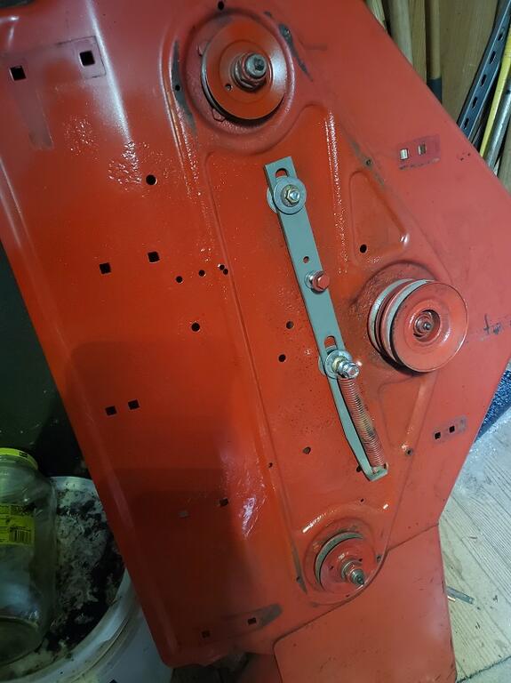

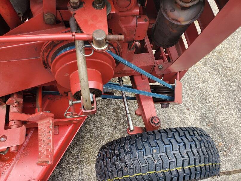

peter lena 9,471 #14 Posted January 3, 2023 @GAJoe note last side picture, of mower deck , notice the flat / back side idler pulley in the picture ? slight deflection of deck pulley belt? install that on my decks , to eliminate belt bounce , 2 ft of unsupported belt is not a good design , anything I have done is to eliminate a problem , no failures , no whining noise . you understand , you use kroil , pete 1 1 Share this post Link to post Share on other sites

GAJoe 852 #18 Posted March 12, 2023 (edited) I forgot to update; I got the deck back together. The rain let up long enough that I had to see how the (bought separately and rebuilt) mower deck and new belt would fit. I'm waiting until after my first grass cutting to see how the belts do before putting the pully guards back on. I got the new belt threaded through the Mule with a little YouTube help. I gave it a spin and all is smooth and quiet. I'll be cutting grass next weekend. THANKS! to all of you that contributed to my success. Edited March 12, 2023 by GAJoe 1 4 Share this post Link to post Share on other sites

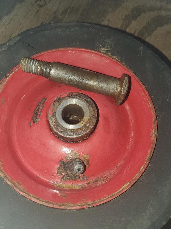

GAJoe 852 #22 Posted March 20, 2023 I found this idler pulley at Tractor supply Company to be the same outside diameter and width as the original. I just had to add a few washers and 5/8" x 3/8" spacer. Share this post Link to post Share on other sites
