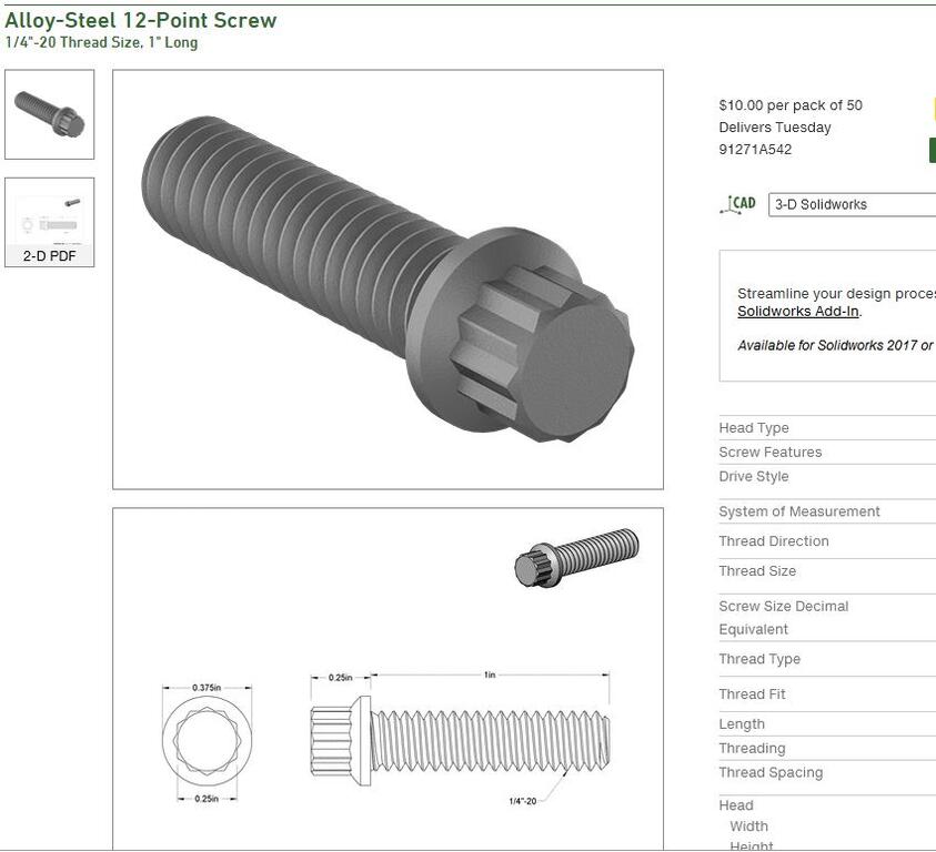

pfrederi 19,940 #12 Posted January 8, 2023 Interesting. My Sunnies are older (Charger/ Electros) at that time they were using 12 pt bolts. Since you are going to be replacing the O rings I guess a little heat won't hurt anything. 1 Share this post Link to post Share on other sites
Wheelhorse#1 1,901 #13 Posted January 8, 2023 (edited) @pfrederi I received the rings yesterday in the mail.Thanks again. They definitely need to be replaced. I looked on the part’s diagram and I’m not even seeing the bolts listed for the mounting bolt for the cam support block. Picked up another Torx bit today from TS. Removed the cam block and quickly discovered where most of the fluid was coming from. Looks like I have to hunt down a support block,I’ll post on the wanted ad.part #5993 Cam Block support. All in all not too difficult a job ,but definitely not sausage fingers friendly 😁👎 Edited January 8, 2023 by Wheelhorse#1 Share this post Link to post Share on other sites
pfrederi 19,940 #14 Posted January 8, 2023 (edited) Screw is a socket head 1/4" by 1/2" #911037 Check with A to Z Block is part# 5993 I have fat clumsy fingers i have to take the hydro off the tractor you did great!!! Edited January 8, 2023 by pfrederi 1 Share this post Link to post Share on other sites
